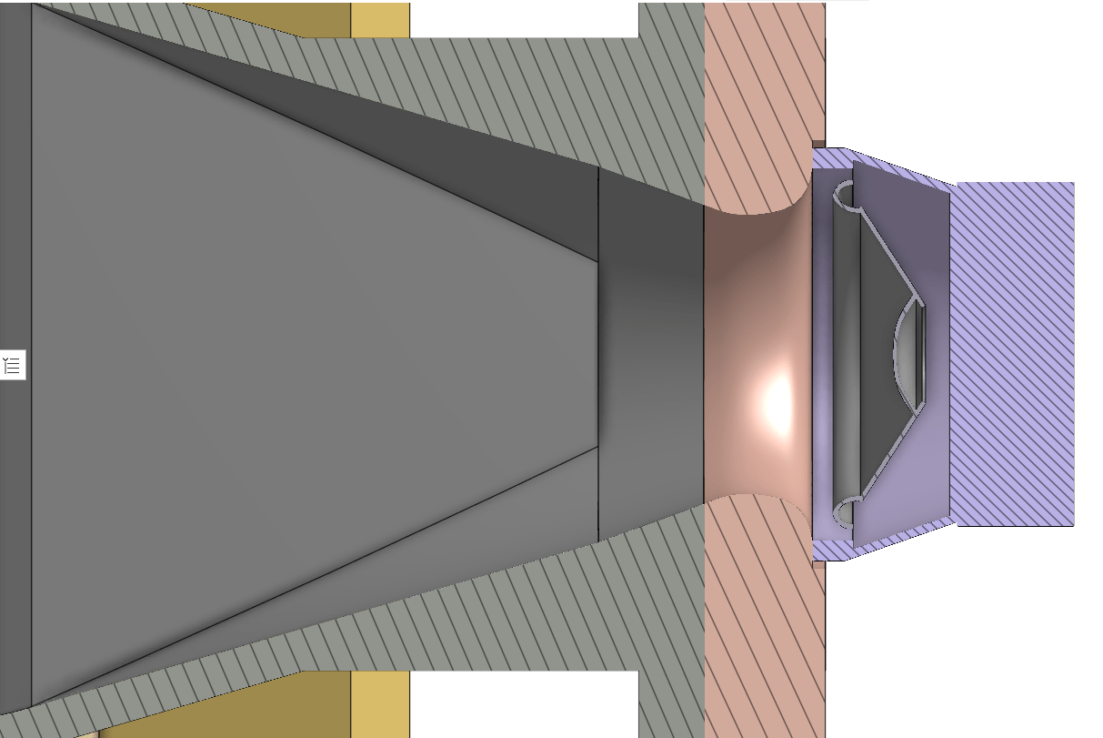

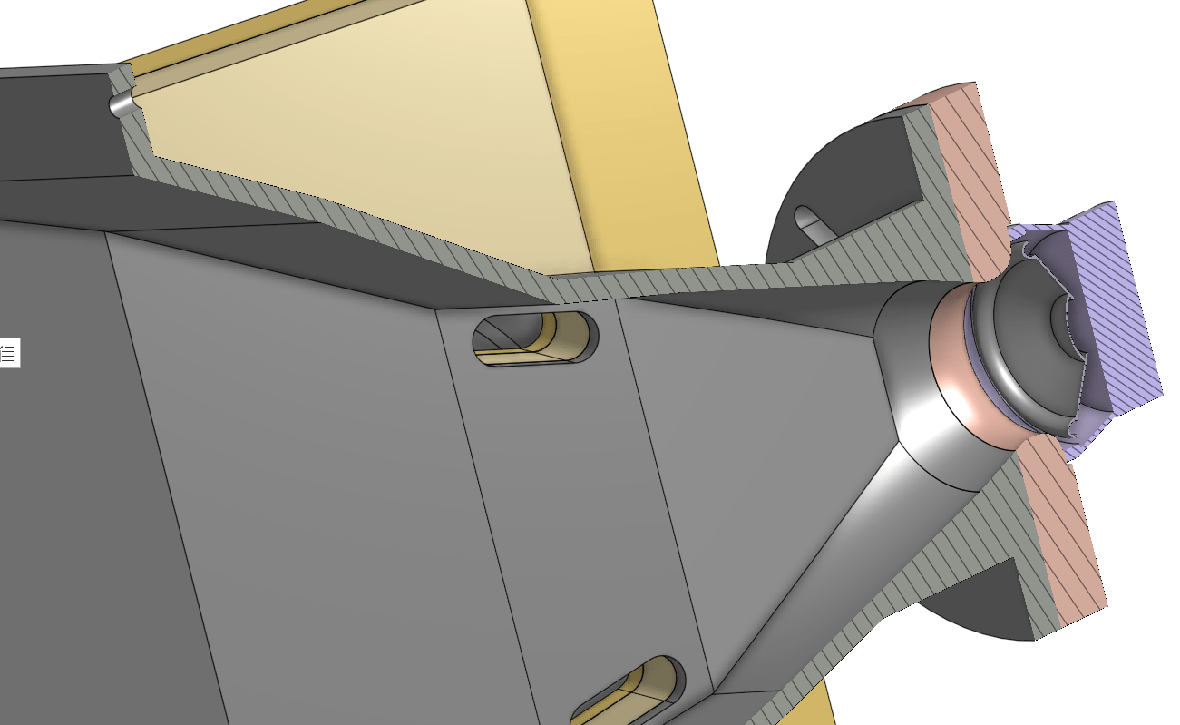

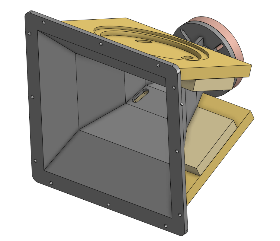

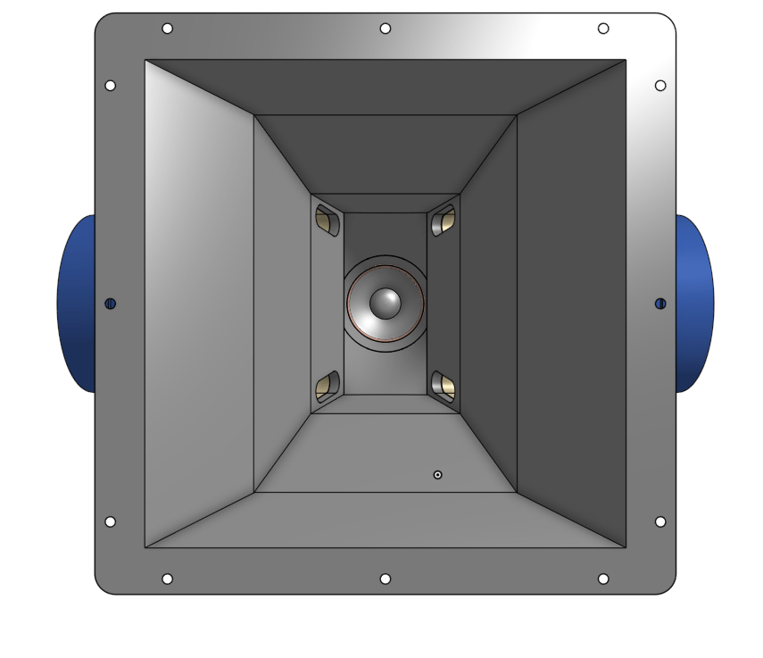

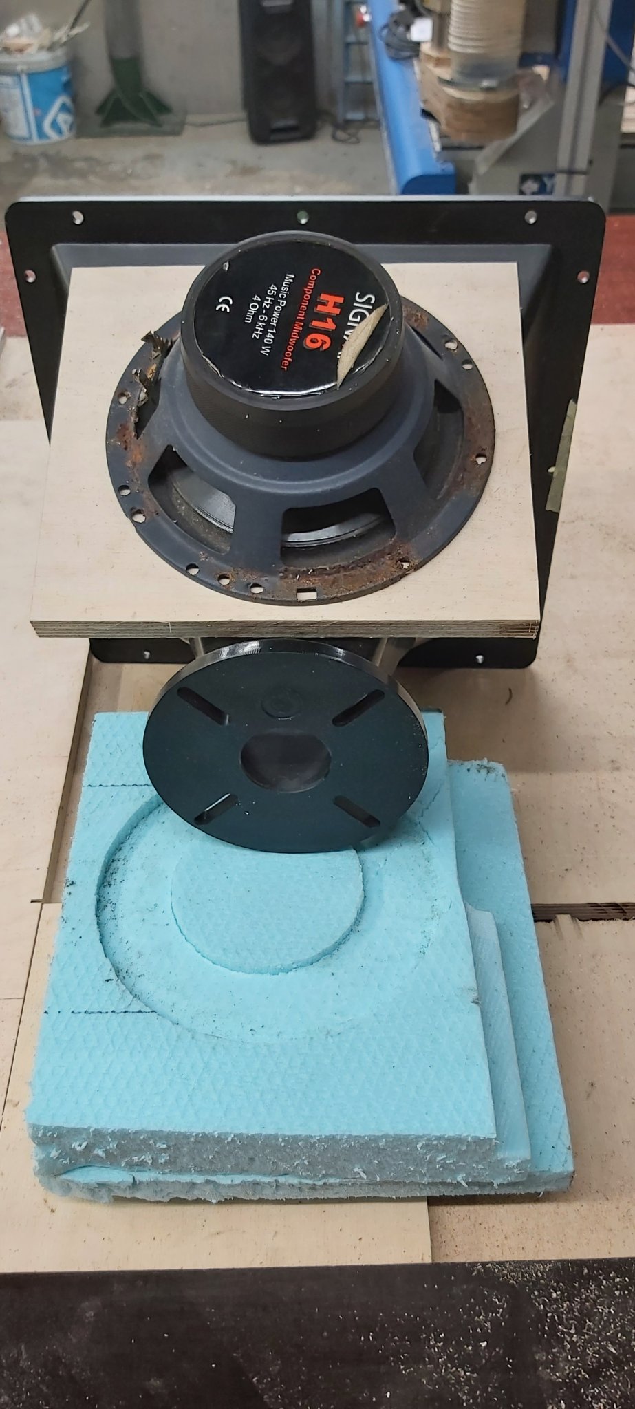

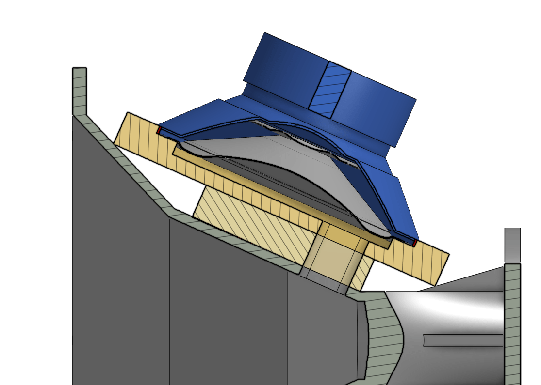

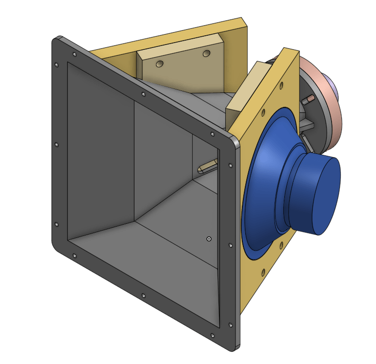

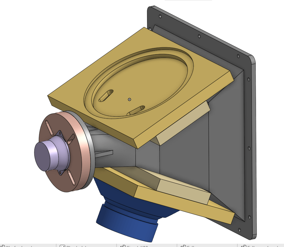

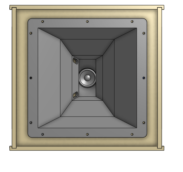

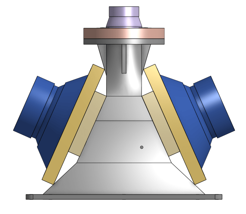

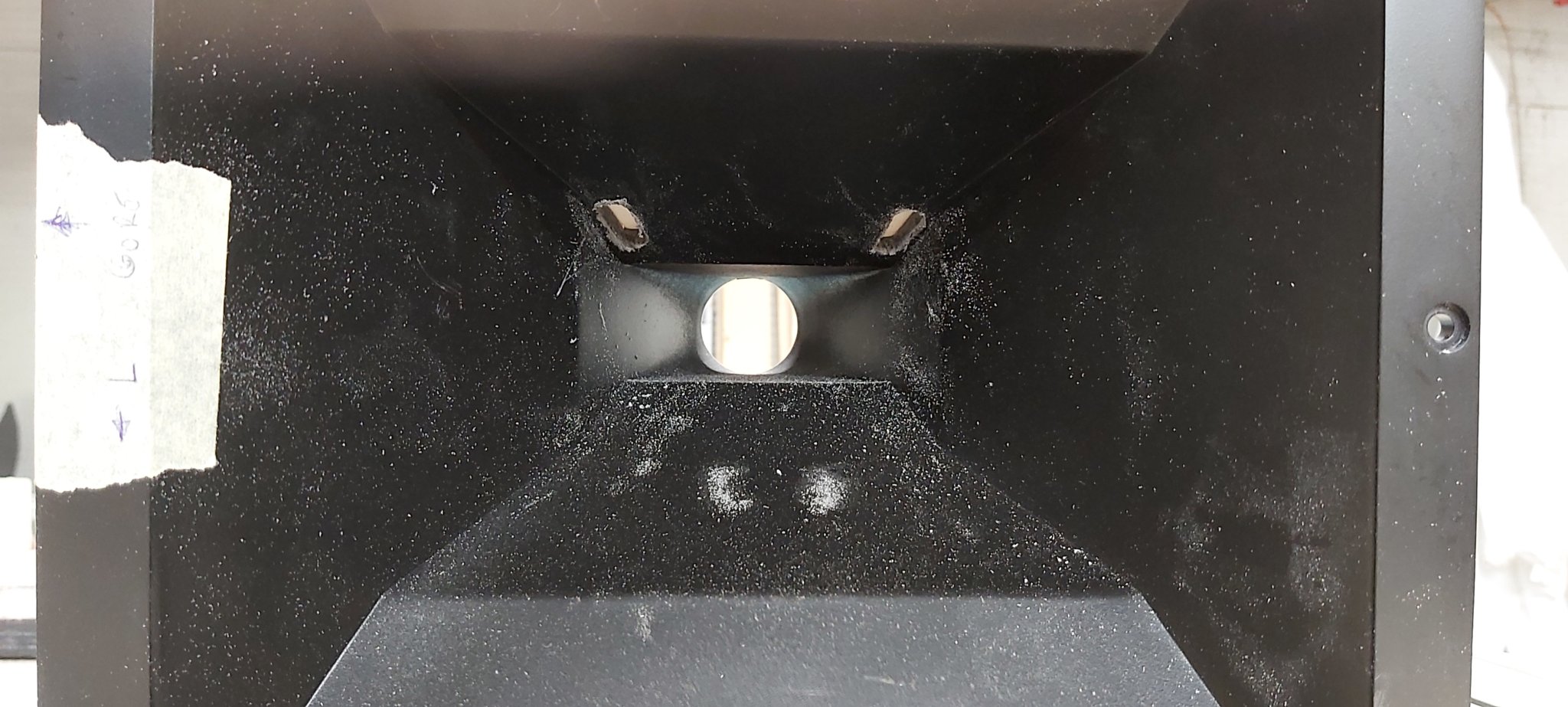

So, first job was to create 3D rendering of the H280 horn => I took some general dimensions from the "SB Acoustics" website drawings, and measured other features directly on physical horn.
Then, I've took my old car woofers (20-year old, "basement specials", poly cone, with little bit rusty frames, but still good rubber surrounds), and took their dimensions and created 3D model as well.
(NOTE: Unfortunately, I don't have T/S parameters for these drivers, but I was using them loooong time ago for my 2-way floorstanding speakers, and if I remember correctly run two of them in approx. 30L closed box, from 50Hz to approx. 3500Hz => I am guessing that Qts is around 0.6-0.7, resonant frequency is around 60Hz, and VAS could be around 14-15L cca.)

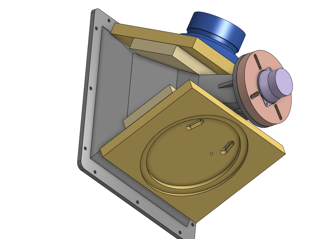

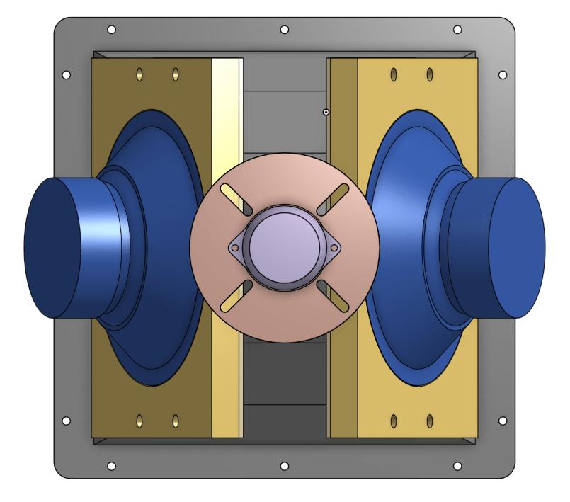

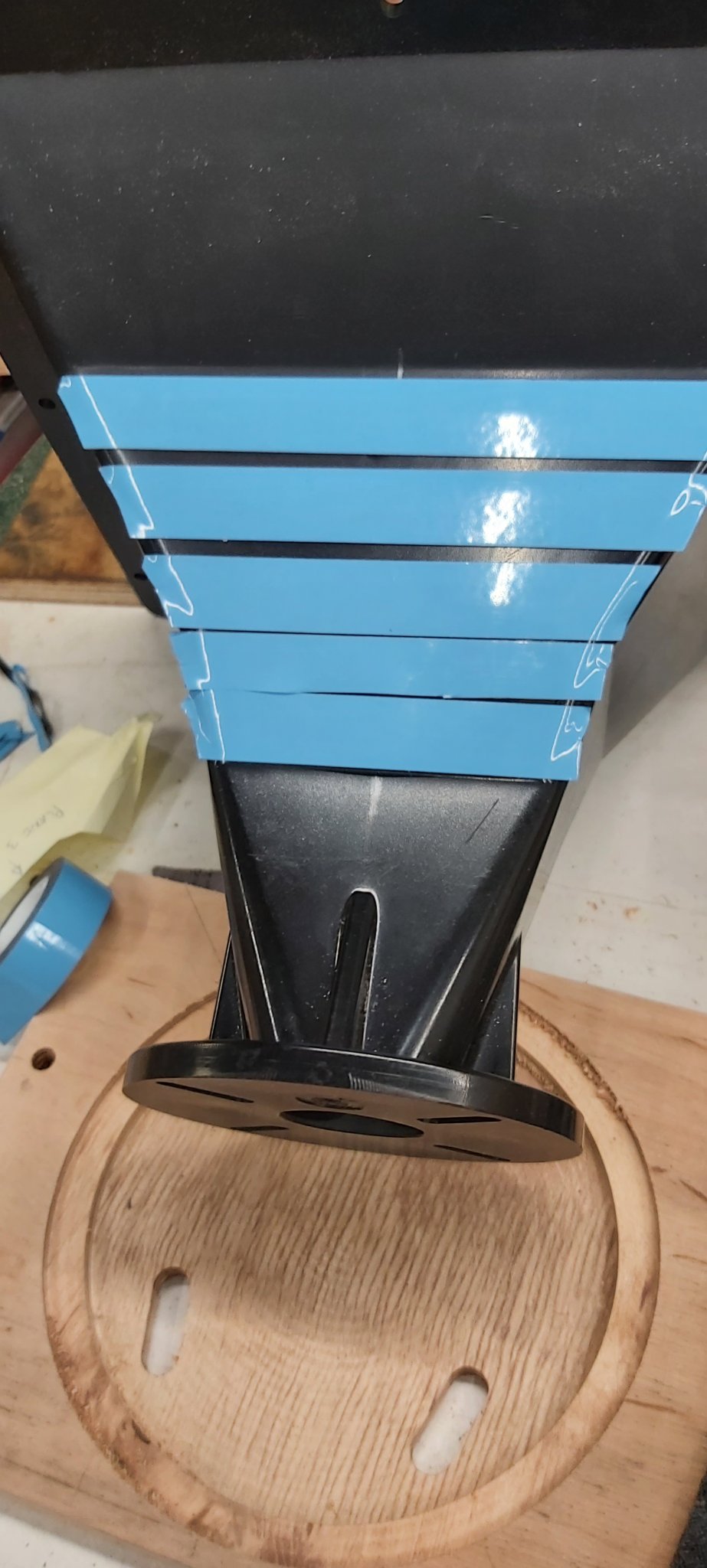

After making 3D model of the woofer I played with woofer position, taking into account all basic MEH rules:
a) To place woofer taps as close horn throat as possible,
b) To position woofer taps close to the corners of the horn,
c) To position woofer taps relatively close to woofer membrane center,
d) To make small, elongated slots for woofer taps, which I can enlarge if required,
e) To find position, for mounting woofer where woofer mounting plate will be easily glued/attached.

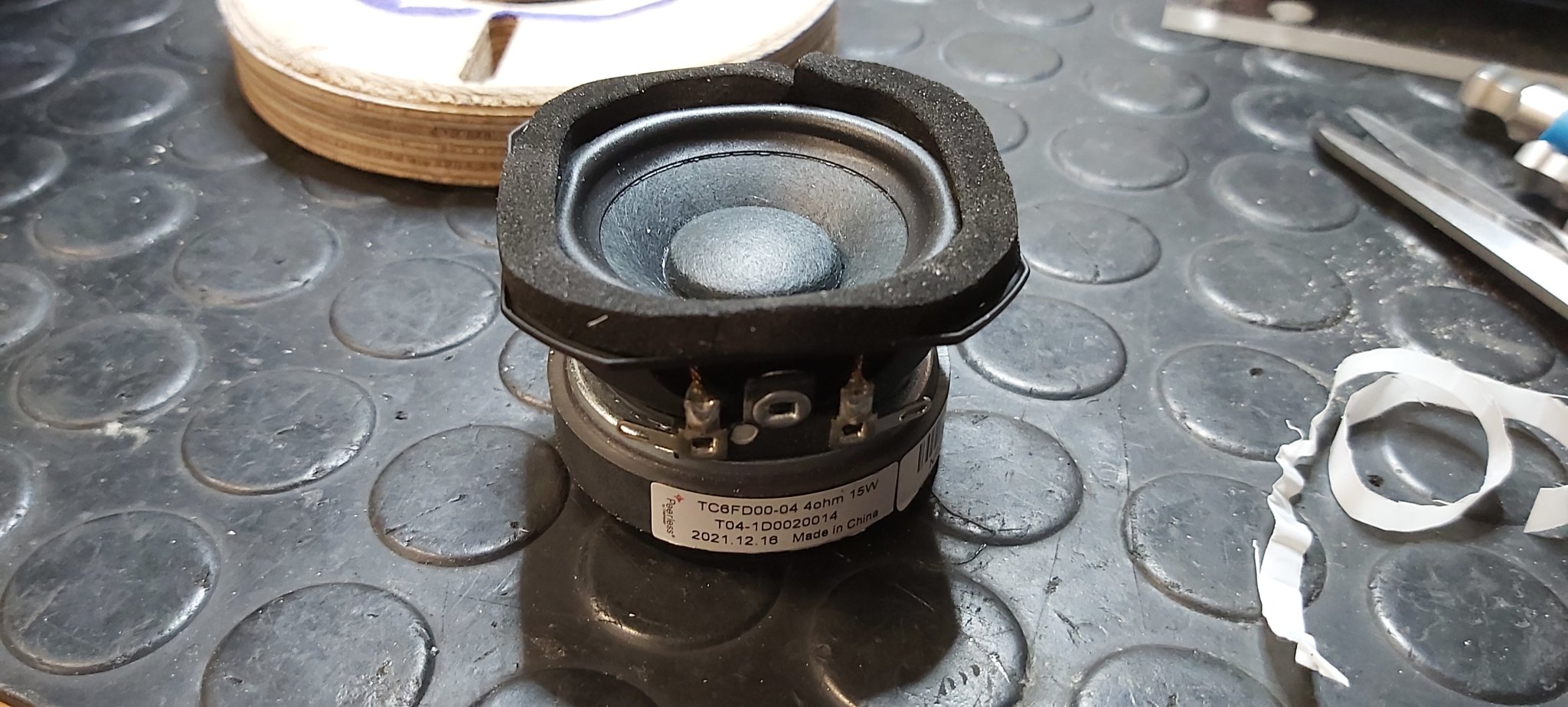

For fullrange driver, I didn't had any spare 2" or 2.5" drivers around, so I simply took one old PC speaker, took it apart, and took one driver from it => there are no marks on the driver, so I don't have any info about performance - but it is 2" diameter, which should enable simple mounting to horn throat , with simple throat adapter.
I've created model of this fullrange driver as well, plus mounting plate for this driver - and then combined all these 3D parts in one 3D assembly:

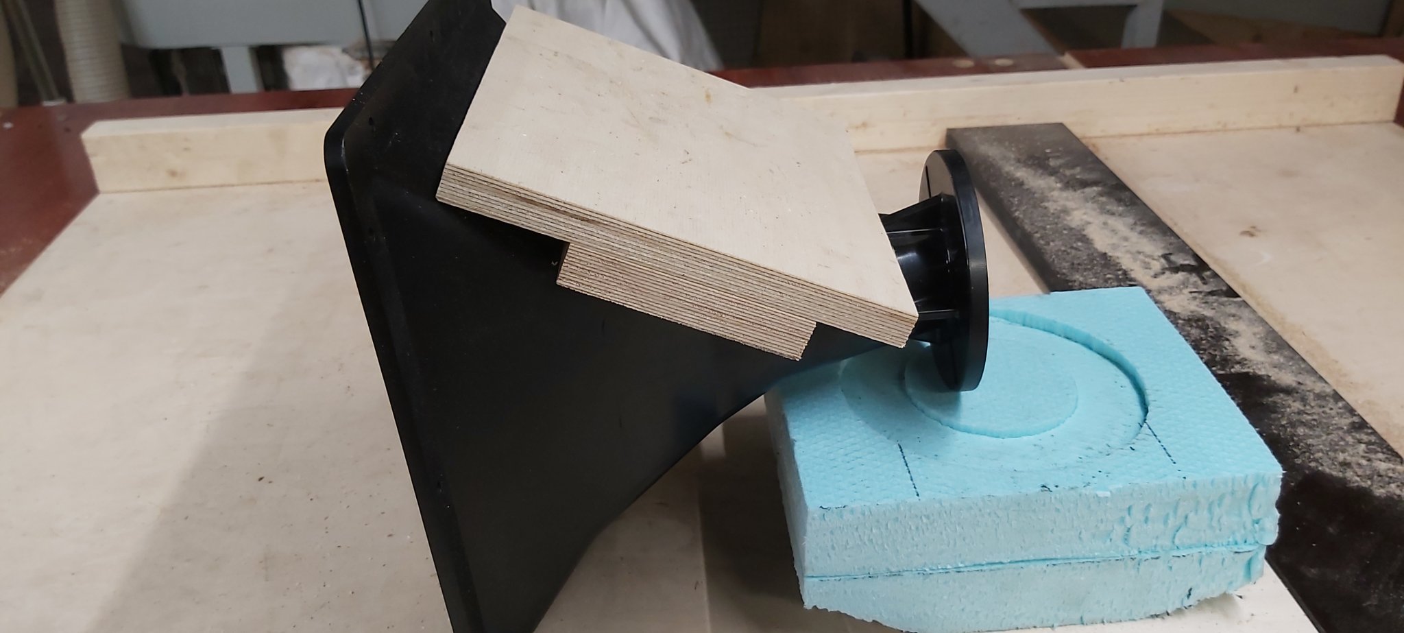

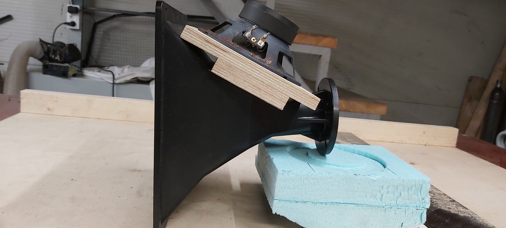

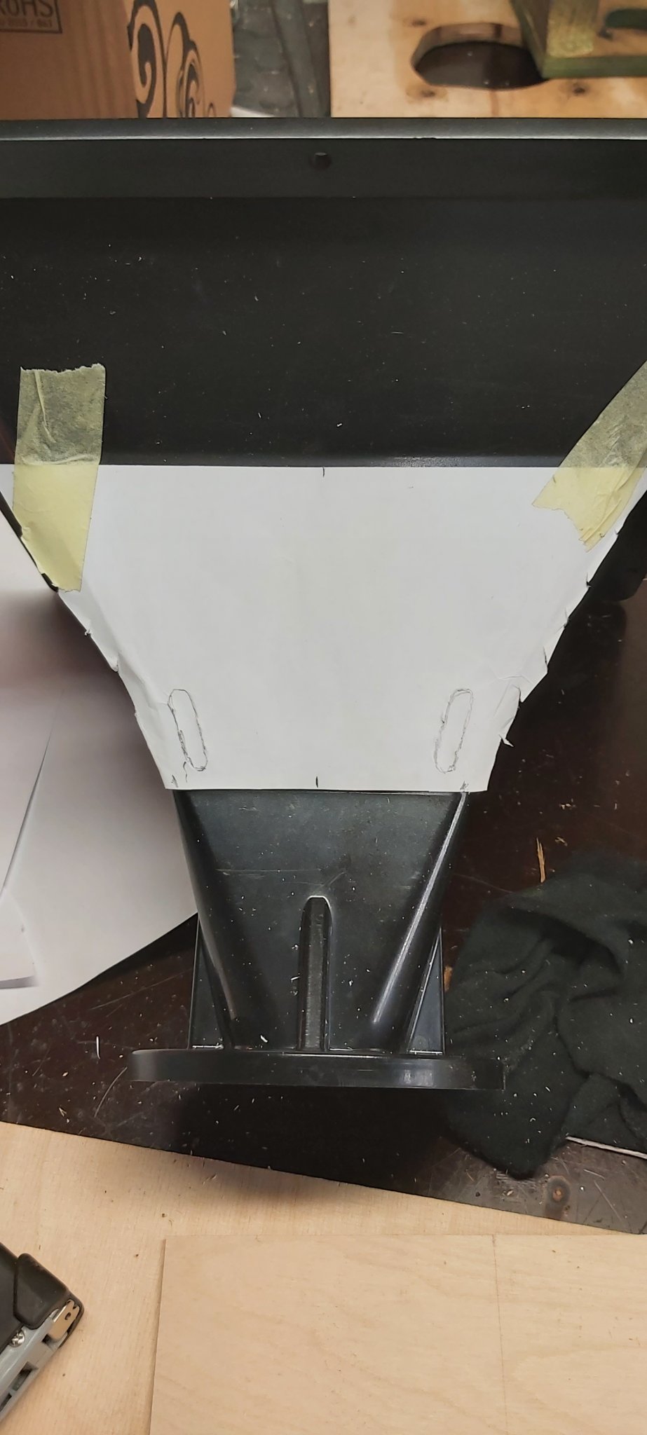

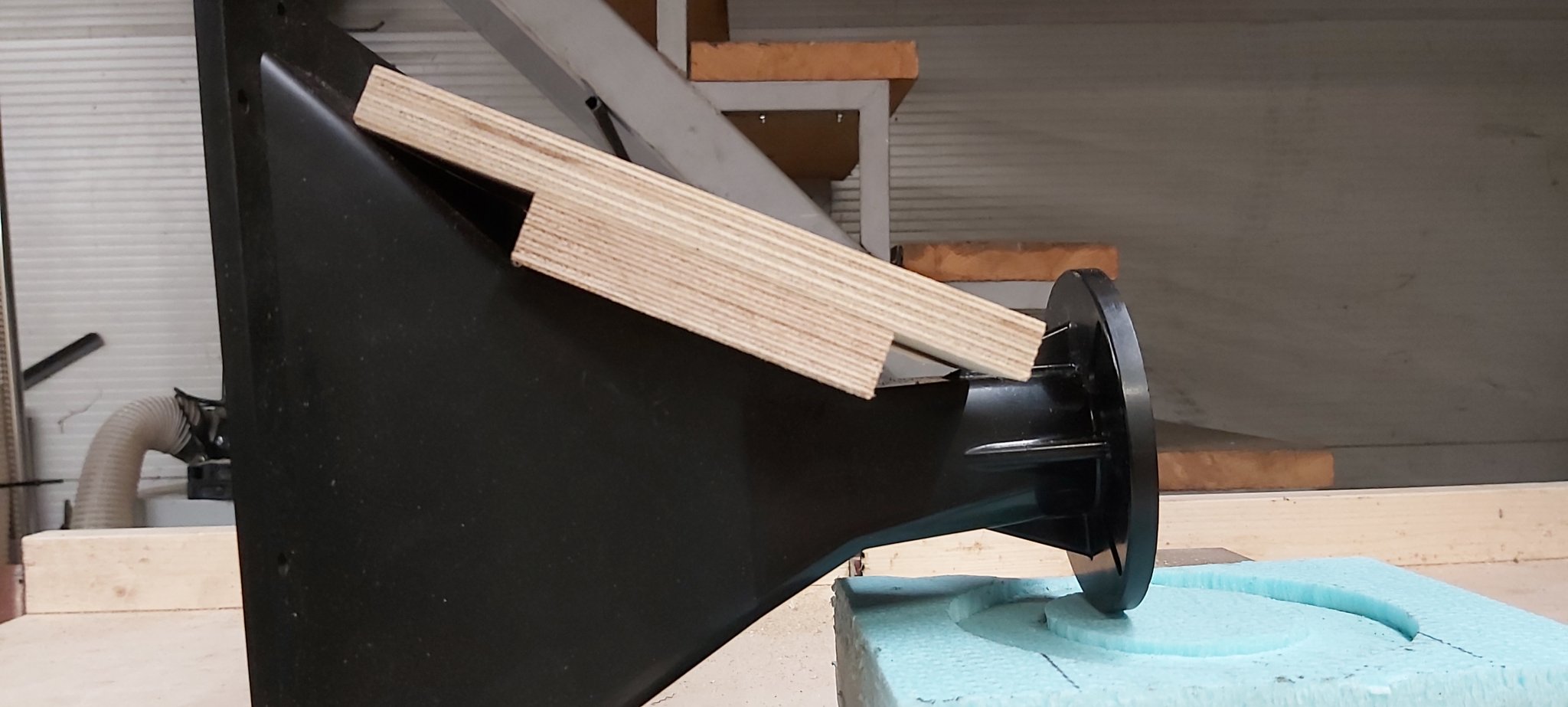

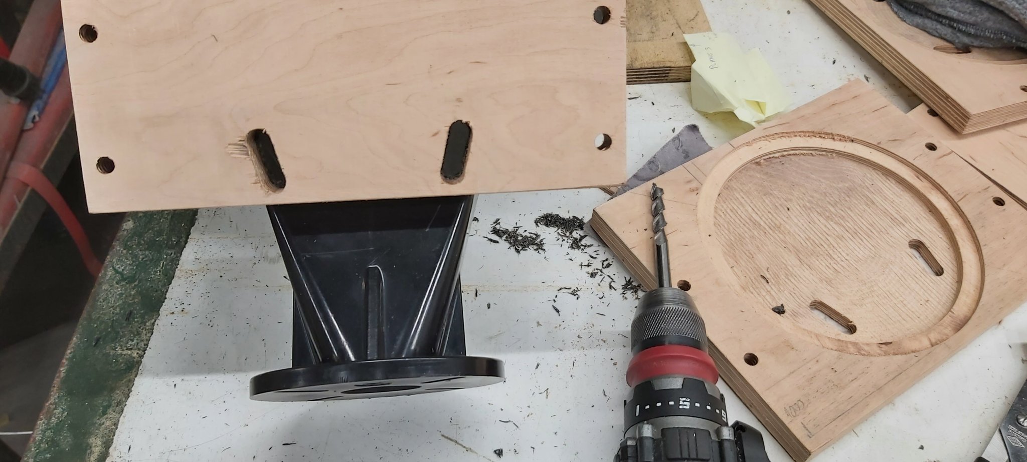

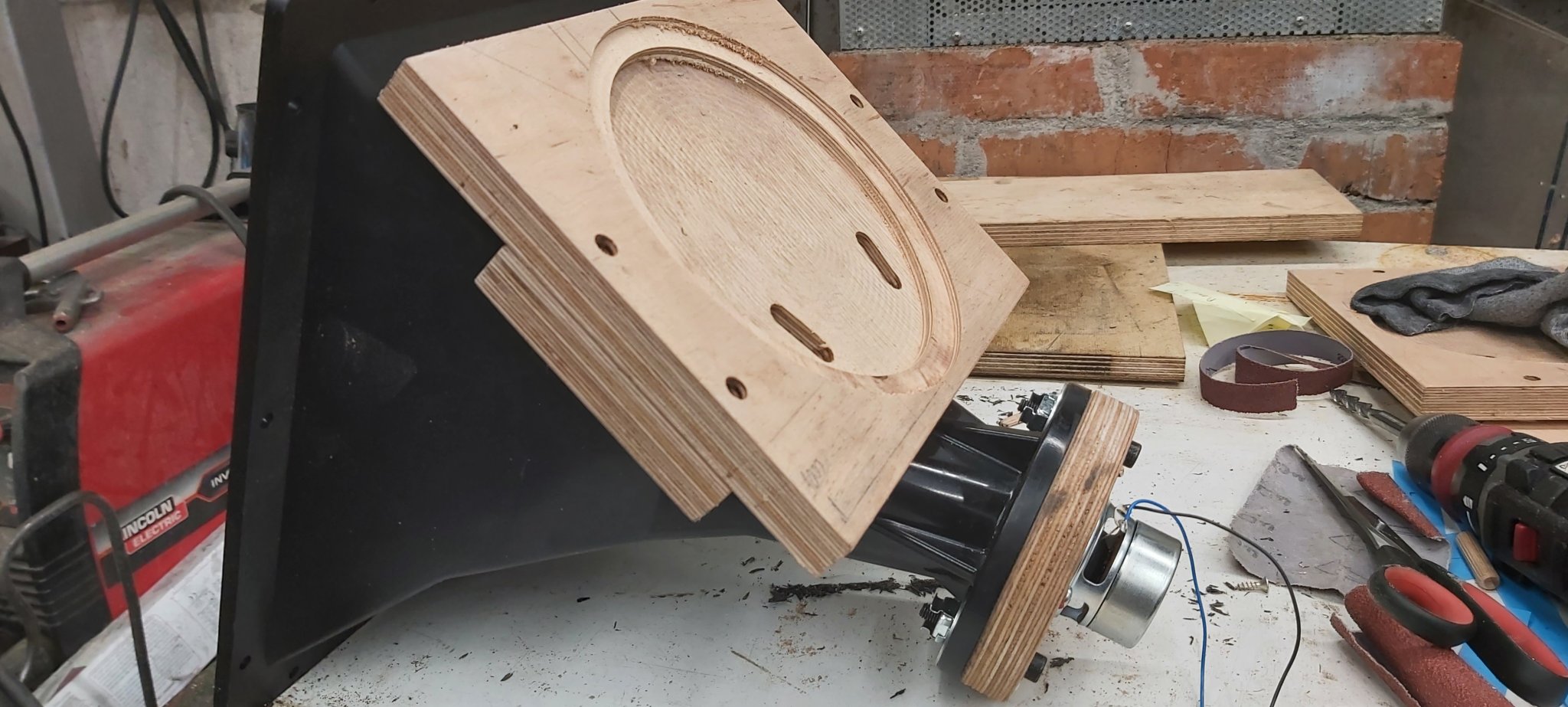

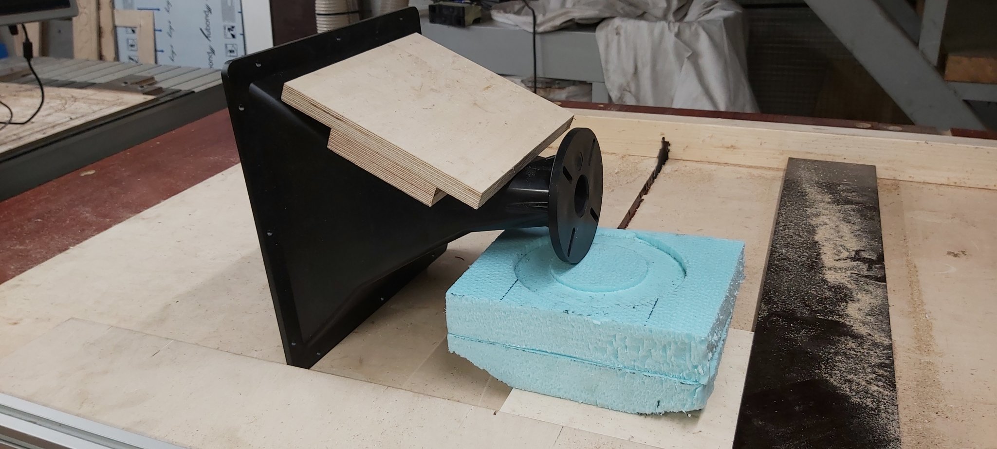

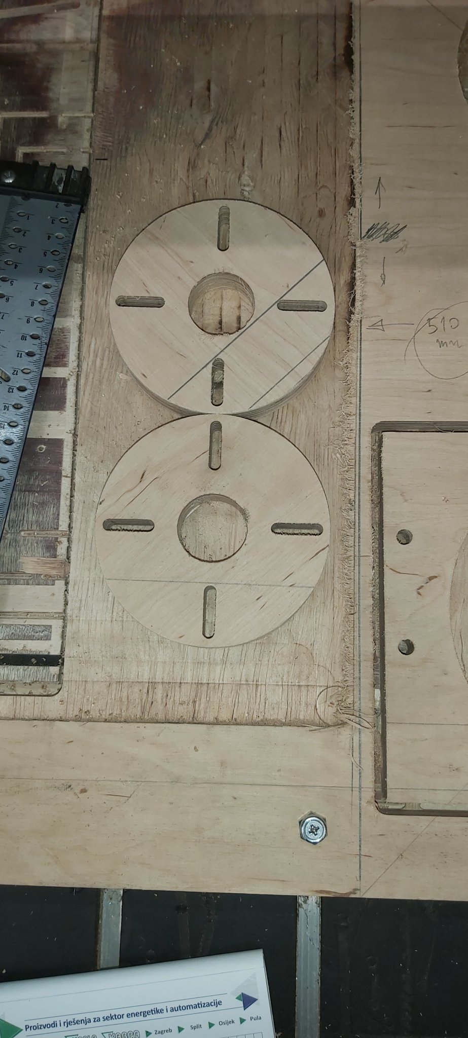

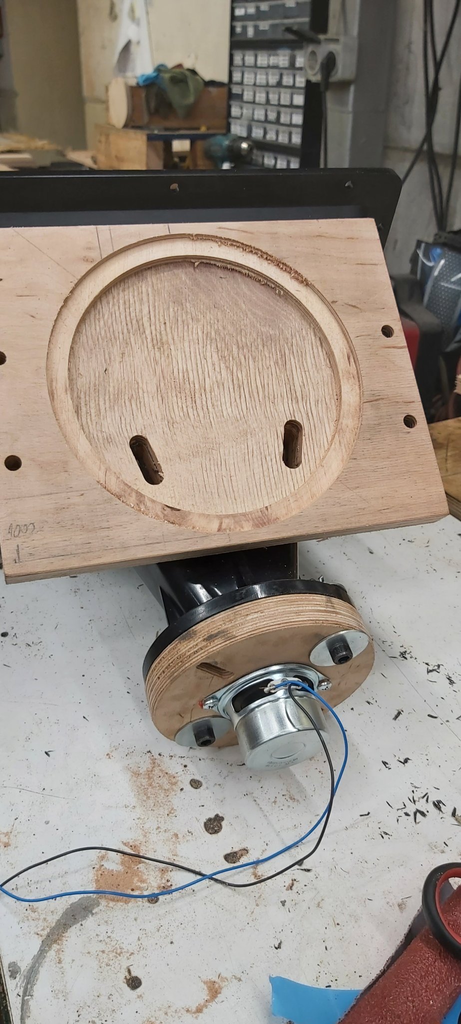

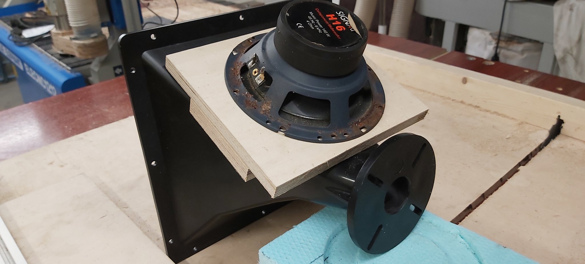

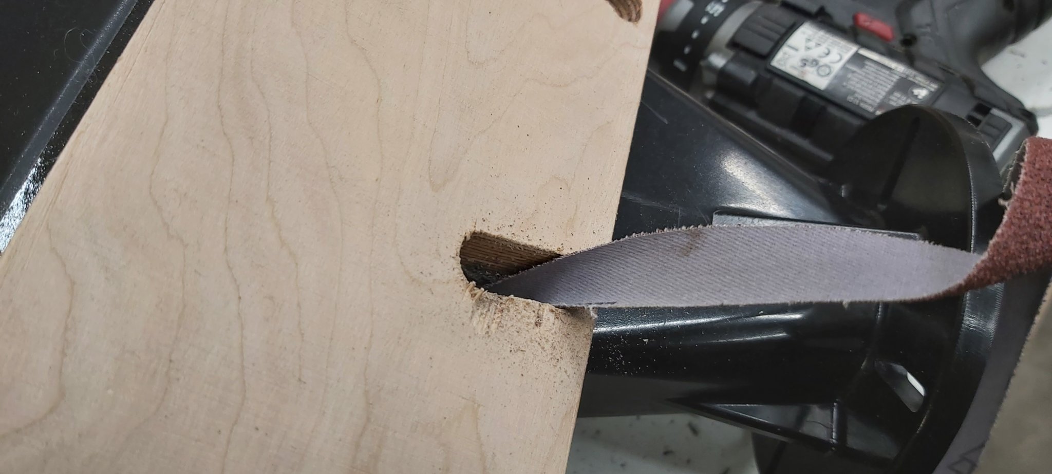

When all plywood board for woofer were cut down and temporarily glued to H280 horn, I carefully drilled elongated holes in plastic horn, by using plywood boards as guides.

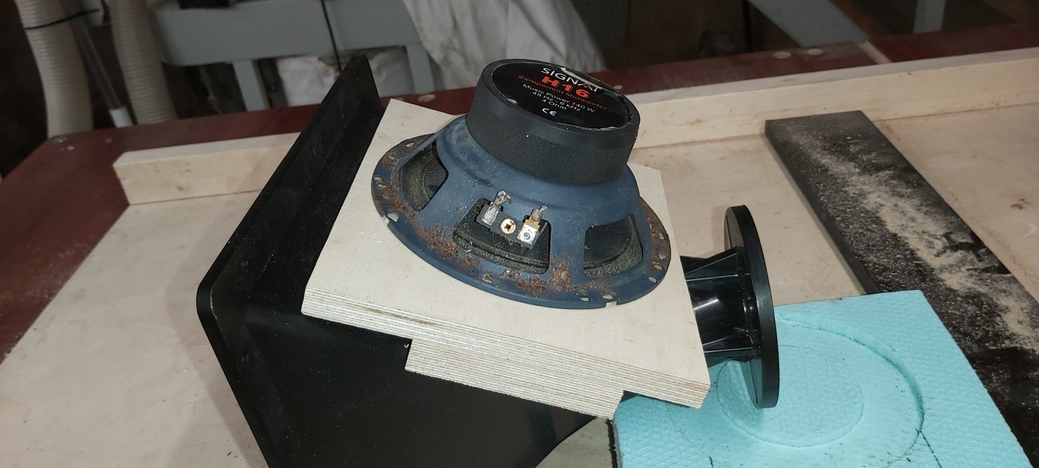

Then, all holes were sanded smooth, and foam gasket was added on both 6.5" woofers.
Woofers were then attached to both boards, and wires were soldered.

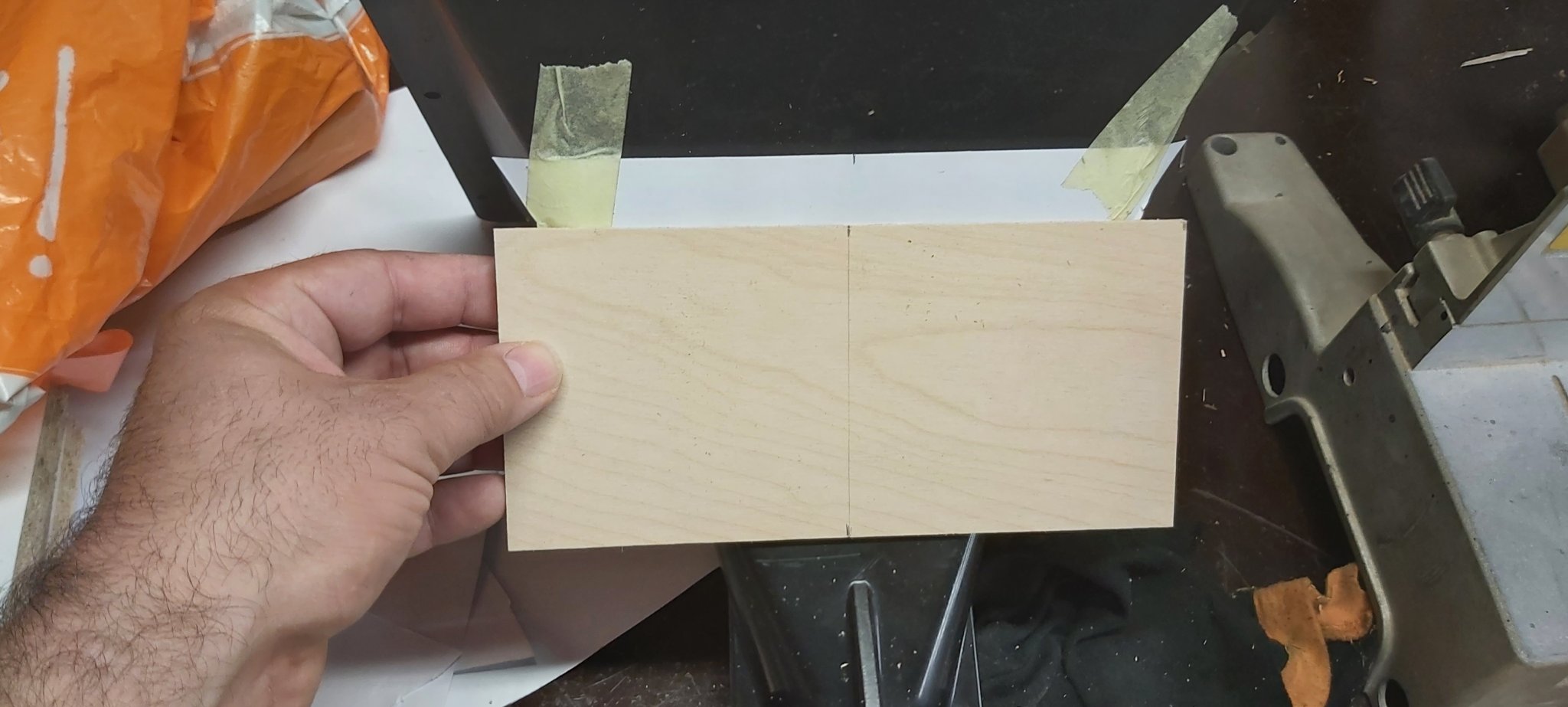

For the fullrange driver board, I also used 18mm birch plywood => as the membrane diameter of my "no-name" driver was around 46mm, and H280 throat was 35.5 mm (1.4"), I decided for this test to simply make conical plywood adapter, without additional compression volume immediately in front of the driver.
Plywood adapter with fullrange driver was then attached to horn, and wires were soldered to driver.

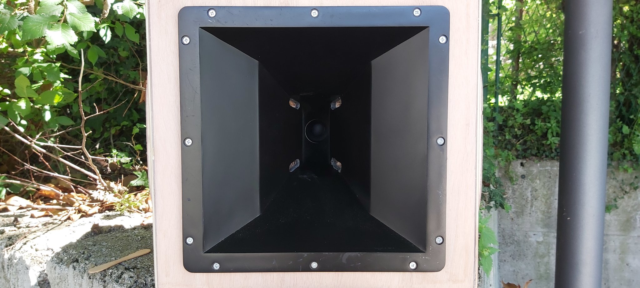

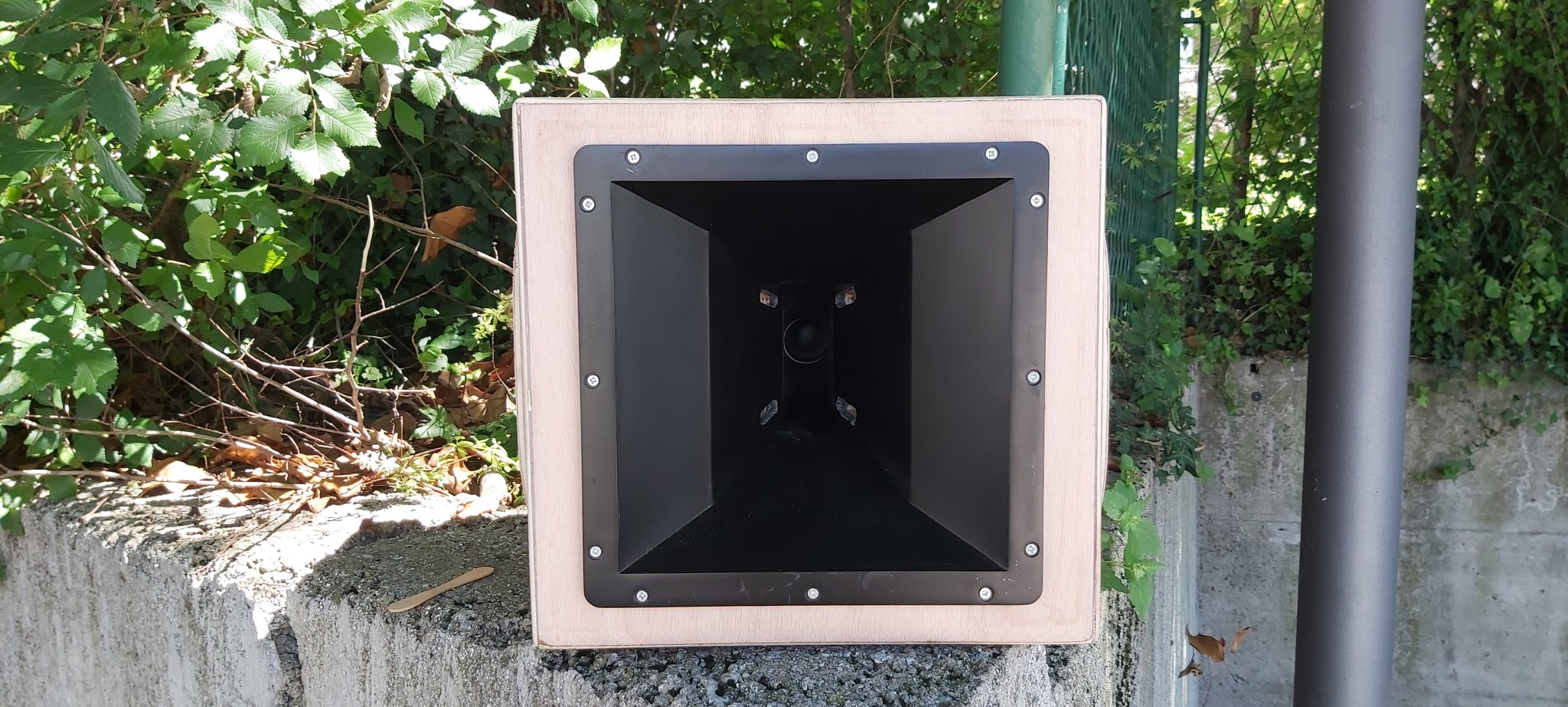

As probably most guys here, I was anxious to hear the whole assembly in free air, without any box => I must admit, I didn't knew what to expect as I was not doing any software simulations/calculations, as I was stubborn, and was trying to see how "forgiving" such MEH design is in real life, if you stick to essential rules.
But on my surprise, sound was quite pleasant even with my 20-years old, rusty woofers and "no-name" fullrange speaker - short video clip is here:
Hm, even with small amount of DSP correction, with randomly chosen drivers, without any box, this MEH sounds very clean and well defined => I would say that it sound much better that it should deserve, considering lack of proper calculations/ simulations.

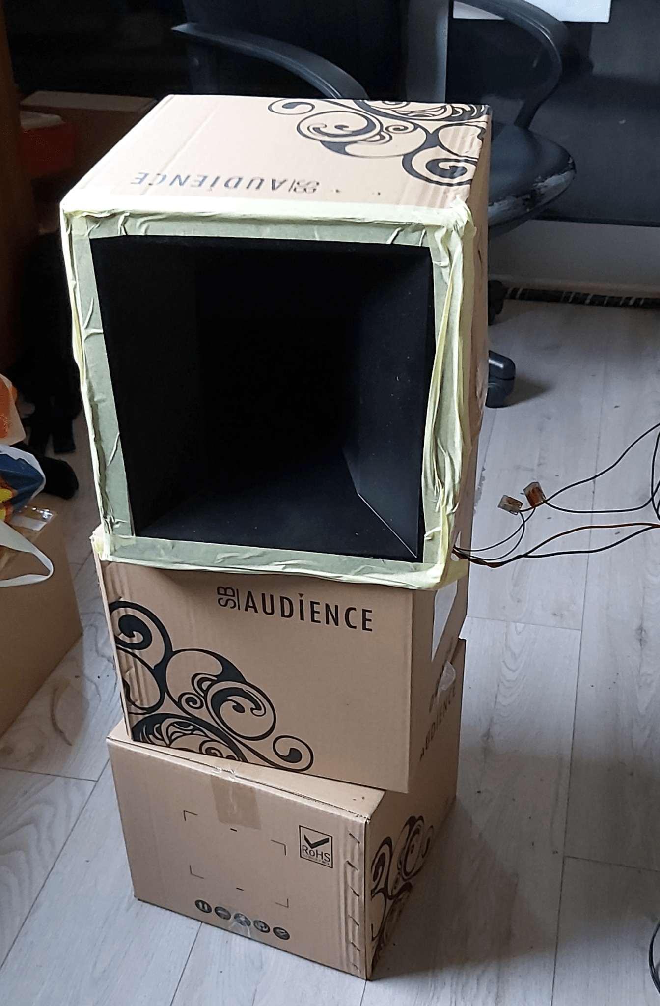

So, now I was obviously curious, how it would sound with some kind of box, any type of the box => the simplest box I could think of was actually standing right next to my leg => the cardboard box for the H280 horn 🙂
Therefore, by using some masking tape & sharp knife I quickly placed complete horn assembly into cardboard box => it was of course (too) tight fit, and undersized internal volume but for quick tests, who cares😎
Now, with horn placed in improvised cardboard box, I've gain some output in bass region, so I could easily reach 50Hz, or even a little bit lower, but of course this is still far from optimal as box volume is sub-optimal, lot of bass energy is absorbed in box itself, plus box is leaking somewhat.
The sound is still very good & balanced - especially the amount of details when you hear the box from the larger distance (5 to 10meters).

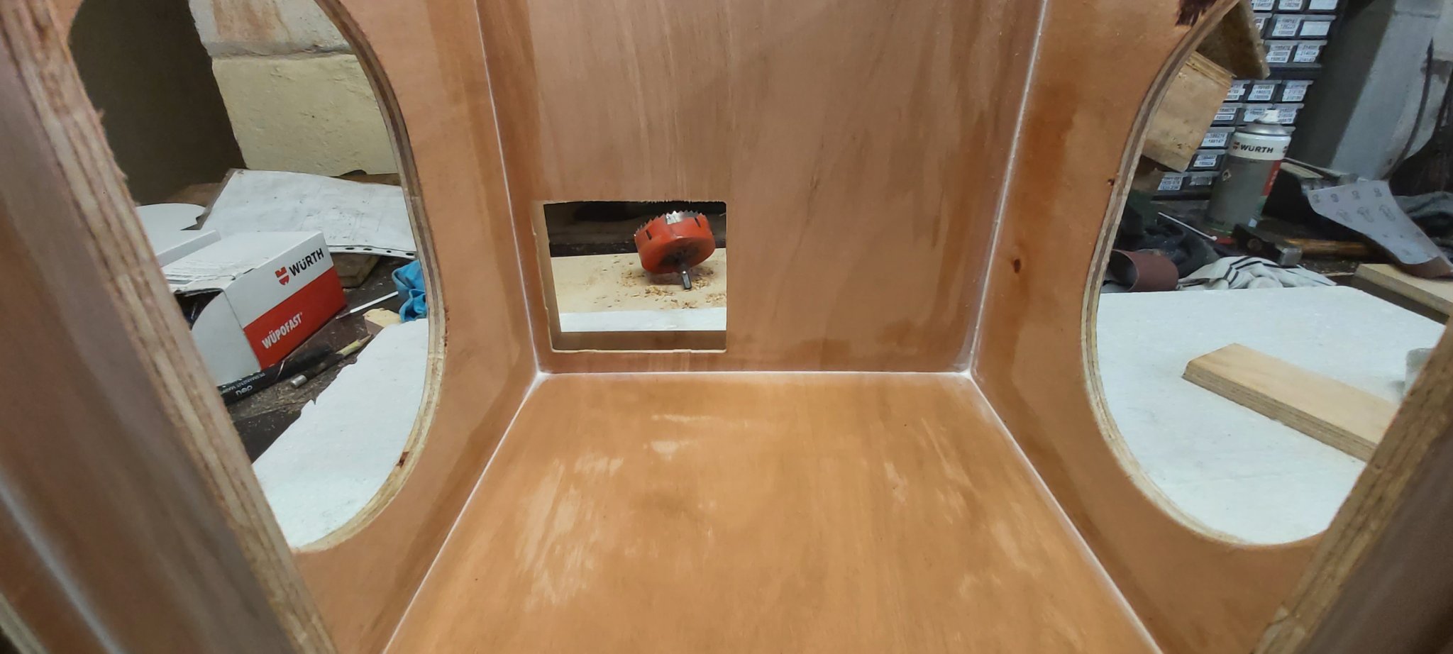

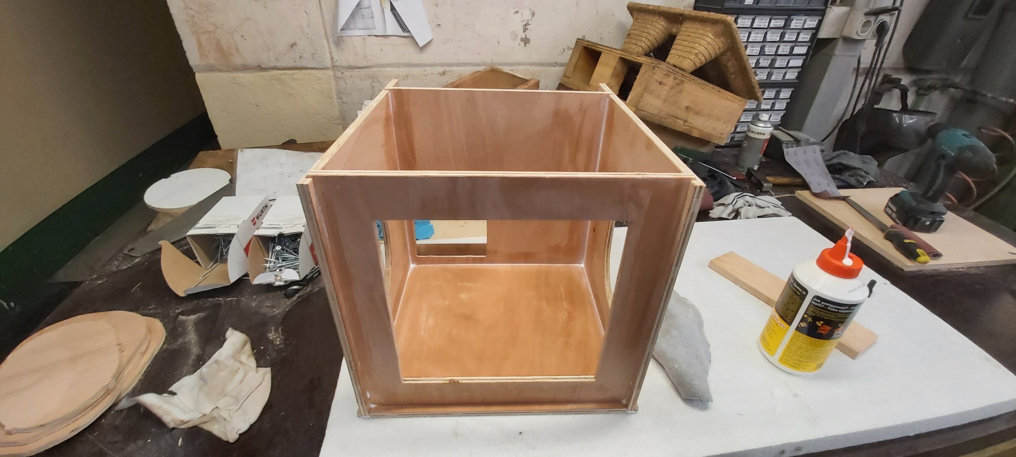

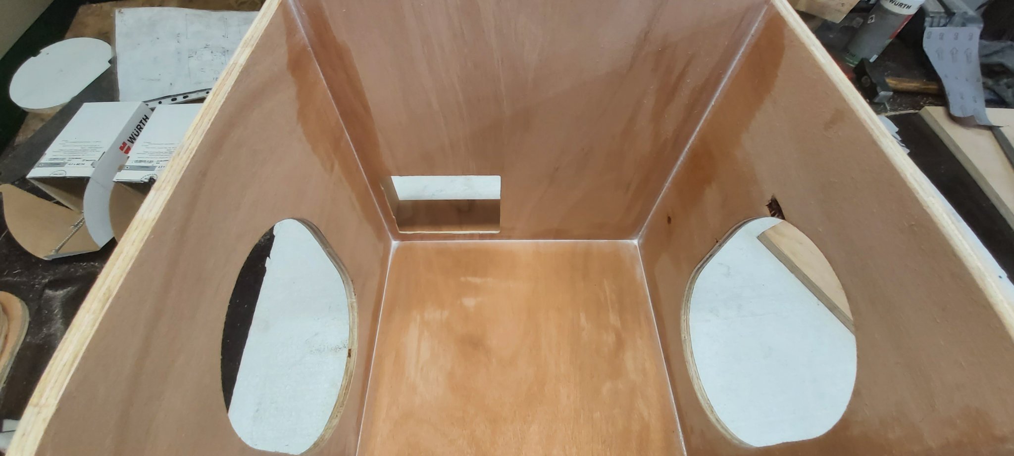

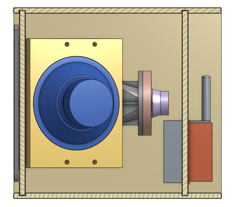

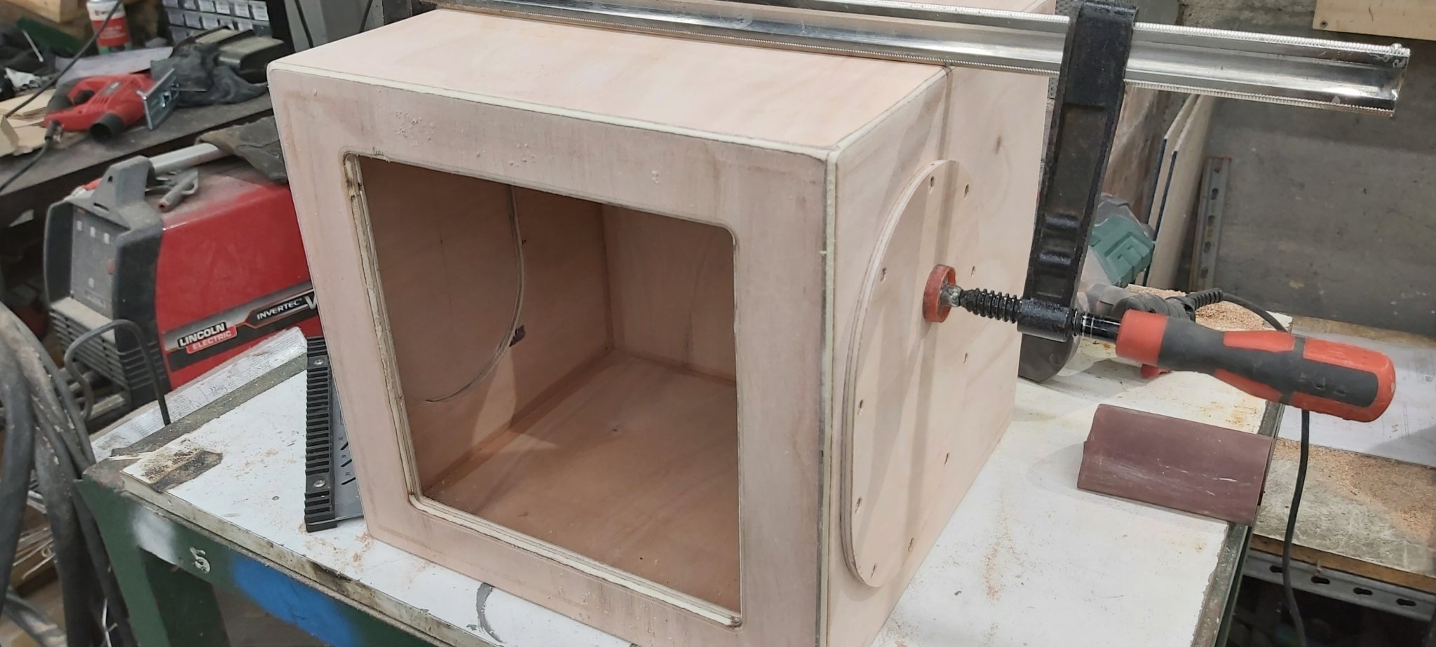

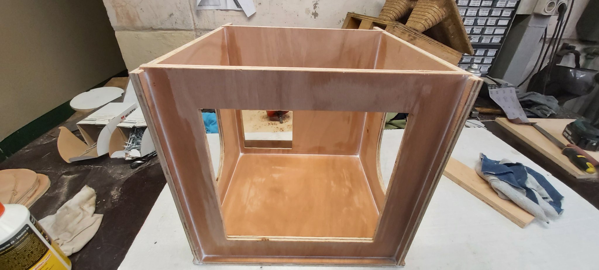

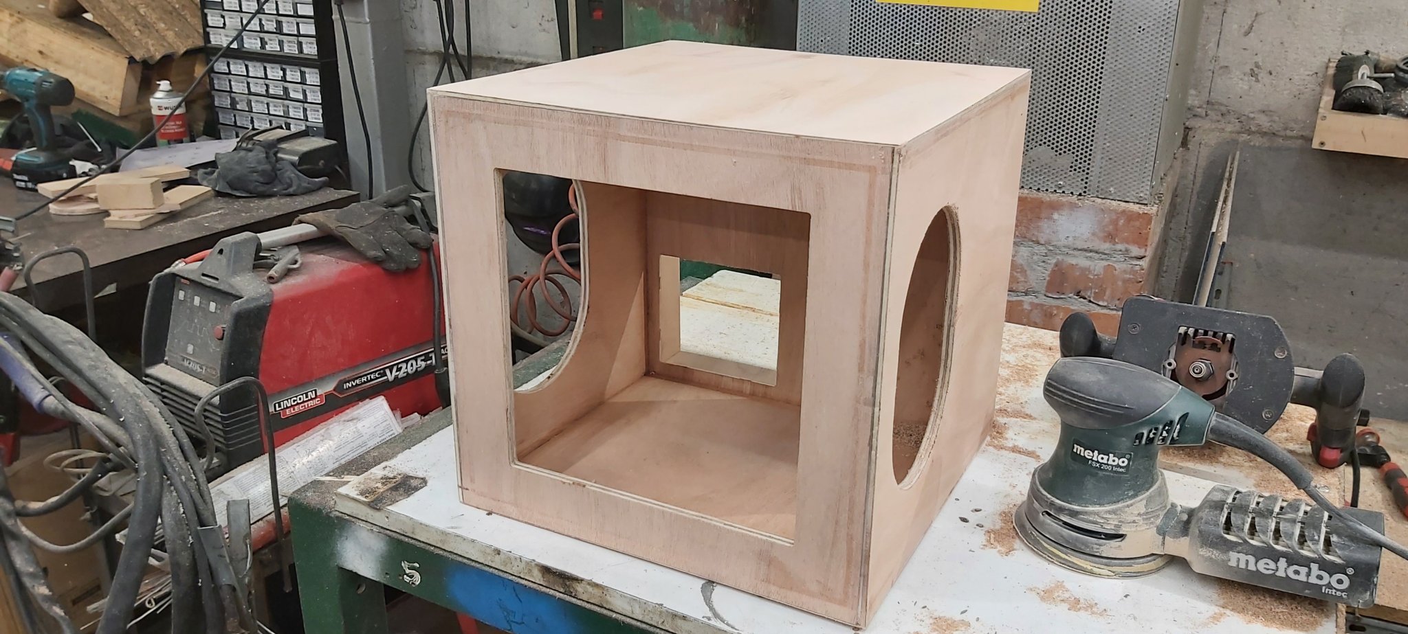

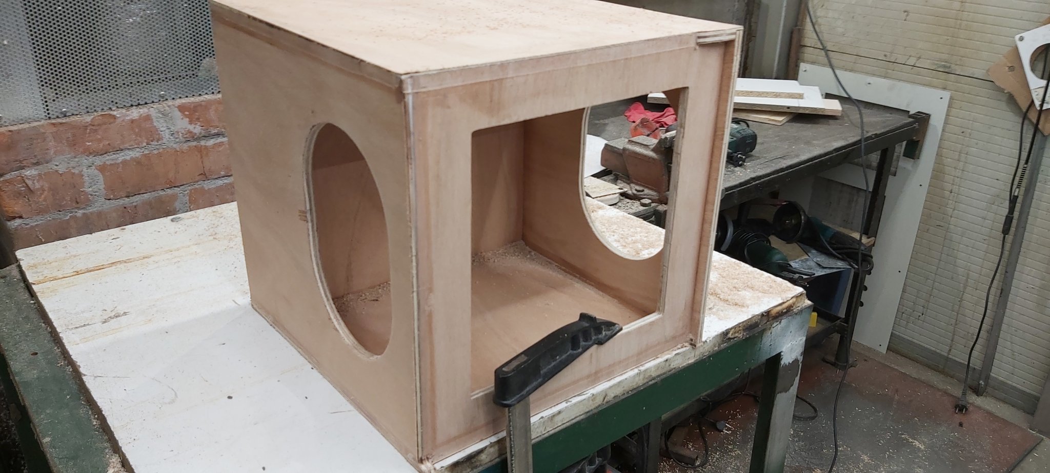

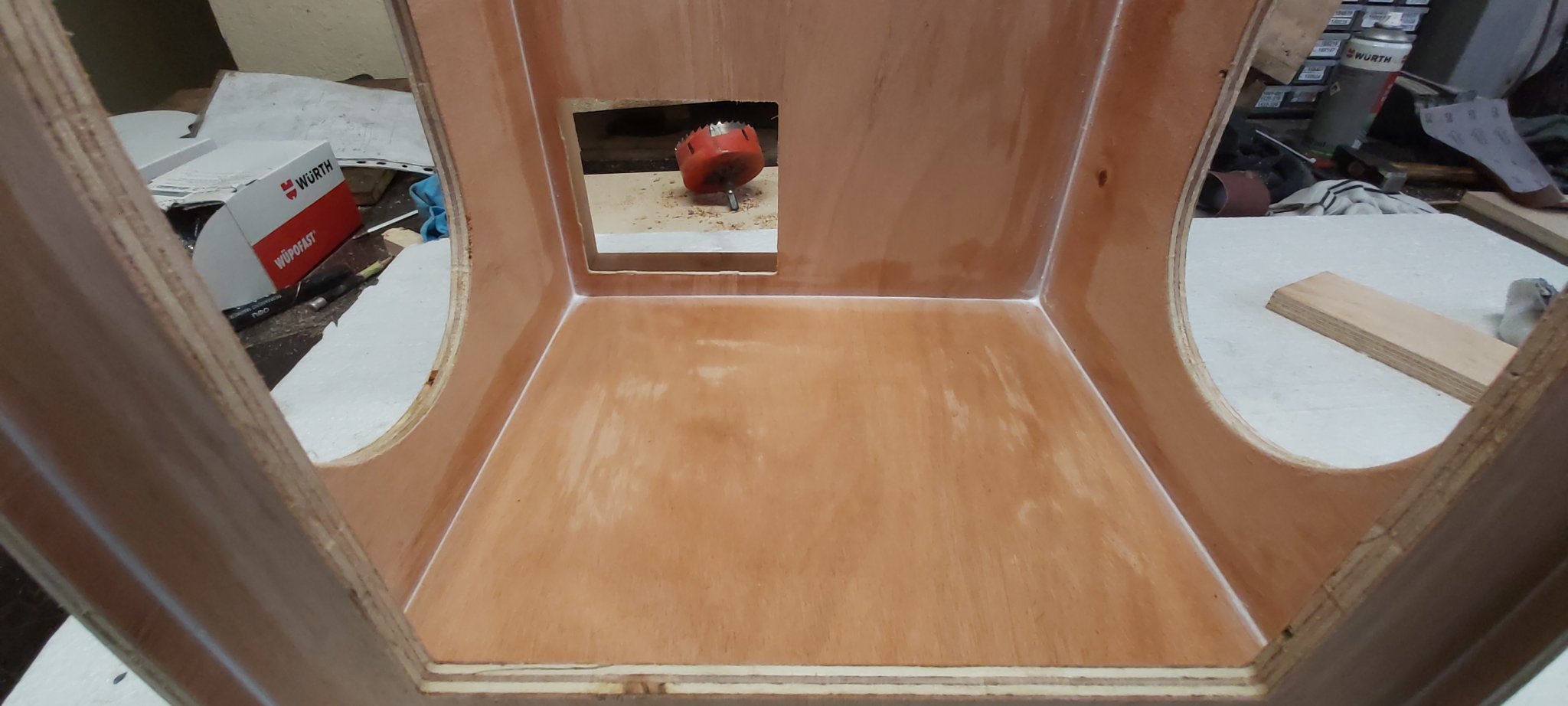

So we are now at Stage #3 => Building plywood portable test box (for my old, existing drivers).
As portability is the one key issues, I chosen Okume 10mm, 5-layer waterproof plywood.
It is very light, so the weight shouldn't be an issue, and it should be sufficiently stiff, considering that all panels are relatively short (less than 450mm).

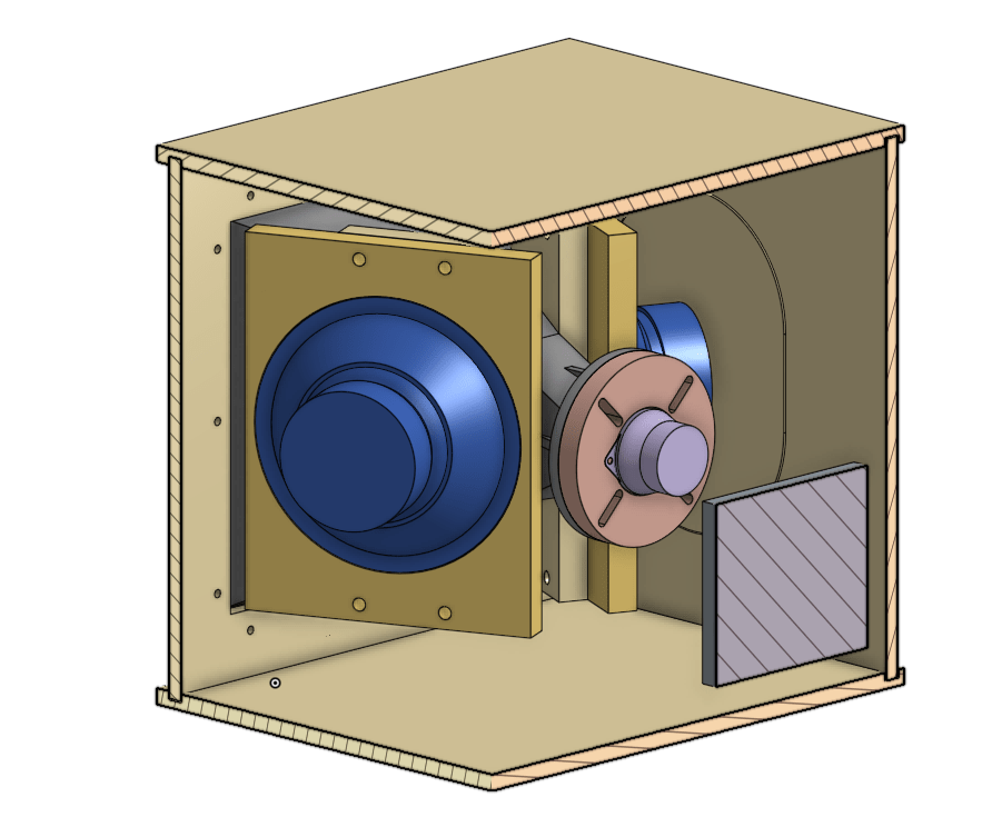

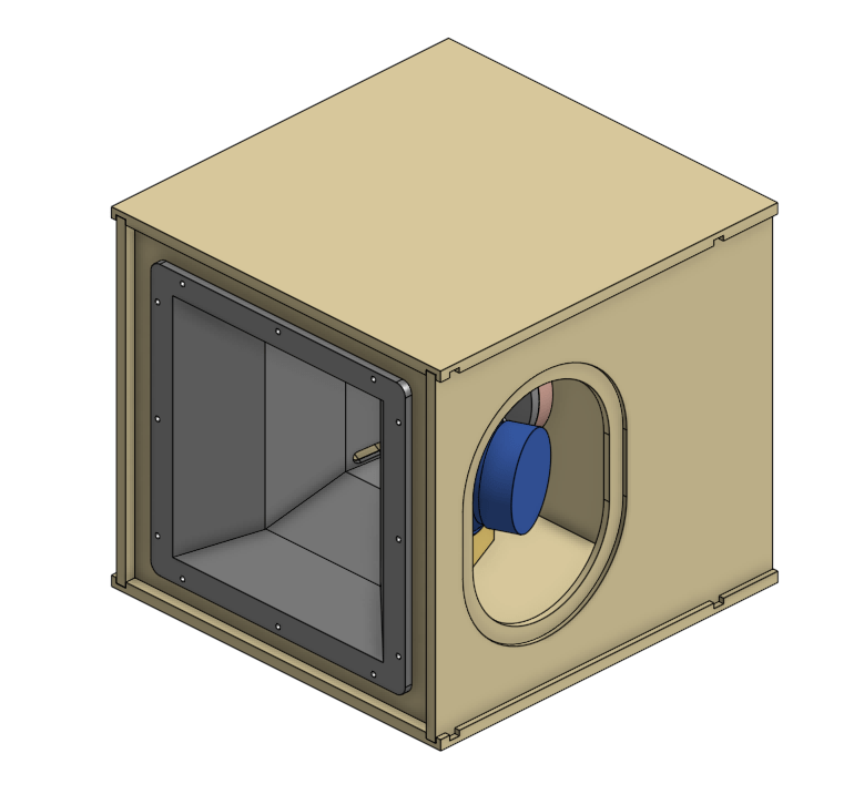

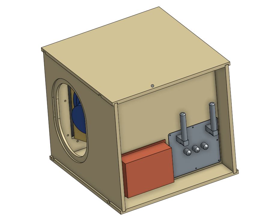

So, I created simple box design, with routed grooves on top & bottom panel, to simplify assembly & gluing.

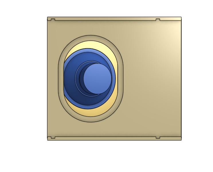

During 3D design, it was obvious that H280 horn can't be installed with both 6.5" woofers attached => so I added two hatch openings on both sides, to install/remove woofers.

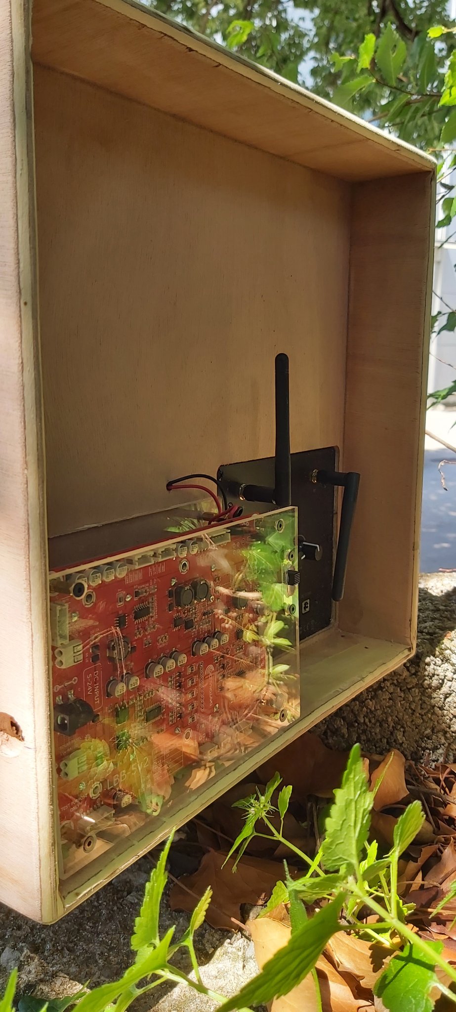

The biggest issue was how to mount "Dayton Audio" Li-Ion charger and 6 Li-Ion batteries => the charger has switches and LEDs , which will be invisible if mount PCB inside the box.
Second issue was mounting of "Arylic" plate amp => it has two antennas, which can be damaged if the are protruding too much from behind.
Therefore, I've decided to mount back panel to leave 60mm clearance from the edge of the box, this should give sufficient clearance for electronics.
Here are couple of 3D renedering screenshots:

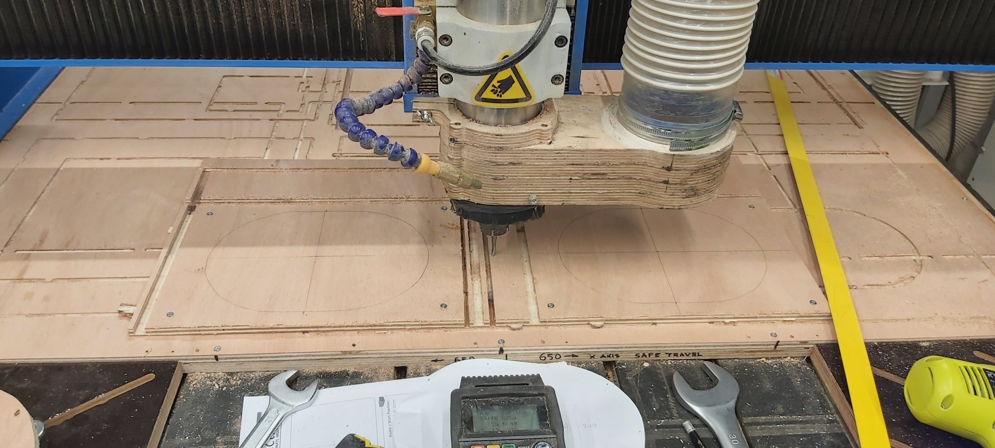

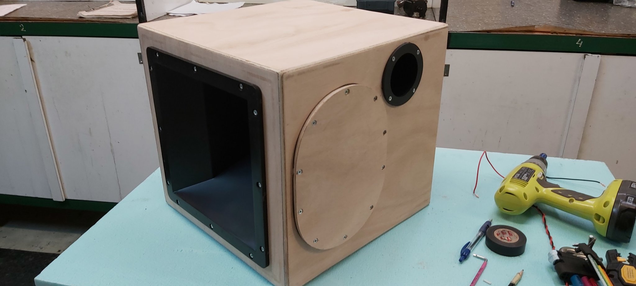

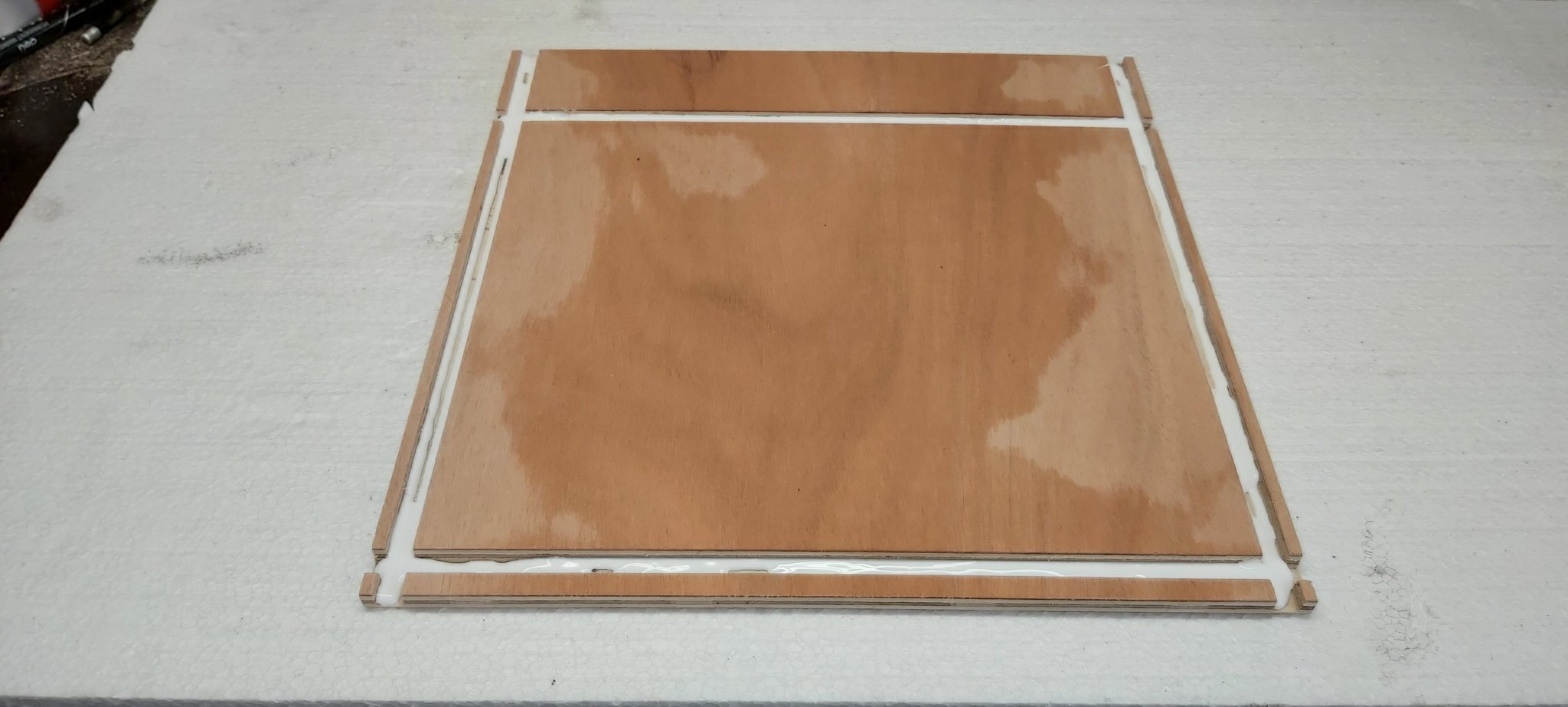

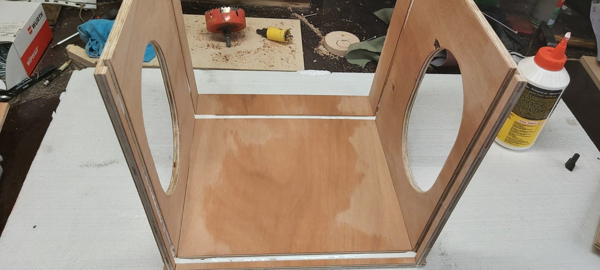

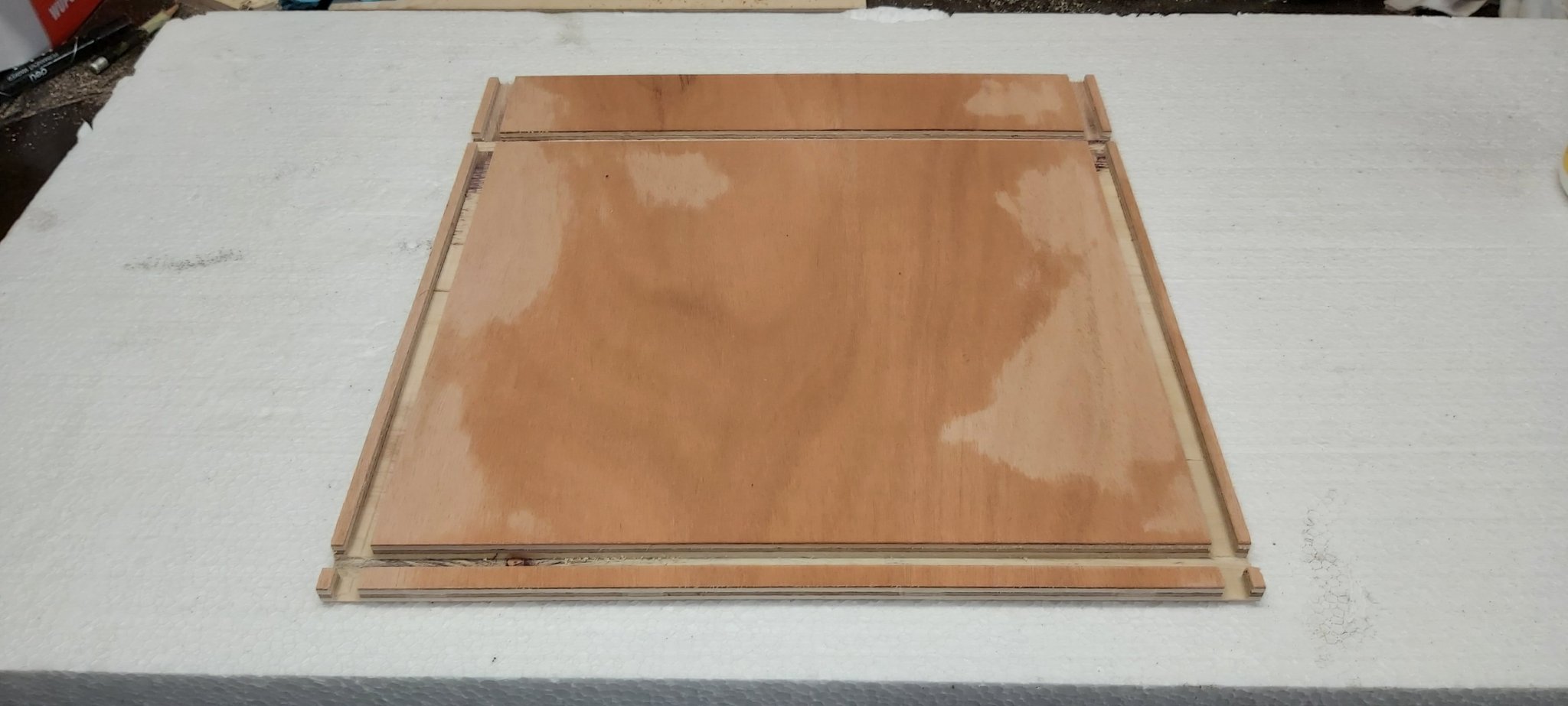

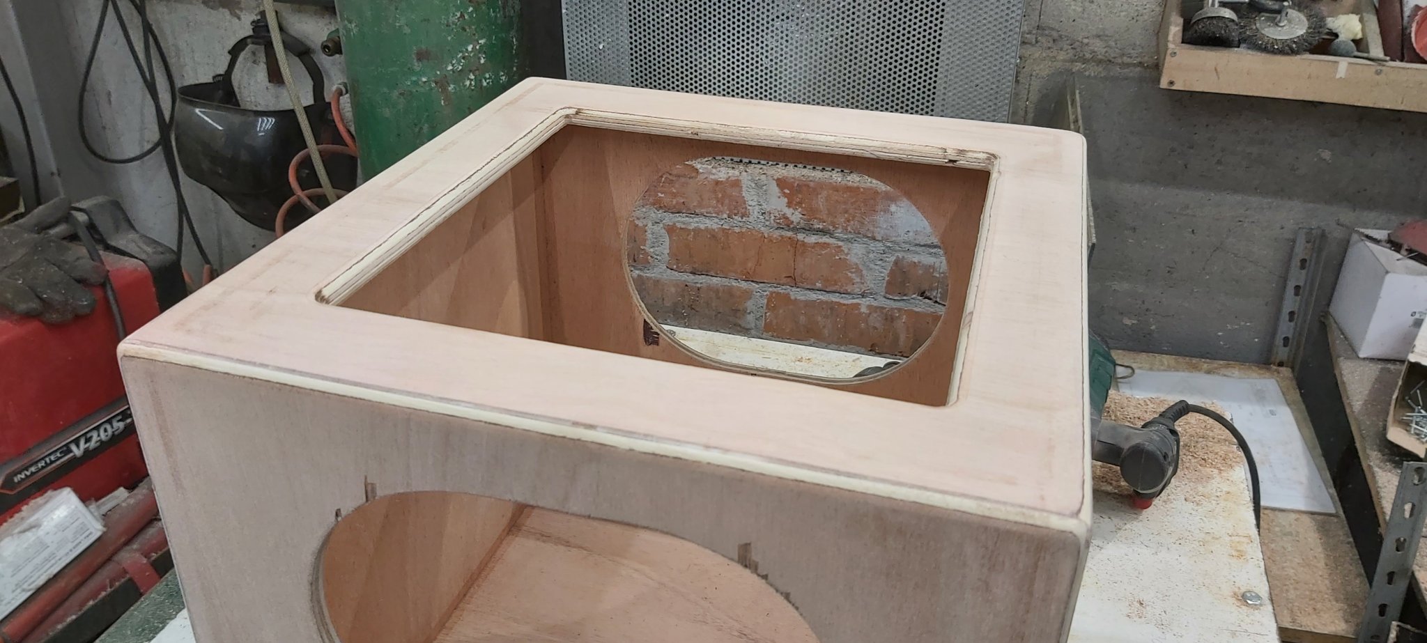

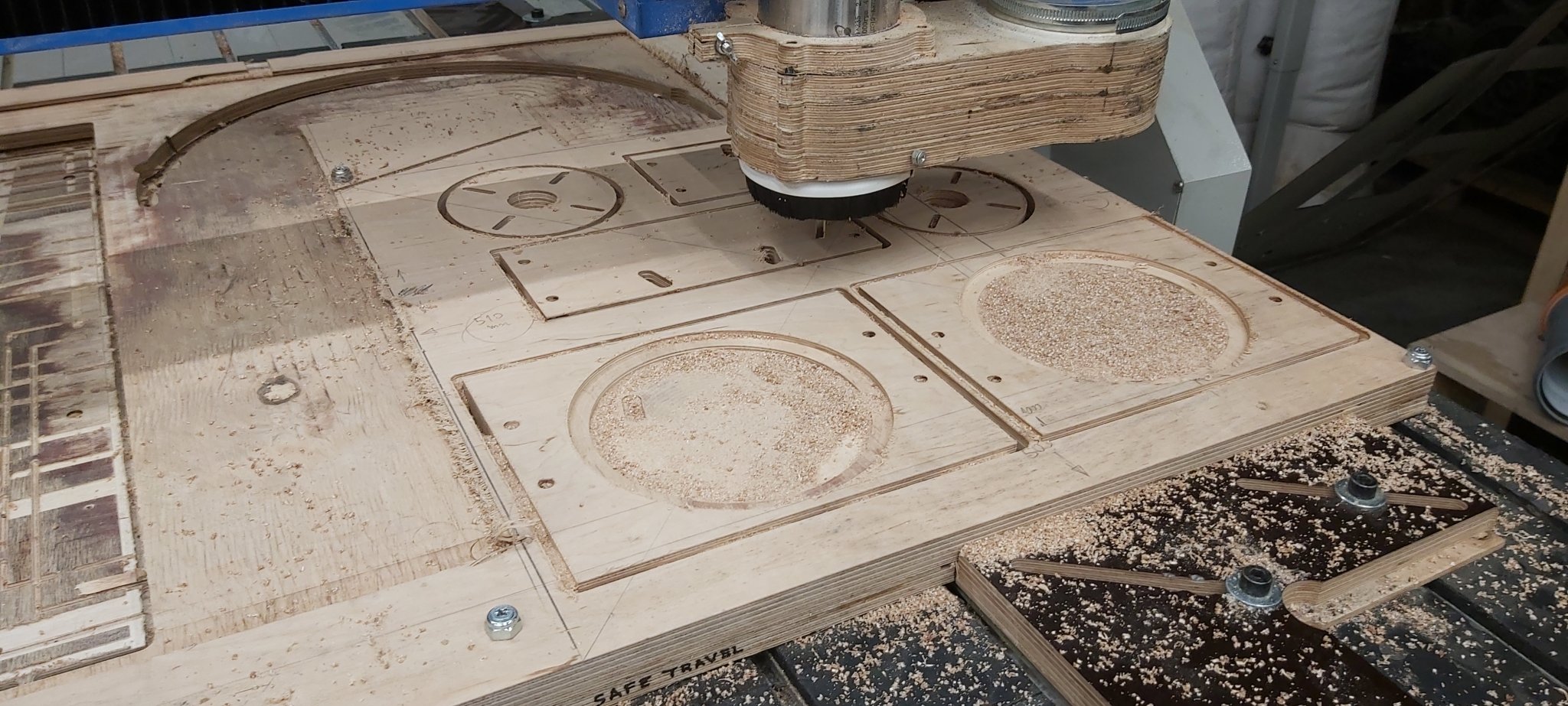

After initial design was done, it was again time for CNC router => of course, as always , when I generate my initial (very optimistic) G-Code and send it to machine, couple of router bits & plywood boards have to be sacrificed to the Holly God of Audio😀
So after some swearing and cursing, I manage to cut all panels and finally it is time for assembly:

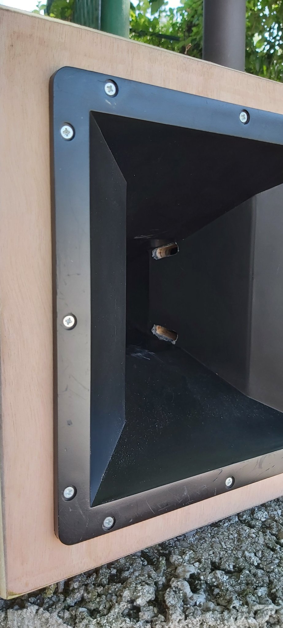

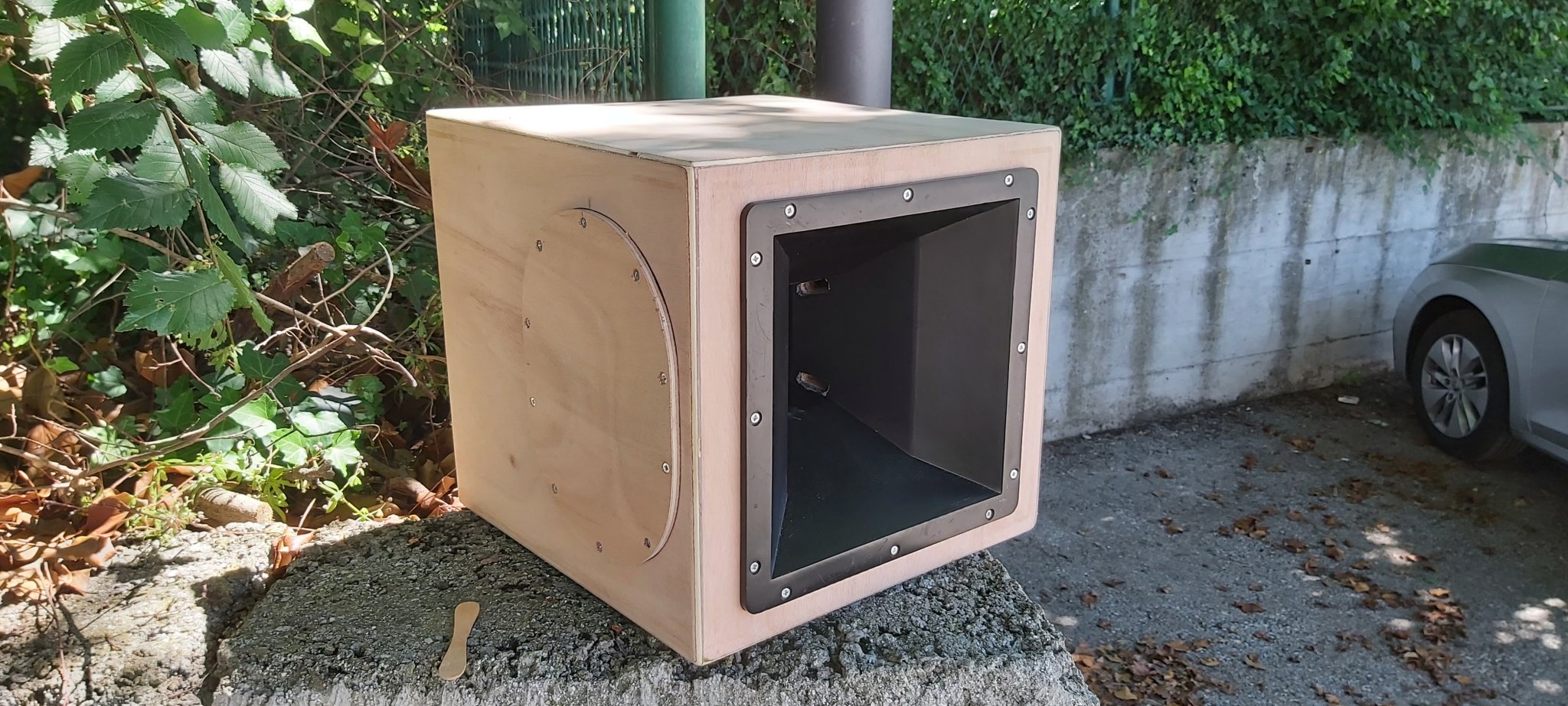

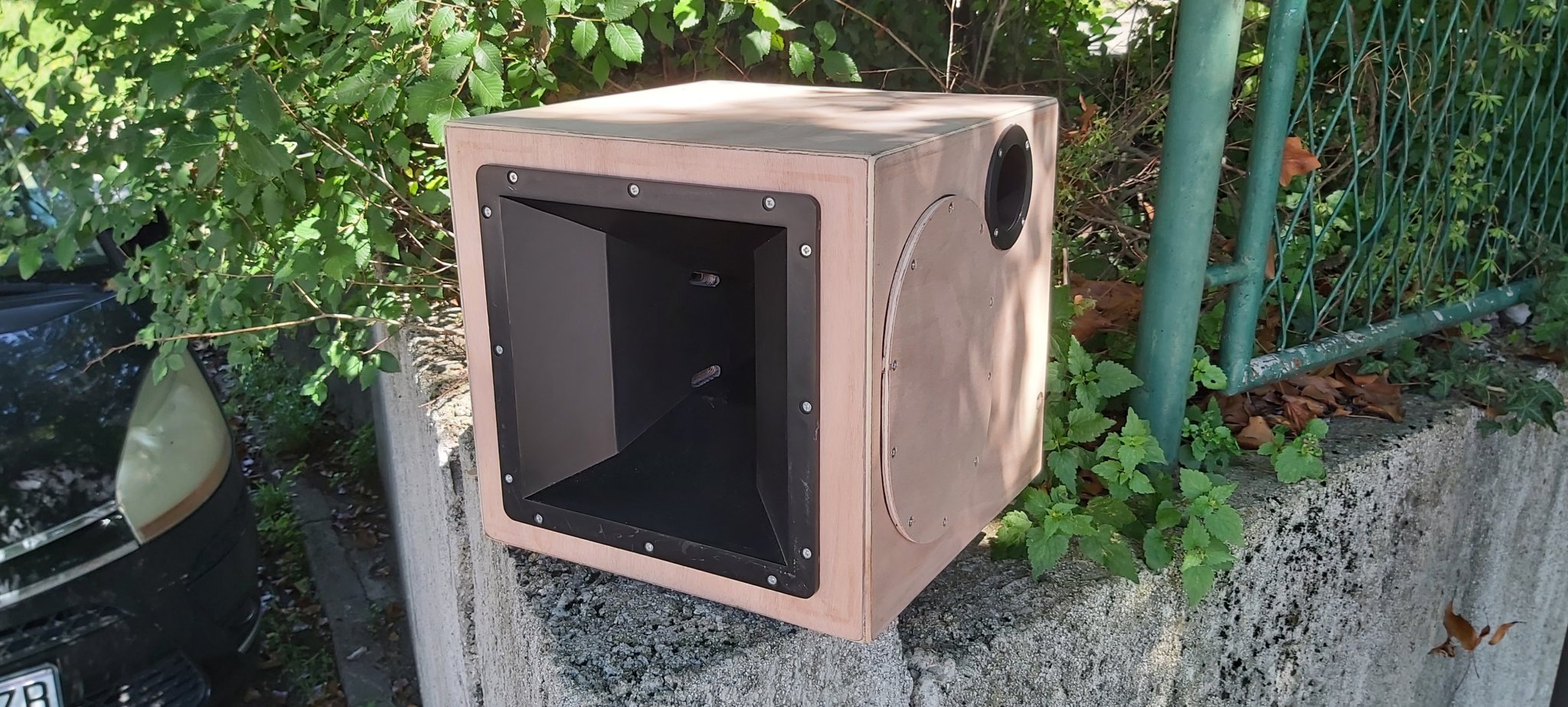

Due the fact that initial testing with existing, old drivers went well, I decided that it is time to order new drivers for my future double (or twin) H280 box.
For fullrange driver, I wanted to use "SB Acoustics" SB65WBAC25-4, which is proven driver in 2-way MEH projects here , but it was out of stock.
Therefore, I searched for similar 2.5" driver but couldn't find anything close, that has similar specs and that has good reviews.
I wanted to have fullrange driver with raising response on the top end (from 10k to 20k), with relatively solid efficiency, and power rating, so I've decided to try "Vifa" TC6FD00-04, and I ordered two drivers => one will be used for each 50W output channel of "Arylic" 2.1 plate amp.
For woofer driver, I've decided to go with "SB Acoustics" SB20PFC30-8, which is low-cost, light weight 8" woofer driver, with relatively low resonant frequency, good X-max, and solid efficiency (89 dB/1W).
I've ordered four of 8 ohm versions => two per each H280 horn, and all four in parallel to get 2 Ohm resistance, in order to extract maximum power from subwoofer channel on "Arylic" 2.1 plate amp.
As I was still in process of building test wooden box for my old drivers, I wanted to test "Vifa" TC6 instead my no-name driver, just to hear what can be expected:
Please note that as this is test box, I temporarily mounted all electronics on rear panel, including batteries & charger.
That way, all SMD LEDs & buttons on charger are accessible, and I can monitor charge process, capacity of batteries, and battery temperature.
On final twin H280 box, I will arrange this differently.

To continue with project:
After completing new box, I've created initial DSP settings, and performed couple of tests outside, couple of things were noted:
a) Even after some larger distance (>10m listening distance) , there are still lot of details present,
b) High end coming from small fullrange driver is more than sufficient => I was afraid that there would be lack of high frequency extension, bit this is not the case,
c) Bass from my old 6.5" woofers goes to about 50-60Hz, which is sufficient extension, but I can hear some low frequency distortion on higher volume, which seems like membrane is out of control (excessive stroke under bass reflex tuning frequency).
I'll try to sort this with different high-pass filters and/or different bass reflex tuning,
d) Woofer ports are maybe little bit too restrictive, as chuffing noise can be heard => but these holes could be easily enlarged if required,
e) Thin okume plywood (10mm) is sufficient for box of this size, as there are no excessive vibrations/ringing.
Here is first test outdoors, after initial DSP settings were done:
(Song used: Brian Bromberg - My Bass)
