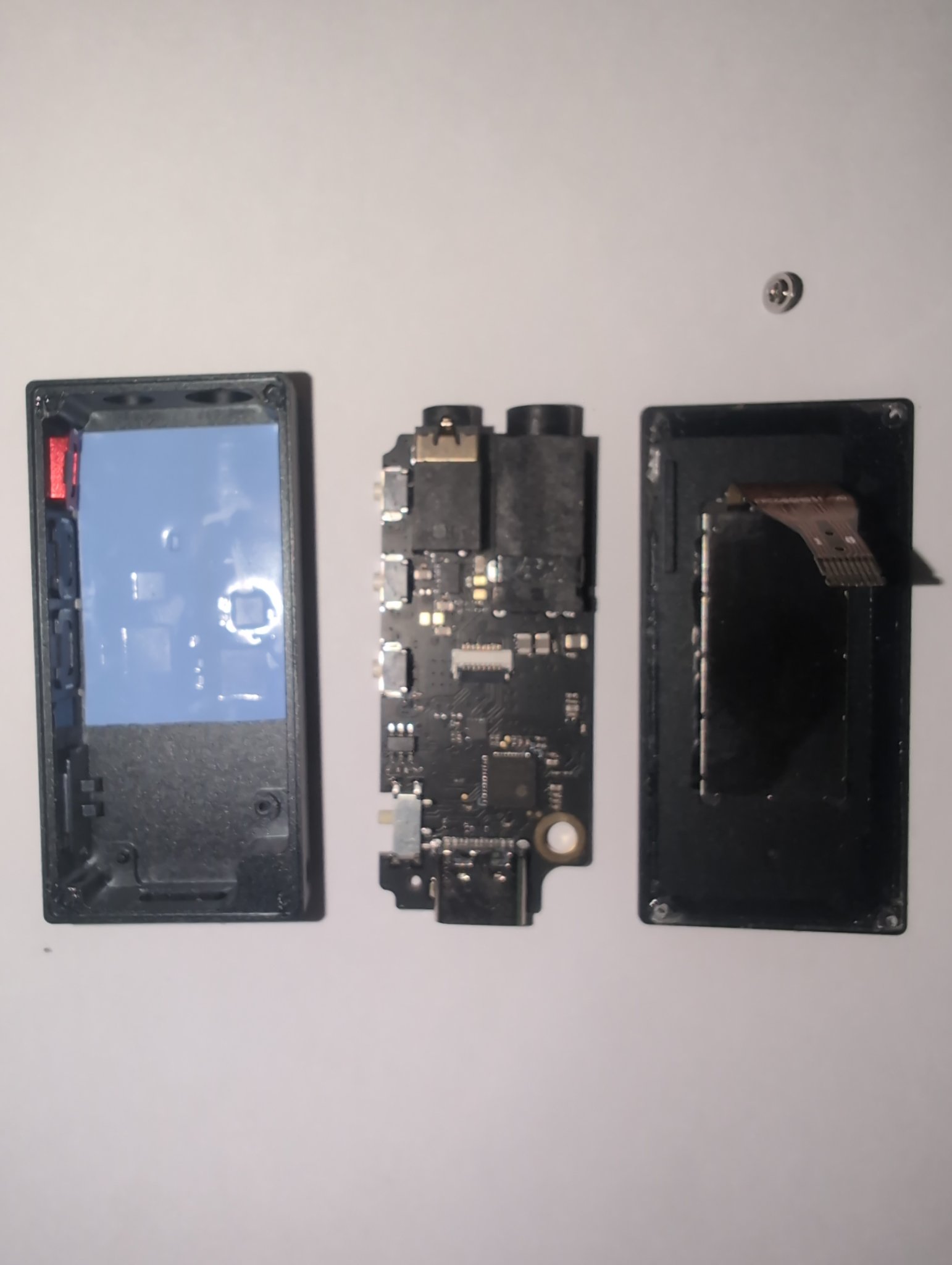

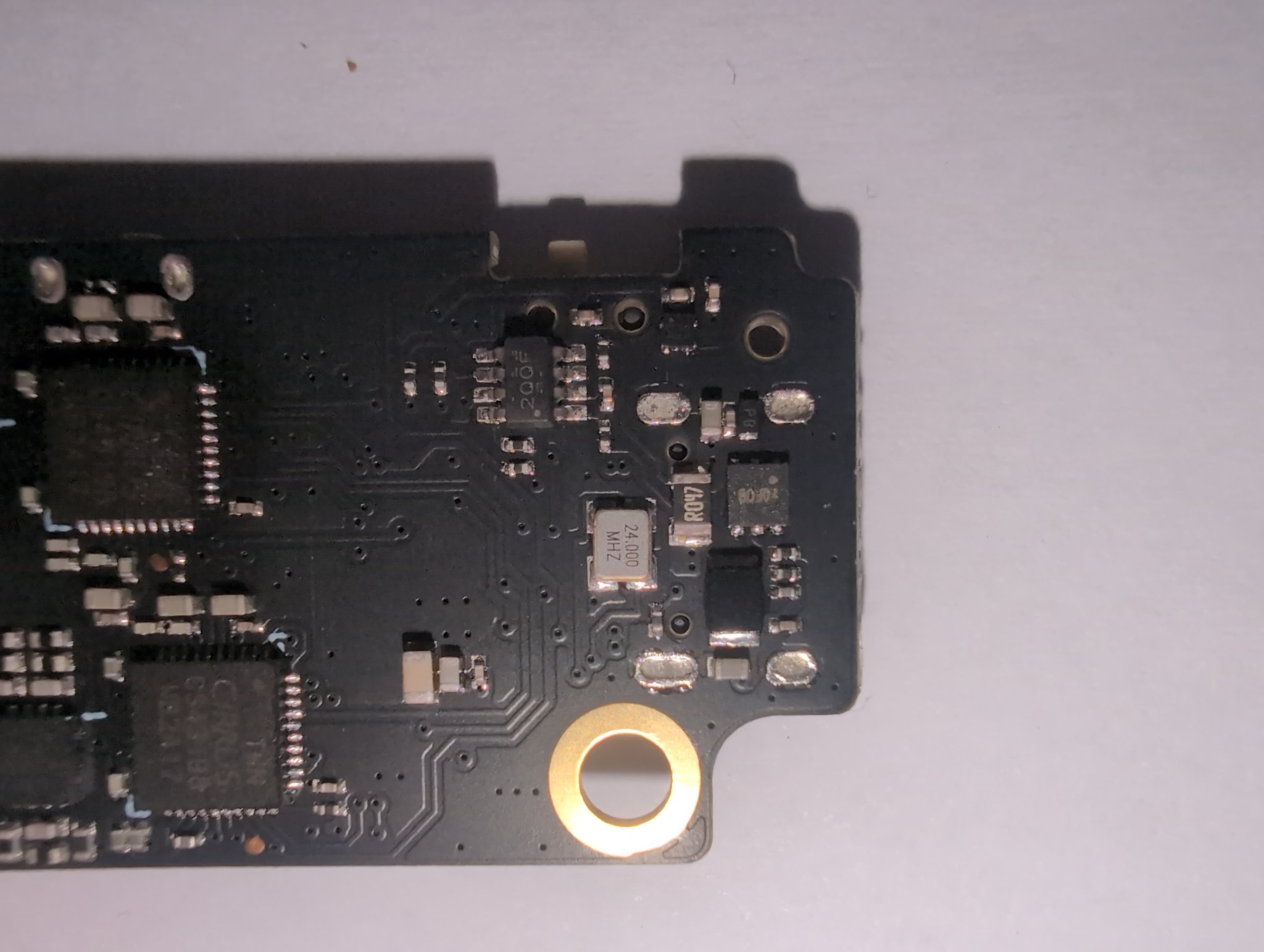

since im a somewhat minimalistic fan and having heared the KA15 over speakers, i just wondered how feasible it would be to try to "tune" the good measuring KA15 base (different output opamps/complete different output stage/opamp bypass caps, power bypass caps etc) since chinese pcbs are generally not recommended and something like the fiio is atleast good measuring 🙂

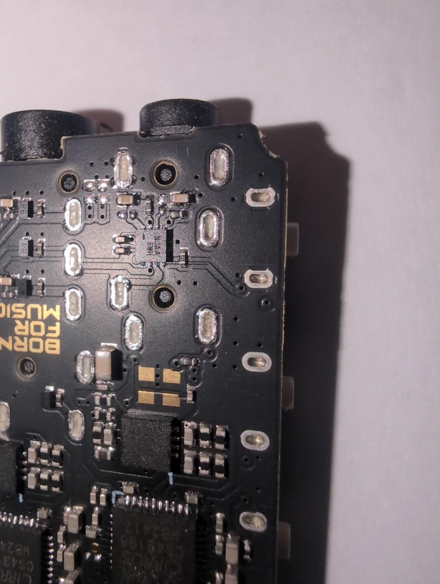

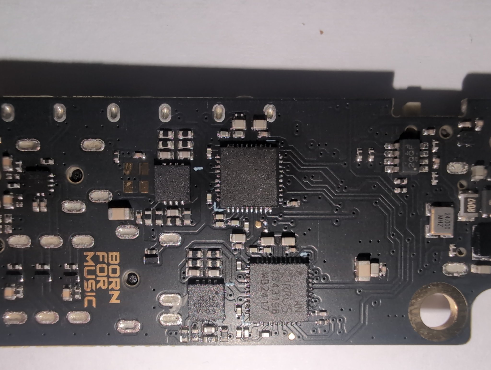

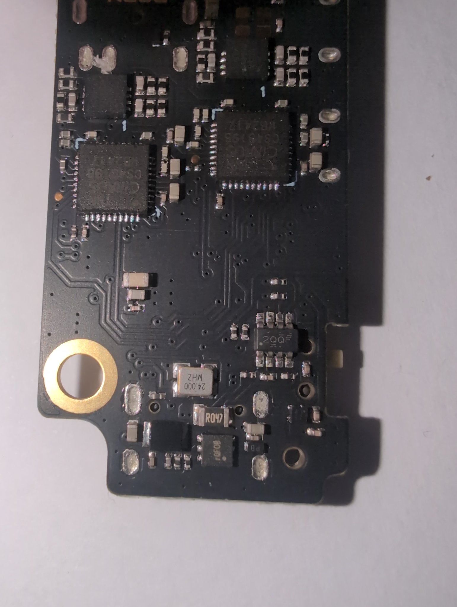

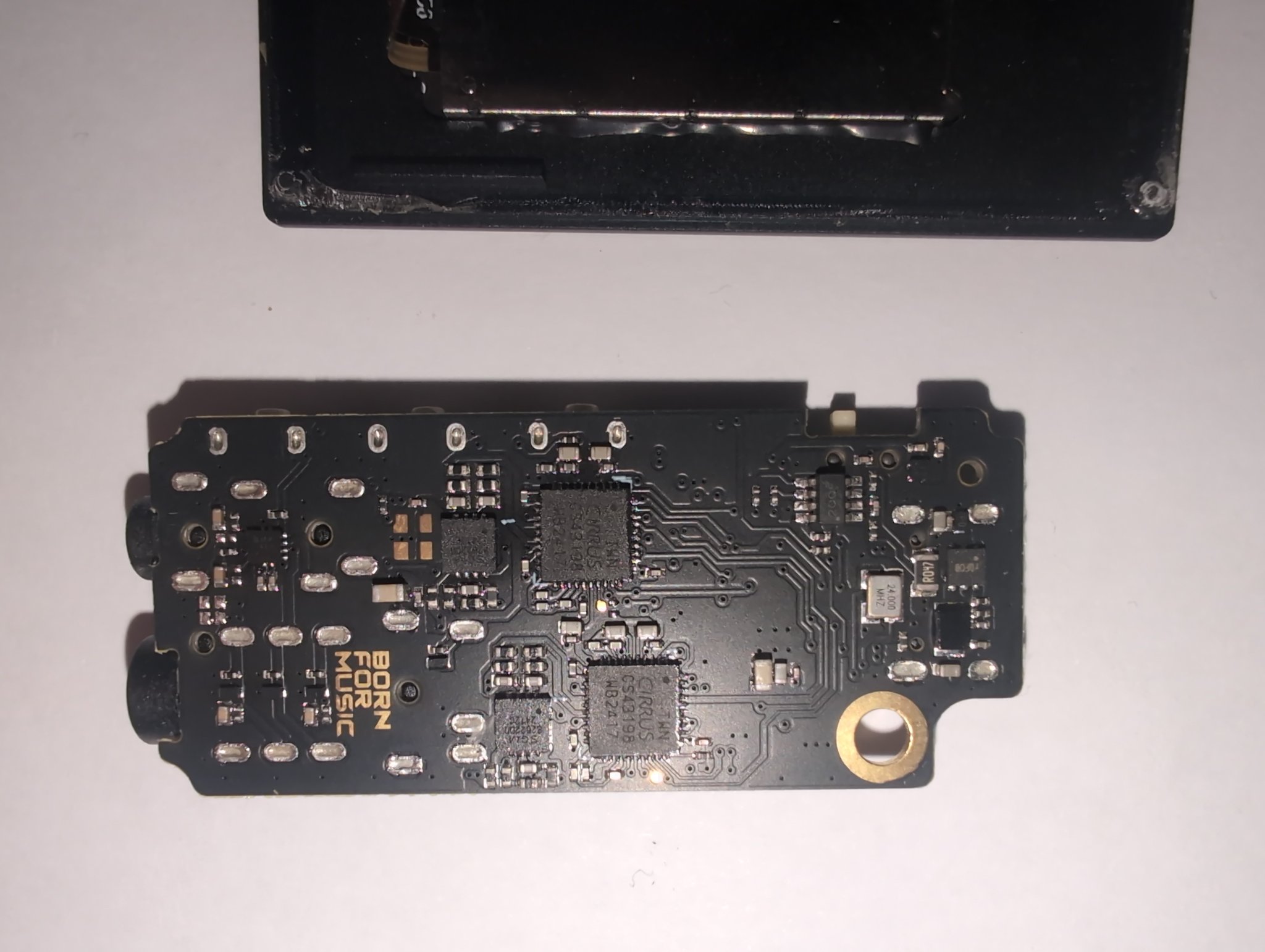

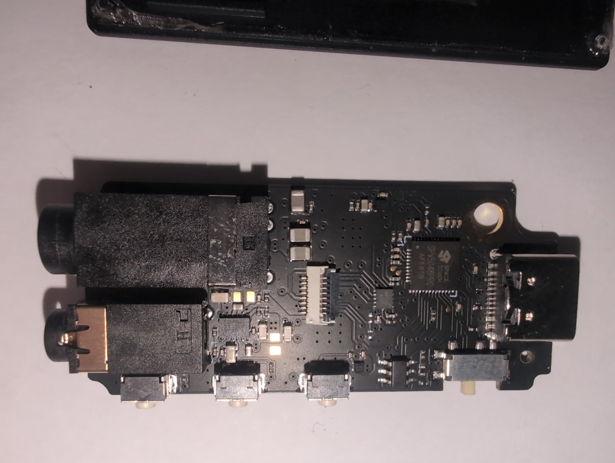

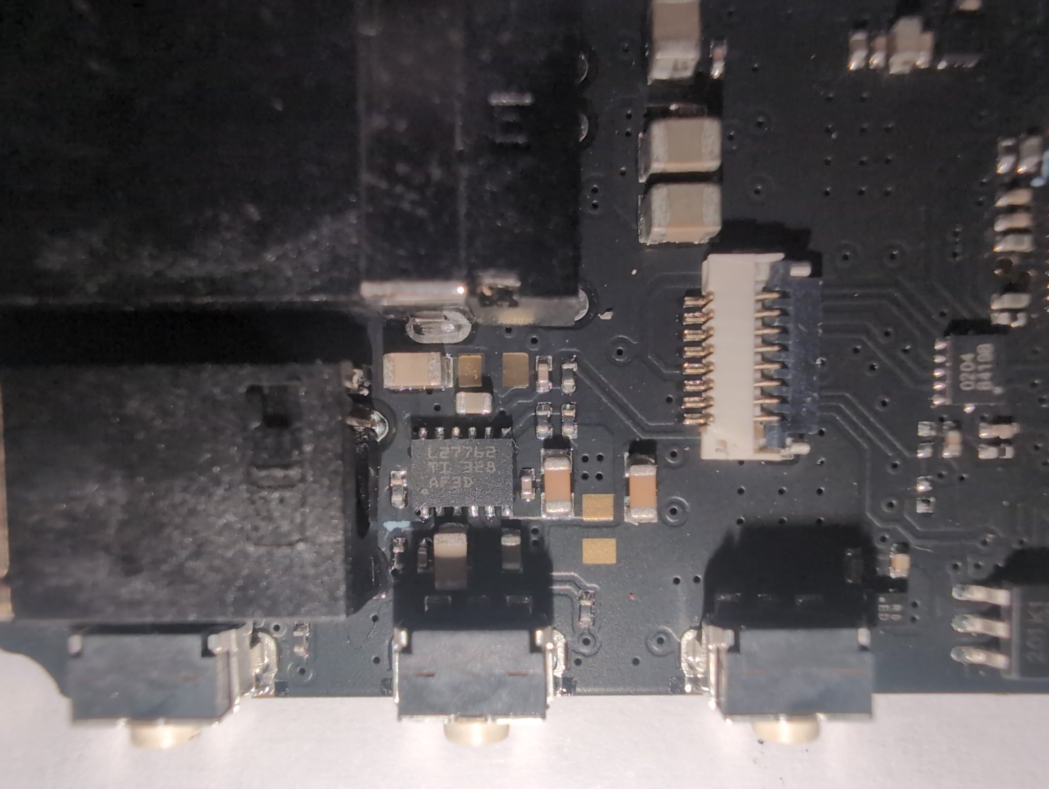

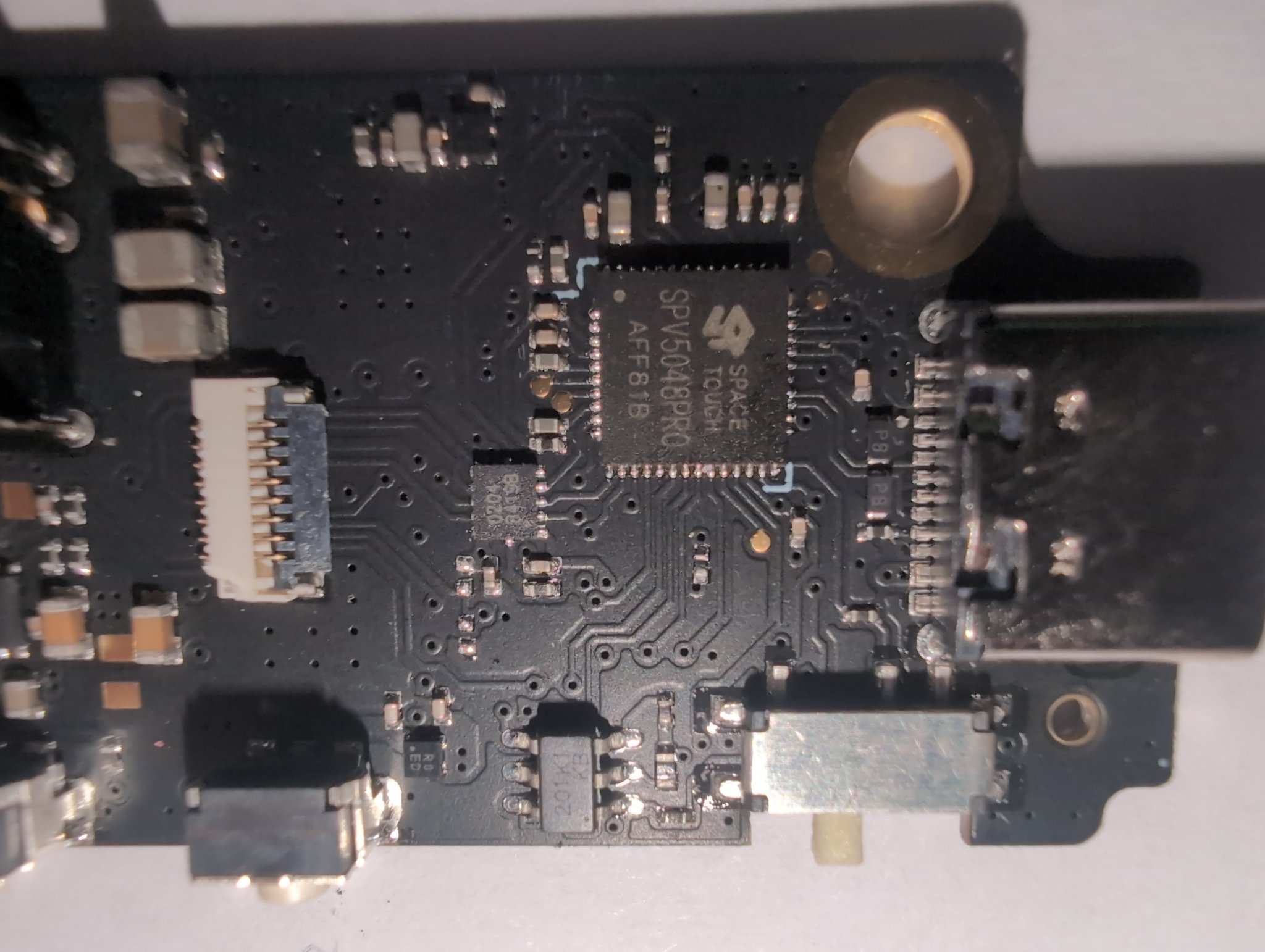

as far i understood the KA15 is a fairly easy implementation of these chips:
USB Chip SPV5048Pro, Dual Cirrus Logic CS43198 DACs, Dual SGM8262 op-amps
the usb chip seems to be unique to the KA15 as a google search just turns the KA15 up, i hope i could either use the opamp output directly or tap into the cs43198
i made some pics of the inside 🙂

Okay. I would say this: A good dac board needs at least 4-layers. Any boards with only 2-layers can be disqualified.
Then, for a given dac chip, synchronous operation is usually best, with crystal clocks located very close the dac chip. Besides that time reference, the other thing all dacs need is a good voltage reference (stereo Vref/AVCC).
In addition, freedom from USB bus noise problems can help a lot. It means galvanic isolation to start with.
Proper powering of the dac chip and for any output stage opamps are also important factors.
You might start by reading the thread at: https://www.diyaudio.com/community/threads/general-purpose-dac-clock-board.413001/ ...in order to understand one example of how pretty good synchronous operation can be achieved. If you also need SPDIF/TOSLINK/AES, then an ASRC may also be needed.
