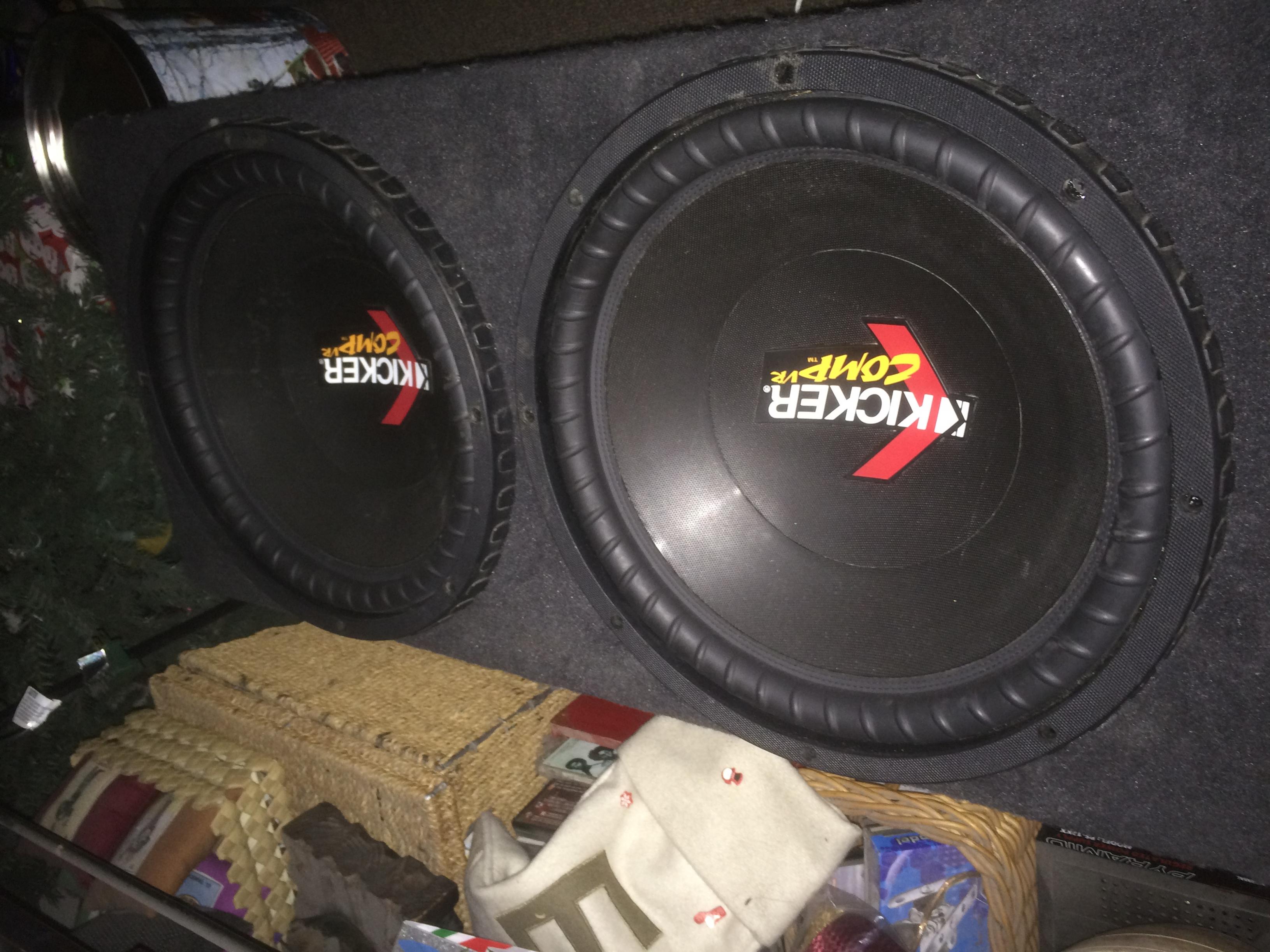

Hey guys I know this may be a little of topic in repairs. But I'm planning on building my own box instead of just going to the local stereo shop to buy one already made. I recently got these two kicker comp vr 15's off Craigslist for $90 and the box they came in is absolute crap it's to small for them. I did some thinking and buying a prefab box will cost me approx 60 - $80 which I could use that $ to build a way better box for these subs. I was either thinking a ported or large sealed box. Note that I have zero wood working skills! I'd like to go with the easiest to build. So what would you guys recommend for these old school cvrs? Amp I will be using? Varies I have so many I like to switch. Mostly Rockford. I will also be using and epicenter for those old school jams. I want that low, loud smooth bass. Can anyone give me any pointers? Also does home depot cut the wood for you? I don't have a jig saw or skill saw that's why.
15s ported will be a big *** box,
you want low tuning for the box if you are using an epicenter.
i would push them with a 1000RMS amplifier, but you need to know what impedance are the coils, they are dual 4 ohm, you will need a 1 ohm stable amplifier.
if they are dual 2 ohm, you will need a 2ohm or .5ohm stable amplifier.

These are dual 4 ohm. I will be powering them with a Rockford Fosgate punch 800a2 at 2 ohm each channel.
You could also run series parallel and have a 4 ohm load to bridge to the 800a2 instead of 2 ohm stereo each channel. The amp will be ran hard so its gonna get HOT!!! 2 ohm stereo each channel or 4 ohm bridged either way your going to be pushing it hard to get a 1000 watts to those subs.
You could run 1 ohm and pick up a 1 ohm stable mono amp for fairly cheap. The mono amp depending on size will draw less and run way cooler, it will be more efficient, and more reliable.

My experience sealed enclosures usually have tighter more controlled bass, better sound quality. On the down side sealed enclosures generally require a much higher power amp to get the sound your looking for.
If you like big, boomy, fierce, bass and don't have a huge amp go ported. You have more tuning options with ported.
In an earlier post I read these speakers were meant for sealed only, guess you need to read the manual.

The Xmax in mm is .492 which is really low. It's the subs ability to move in both directions when powered. If you look at this subs xmax HDC its 40mm total which is a lot of movement ability which would tell you its a good sub to port.
In other words if you port this box you'll run the risk of burning up the voicecoil faster then in a sealed box which gives the sub much more controlled movement.

I would run those sealed, with the largest recommended space per woofer that kicker recommends. Also, separate them into two chambers. Run them series each woofer to 8 ohm then parallel them at the amp bridged to get 4 ohm at the amp...like you mentioned. Be sure to use separate speaker wire all the way to the amp, at least 14 gauge thick, so they get as much current as possible. That amp will beat the crap out of those subs, 4 ohm mono will heat it up but not any more than 2 ohm stereo and the woofer control will also be better.
If you are using an epicenter, and are not super experienced with box and system design and tuning, that is another good reason to run a sealed box. That will take a few factors out of the picture for simplicity's sake and add a little more safety for the speakers. Keep in mind that making the box as large as recommended will add a little more low end spl, but will also lower power handling of the subs. Try and find out what they will handle at their maximum box size before deciding how large to go. I would run the largest size recommended personally, if there was room, it would be more risky but the response of the woofers would be worth it in my opinion.

For a 1st box, try sealed. They are lighter, take up less room, easier to build, and often allow for more power to be driven to the sub, plus they add physically restive loads to the actual woofer, which seems to act like a really high dampening effect. Use a thick 3/4" or thicker MDF so the box isn't falling apart or adding odd resonance freq. to the overall sound.

I say sell the prefab box they are in for $15 - $20 on craigslist and use that money for some wood / materials. Doesn't take much wood working skill to get a good working usable box, perhaps not the prettiest, but functional!
Many Home Depot's / Lowe's will cut wood for you, just ask them. You need to have the exact sizes for all the panels you want cut and as Perry said they may not be 100% exact cuts, though it would be close enough. You can usually find budget jigsaw's / circular saws cheap, check craigslist, you'll probably need one to cut the sub hole.
I'd port them; knowing you like high output from seeing your vids over the years I think you'd be happier tuned around 35 to 40hz. These are a little older than the manual posted in the thread, but they should have the older manual on their site if you have the model on the sticker, not sure if the 2007 one is close enough.
