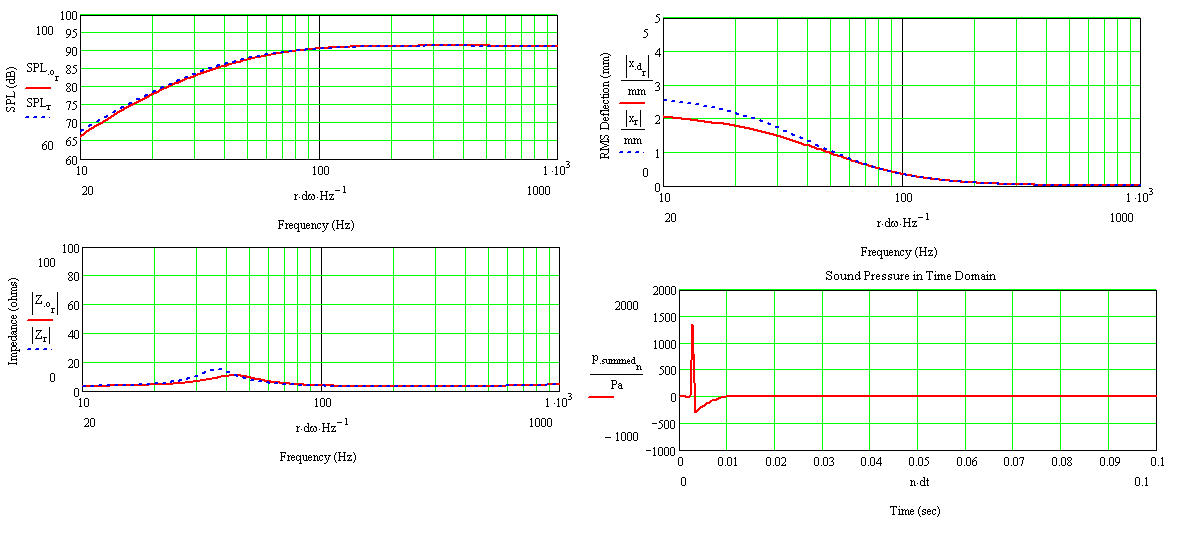

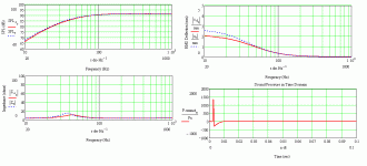

Here's what have. The one on the left is an Usher 8955a in a 10:1 tapered TL with a start area of 5 Sd and length of 90 inches. The middle one is a ScanSpeak 21W8555-01 in the same TL and the one on the right is a Usher in an enclosure half the volume of the TLs, so I can use two for my design. However, for the ported box, I get a different result using MJK's ML TQWT spreadsheet with same dimensions, I believe. The one in the picture is his standard "ported" spreadsheet.
The ported box has more output and less excursion above 20 Hz than the TLs. Also it has less output from the port above 100 Hz with less stuffing, which is good since I think I would like to have the crossover around 200 Hz.
I wasn't saying I didn't like ported enclosures, just that I've never heard one I liked. Which isn't saying much, since I've heard little.
I have read claims that the group delay of ported enclosures between 20-30 Hz is in the range of being audible by the human hear, around 23 ms vs 8 for a straight TL or sealed enclosure.

Notice Scott's TL clearly show the 'IB mimic' response I referred to earlier. The driver/TL response is virtually identical to the driver's IB response shown by the blue dotted line, and has a smooth rolloff below driver Fs. This would indeed be quite a 'hat trick' to accomplish with a Helmholtz box, but is 'old hat' for a TL.
Jimbo

I was unable to duplicate anything near your results using the TL dimensions you posted and the Usher 8955 driver. Where did you get the 'complete' T/S parameters, as they are not published? I derived them from formulas, with a good 'best guess' for Re of 6.5 Ohms, which duplicated the Zres number (from the published Z plot) exactly, so I'm pretty confident in it. I got a BL of 8.1 and Le of .3mH. The rest is all obtained from their data sheet. How do those numbers compare with what you used ?
