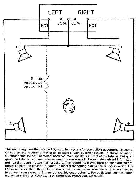

If you do what you did that with a mono recording and set the gain of each channel to be the same then ideally you would hear nothing as the signal at both positive terminals would be identical and hence no voltage difference would exist between them... result, no audio in the speaker.
Any other material (stereo track) will produce voltage differences between the two terminals due to the two channels having differing content.
Vocals seem to cancel because they are often centre in the mix and so have similar content left vs right channels. Any instrument recorded centrally will also cancel.
I don't know if there is a proper name for the effect but if you think about it both phase and amplitude comes into it, in other words any difference in the left vs right will produce an audible output.

Here goes.
When you connect a speaker across the two positive terminals, it will only respond when there's a difference in the voltage (signal) at those terminals.
ie, a vocal panned centre will have the same level in both channels, which means there's no potential difference (aka voltage, aka signal) between the terminals, and the speaker is silent.
An E-GTR panned hard left will have signal at the left + terminal, and the right + terminal will sit at zero volts. Therefore, the signal plays through the speaker.
What you've done is made it a mid-side system, and you're listening to the "side".

Speakers wired plus-to-plus from a stereo amp with a stereo signal will produce the "difference" signal.
It's old news, goes way back to the Dynaco/Hafler system.
I've wired a small hidden speaker on top of the china cabinet in the dining room that way from the system out in the living room.
During any dinner parties, the "background ambience" sonics are pleasing to the diners.

Here's an interesting link which describes how to derive the difference channel from a stereo amplifier and shows a practical Hafler-Gerzon rear loudspeaker circuit.
