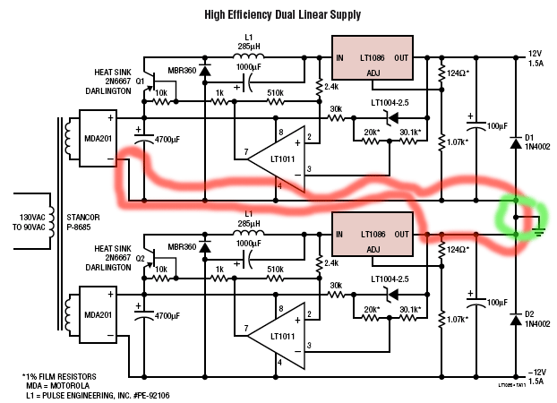

Can we use a positive regulator to produce a negative voltage?
I'm looking to build a +-15v (adjustable) using 1 or 2 rectifier bridge, and use 2 identical positive regulator (LM1086, LT1086, LT1963, etc.).
I've found a schematics but they use 2 bridges. Can we use this with only one bridge, and remove the first stage of the schematics (darlington and opamp).
Possible ?

One bridge and center-tapped xformer: NO
Two bridges, isolated secondaries (and basic topology as shown): YES

Thanks.
I tried with only one bridge. It was funny. Boom.
If I follow you, I can have for each:
15v secondary + bridge + caps + LM + caps
And I connect the ground at output (or one ground plane for both ?)
a dual positive supply can be series connected AT THE OUTPUT to give a dual polarity supply.
But you cannot use a centre tapped nor a single bridge to create the two completely separate supplies needed for the commoned output dual polarity.

If fact, if you already have the right transformer, the cost is only one bridge more and more work to design the pcb?
For the ground plane, on the PCB. Can we build it using all the component in red or we MUST build 2 separated ground planes et connect them at the exit (green).

the sensing resistors feeding the regulator control circuits MUST SENSE the OUTPUT voltage, not some arbitrary point on a ground plane.

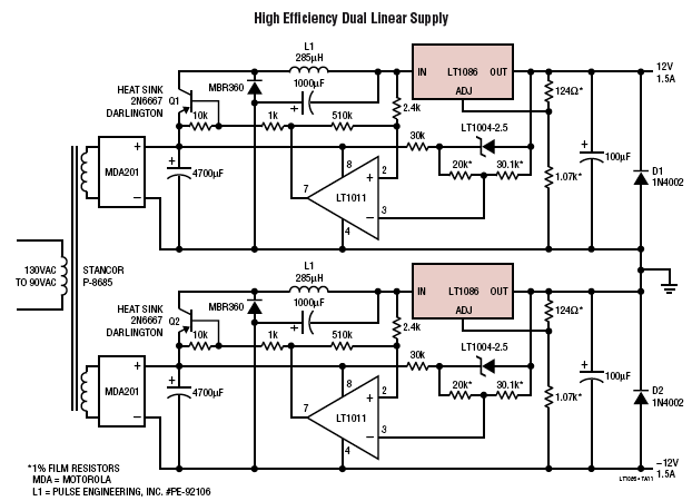

Like this?
The objective is to produce someting better than LM317/LM337 couple with the minimum component and lower input voltage.

you need to do more reading on basic circuits before you try to make them more complex.
Fuses F1 & F2 might blow on first switch on. You can either make them bigger (less protection) or place them after the main smoothing caps.
The upper bridge rectifier is back to front.
The 10VA will give 410mAac maximum continuous current.
After rectifying and smoothing the maximum continuous DC current is ~200mA. A 150mA transformer (3.6VA) will not do.
If you want 15Vdc then you need a 15Vac transformer.
10VA will now give 165mA @15Vdc.
The inductor before the first cap has not been designed to make this a choke regulated PSU.
It will still act as a capacitor input PSU.
the inductor in the lower 0v lead should be on the lower -ve lead.
The sense resistors should be connected to the output.
the ground in the lower reg should be connected to the negative supply line for this regulator (just like the upper reg is connected to it's negative supply line.

Sorry but yesterday night I worked as a pig on this drawing. Too fast and with not edited copy/paste. This not my first psu (go to see my last one, the dedicated DEQ/DCX psu on the forum). I uploaded a corrected version of the drawing. Most of your comments was already corrected.
The fuses are not fuse but polyswitch. The LT1965 is a new low dropout regulator with low noise from Linear. It works with low esr caps. This is an example. We can replace it with others as the LT1086, LT1763 or others from National.
The idea is to build something different of the regular 317/337 couple or the more detailed Sulzer type psu (too many component in my case, no space).

that looks much better.
Check the datasheet again, LDO regulators are more susceptable to oscillation than the conventional regulators. Look for any advice and permitted capacitance on the output for alternative loads.

I was in fact again reading the LT1965 datasheet... It is stable with Ceramic, Tantalum or Aluminum capacitors. The minimum is 10uF.
But some questions:
- Is the LT1965 really adapted to work with 15v output (look at noise and ripple chart)?
- The application note talk of the value of the resistor divider depending of the "9v clamp". I don't understand this part. My English is not always good.

Is the diode d1 going to the correct pin. I have seen it going to the output pin to discharge the cap if the output get shorted.
Is the LED the right way round?
C8 looks a bit small.
Have you worked out the minimum and maximum voltage on the smoothing caps for the worst range of mains voltage and output current?
You need this to check for dissipation and heatsink sizing.

Look at the new schematics. I changed the filters and component numbering changed too.
D1 and C9 is a soft start.
For the C6 filter cap, it should be ok for the needed current (150mA max). The resistor devider is just used to use a small value cermet. It can be replaced by only one resistor. I'm not sure of the correct values as it is not explained in the datasheet.
Heatsink = (18,5v - 15v) x (0,150A/58) + (18,5v - 15v) x 0.150A = 528mW = 40°C with a T0220 package = no need of heatsink or a small one.
Correct me if wrong. I'm bad with numbers...

what are the lowest and highest voltages that feed the input to the regulator? The answer is not 15V.

Between 18.5V and 20V at input. But depends of the transformer and the bridge, etc.
