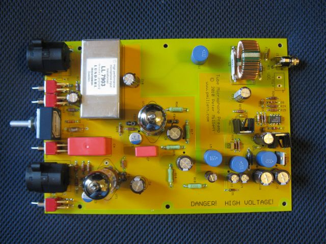

A while back a friend told me he wanted a good tube mic preamp to do home recording. I designed one... and have finally gotten around to posting it on the website.
It uses a Lundahl LL7903 input transformer, followerd by a ECC88 cascode then an ECC88 SRPP output.
Details are here:
Tube Microphone Preamp
Pete

Hi Pete,
Interesting and cool design, one thing that seems counter-intuitive to me is that the high gain settings have consistently lower distortion than the low gain settings. I'm wondering whether you have the answer to my odd questions:
The whole thing is very cool, and I wish I had not given up on tape recording before this came along, but I did.. And as always the PCB design and indeed the electrical design show a lot of thought..
- Could the lower distortion in the high gain position be due to distortion canceling in the second stage and that in fact the first stage dominates distortion wise?
- What is the distortion distribution in the first and second stages, and what effect does increasing the value of R6 at the output have on THD in the high load impedance test scenario?
- I like Lundahl transformers too, but am curious about the choice - was it simply because it mechanically fit, is extremely well shielded, and sounds very good or ? 😀

I also found it a little surprising that the high gain setting had lower distortion. I have to believe it is because of distortion cancellation. I actually didn't measure the two stages seperately... that would confirm it.
I don't think R6 would make much difference - I was surprised that at 1V out, the THD was the same at 100k and 600 ohms load!
As for the transformer - I confess I didn't put that much thought into it! I basically succombed to Lundah's sales pitch: "This is the ultimate microphone input transformer, designed for high quality tube equipment. " 😱
Pete

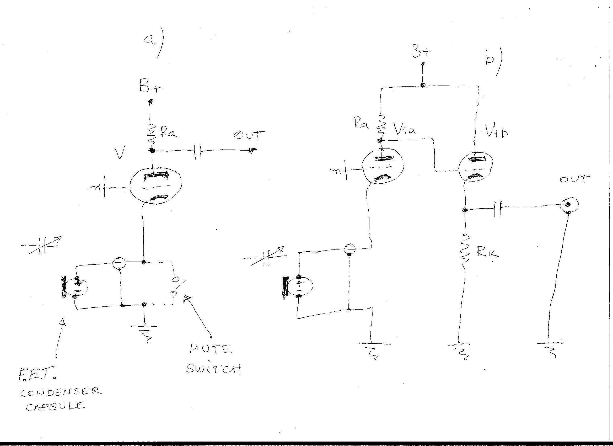

Congratulation Pete,good job.Here is my Tube Microfone preamp with Condenser Catridge(with integrated Fet)Mic.I use this Mic preamp for Radio Tube Transmitter long time ago.Never let me down,work extremly stable,quality depends from Condenser Catridge Mic only.Good Luck to All

..Hi, banat, i tried to make a pre like your long ago..back electret on a 6dj8 catode..and it sounded very good :warm voice and little natural compression..the only shortcoming was the excessive gain ..
..With 12ax7 two stage you probably get over one hundred volts output

Hi 0feedback !
Yes I know that this my design work OK ,
- Hart of this my simple but effective tube Mic pre. is the grounded grid triode where cathode supply DC for FET condenser capsule but in the same time same cathode is modulated with AF from the same Mic capsule .(fig- a) .
-(Fig- b) represent just one variation of this Mic pre. where second triode is CF ,DC connected to first triode anode , so in this configuration you can get lower output voltage swing but in the same time with much lower output impedance.
-Many other variations is possible depending from what you need , but Hart of this circuit will be allways that simple&effective circuit from fig-a .
For example that circuit from my post #11 was actually designed to directly feed phase inverter of tube Modulator for my Pirate AM / MW tube transmitter , it was work perfect without any problem caused from RF interference 🙂, contrary to others dynamic microphones used there .
And yes for any further information please open new thread ! , I will be there , since I Don`t Want to hi-jack this thread originally started from Mr.P.Millet .
Best Regards !
Clever, I'm assuming these capsules have an internal njfet amplifier? (Actually obvious since you marked it in your schematic.) 😀
Yes electret mic capsule must to have internally integrated NJFET unit ,
but this design is pretty universal and allow to be used Any electret capsule , from cheap capsule chopped from some old tape deck unit up to HQ studio electret capsules .
