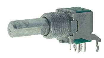

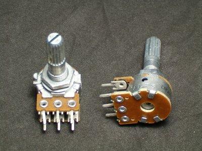

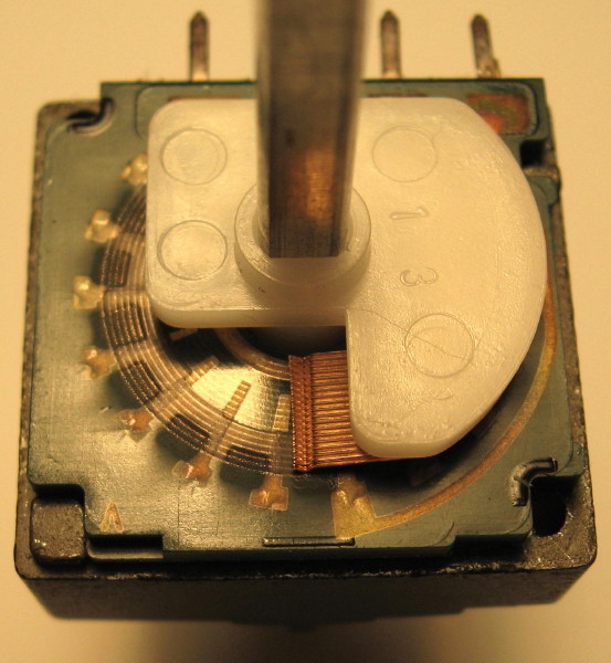

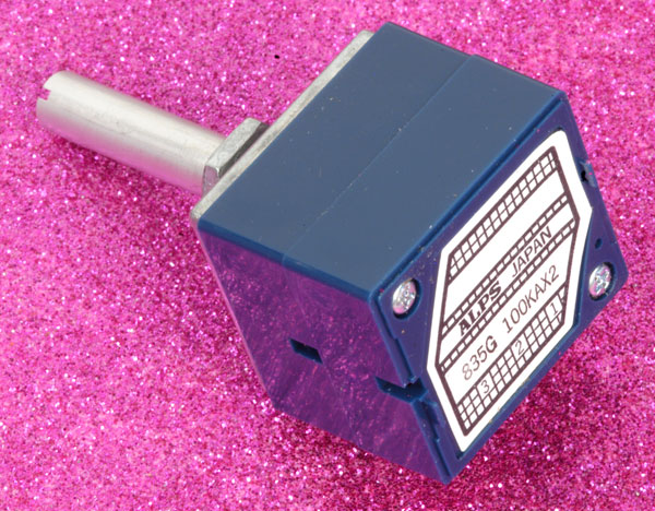

there are two screws at backsite on the blue alps potentiometer, but I can only remove the backsite. Unfortunately I cannot disassembly the whole device
because there are no removable elements on the shaft
I need a version special made for complete dismanteling to cleaning and polishing the contact aera and the brushes. Who knows more about such potentiometers?

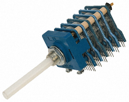

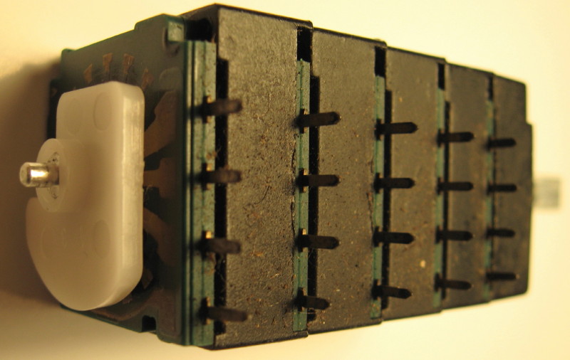

I need potentiometers for disass'y in the same mounting kind than follow rotary switches:
http://www.lorlin.co.uk/PDF/PT.pdf
I know only "one-way mounting" versions like the following pics (start at image number 2).
By the blue version there are two screws, but no removable elements on the shaft, unfortunately covered by the white type sticker.

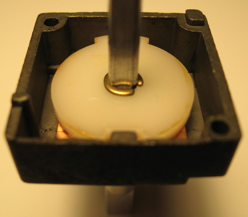

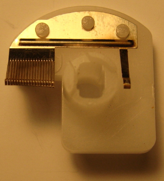

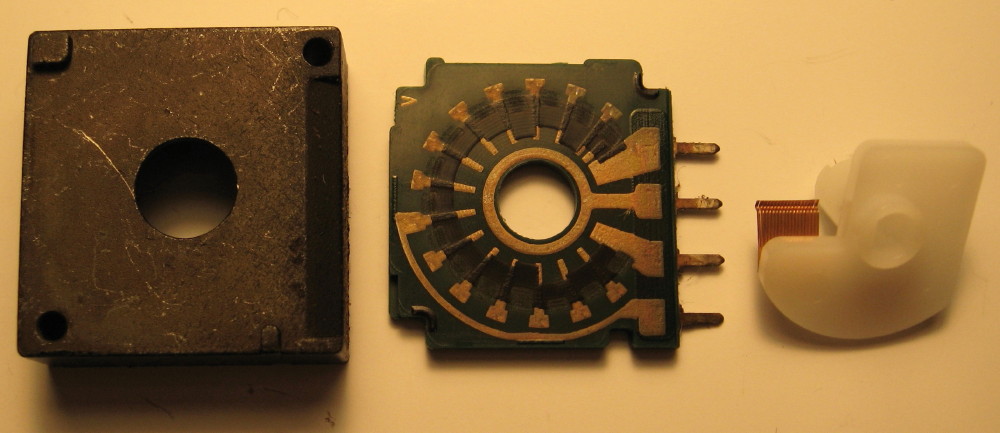

It can be disassembled though.![]()

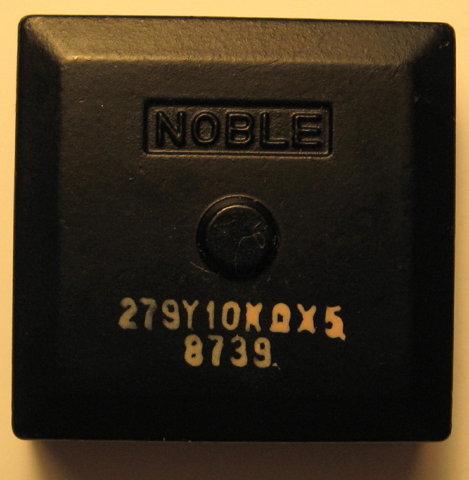

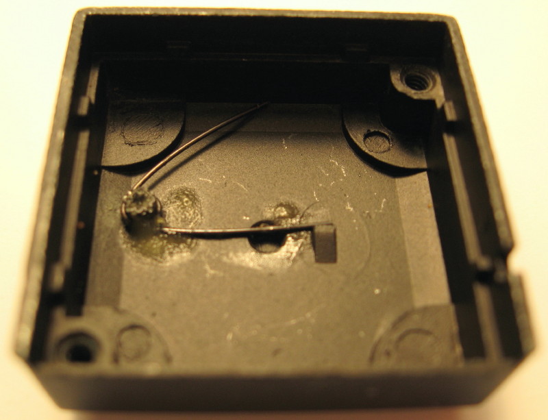

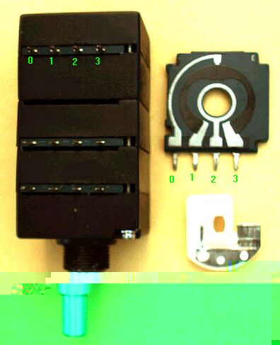

A precision device - indeed. And very good suited for disass'y and cleaning. The costs of this small amp model at whole (Cambridge Audio A1) are approximately half of that one of the potentiometer.
NOBLE potentiometer guts
Here are a few more photos. The whole potentiometer is easy to break down.
thank you very much for the pictures. Unfornately the available types are obviously "New Old Stock" and no longer in currently manufacturing.
