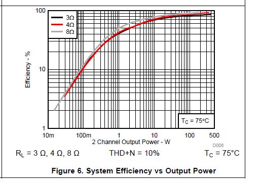

Hi
If you look at the datasheet of the TPA3251 for example you will see that the efficiency of a class D amp is much better at medium/higher power level. so if you play about 1 W(or less) the efficiency is not very good - so the chip get in relation hotter.
chris
chris
Certainly true. But efficiency over that range is far superior compared to class AB. In reality a battery lasts much longer feeding class-D than class AB.
This article suggests class D at practical levels has about an order of magnitude lower power consumption than class B, and class A is more than an order of magnitude worse than class B.
Class D Audio Amplifiers: What, Why, and How | Analog Devices
Class B doesn't get any decent efficiency till near max signal, class A is never remotely efficient ever.
AB is notable worse than B at low volume (defining class B as Doug Self does).
Class D rules efficiency comparisons totally until you add classes G and H into the question. A typical class D dissipates less at its full rated power than a class B dissipates on no-signal.

As all seem to agree, at high power class D is the winner. Less need for a heatsink. At normal home-listening levels, the difference is less because also class D has important idle losses from the carrier.
Class D has an important advantage with varying speaker impedance because the supply voltage is converted to the energy needed at the speaker with Buck converter efficiency.
Class D or class AB will not save the planet with normal use. Less heatsink is important for the physical design.

A weakness of class-D is that the output devices are hard switched so energy stored in the Cds is lost. Some higher power amps (Powersoft) vary the rail voltages to reduce the energy loss at low output and some other amps have multiple rail voltages (TI boosted class-D, Infineon MERUS). First Look: Infineon MERUS MA12070
– QuantAsylum
R&D Stories: Future Shock. Powersoft Audio’s Amplifier Technologies | audioXpress
Plain class-D is no longer the most efficient available design.
