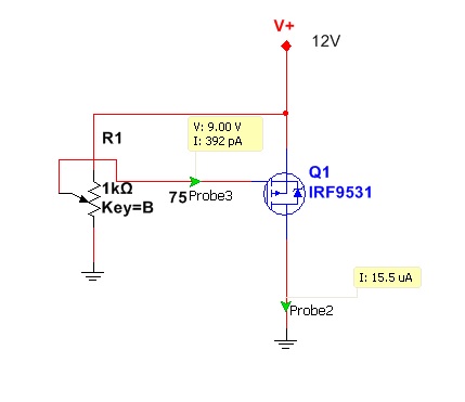

I was simulating yesterday a few power MOSFETs, academically, just to see how they work, and whether they provide an advantage over a complementary transistor push-pull AB stage, or using them instead of a pass darlington transistor pair, and I have discovered that depending on the MOSFET used, they typically drop from 3V to 6V on the Gate to Source.
That means that it will be impossible to get close to the rail(s) ans that would preclude their use for whichever application requires output voltages near the rails.
Have I got that right ?

The FET gate-to-source current is ideally zero, and in that case there would be no voltage drop. The gate is electrically insulated from the source, so I'm unsure of your simulation setup which led to your hypothesis. But a high side FET driver can definitely put a load at very near the supply voltage.

But the high side gate driver is required precisely because the gate must be brought several volts higher than the source in order to get that saturation you write about.
akis, your simulation is correct.

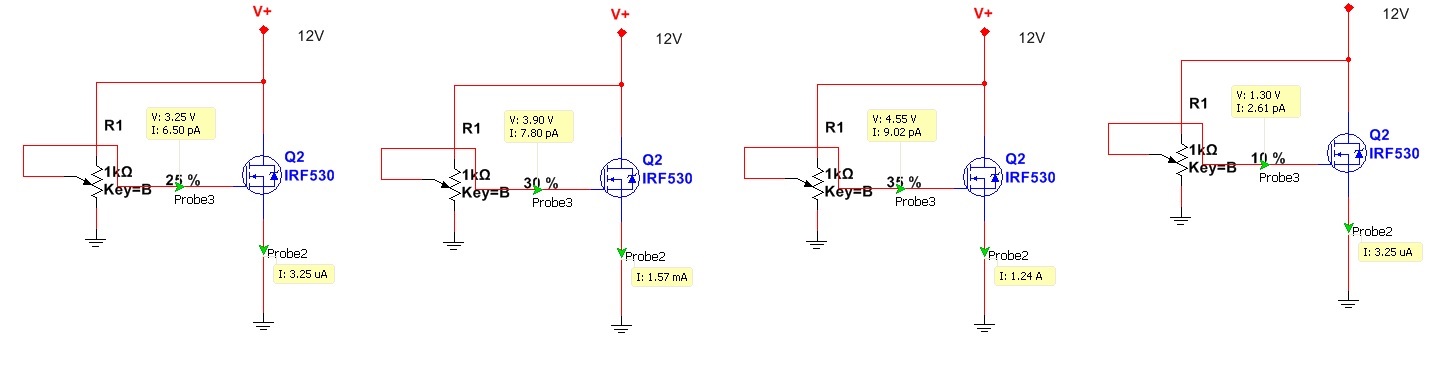

Here are some pictures of what I mean: there are 4 simulations, the first and fourth show no current passing through, even though we have a hefty voltage at the gate. The MOSFET starts to open at about 3.9V. Very similar, or worse results can be obtained with other MOSFETs I have tried. A comparable transistor would only drop around 650mV.

The MOSFET needs a certain Vgs to conduct, so if you use a follower conficguration, the highest you can go on the outout is then the gate is at the same potential as the drain, i.e power supply. How much voltage drop there will be depends on MOSFET treshold and transcondutance, i.e. the current you need (more current = more Vgs is needed, but unless the treshold is crossed practically no current passes at all).
For regular vertical or HEXFETs, it takes about 6V Vgs to get the to conduct full current at that same voltage across Vds. The only way around that is using an extra power supply of some sort (this includes bootstrapping) to get Vg 'above' the rail the drain ios tied to, in effect making Vg more than Vd, so that you can produce the requied Vgs even when Vs is almost equal to Vd i(which is itself tied to the power rail).
The alternative is to use a common source conficuration where the source stays tied to the supply rail and Vgs is always between the supply rails up to the required voltage for full conduction. Alternatively you can use the inverted common source where the sources are at ground potential, and the drains are tied to a floating power supply where the midpoint of the power supply is the amps output.
