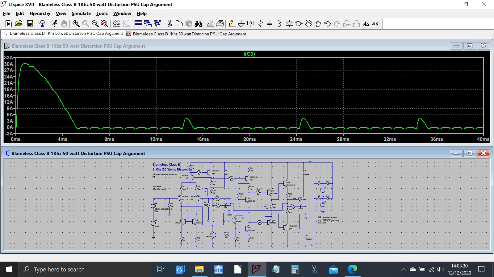

I have a simulation of a power supply and amp set up. This shows the current in one side of the power supply (the reservoir cap) and the cap is just 2200uF in size.
You can see the 1kHz audio flowing 'in' the cap and also the larger charging pulses. First image is at around 1 watt output and second image at nearer 50 watts.
