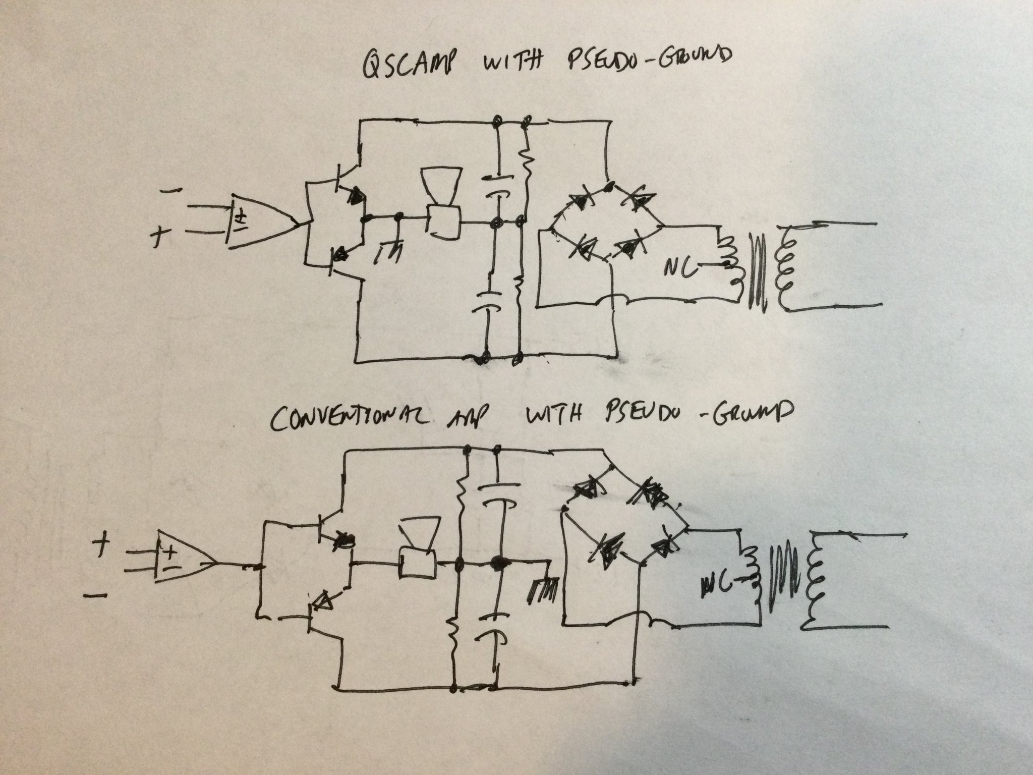

You can do what QSC did with some of their early power supplies - make a pseudo-ground for AC signals. This does turn the amplifier into a cap-coupled design, but not a problem if you just make the caps big enough. 22,000 uF is about right - since the effective value is half that. Too small and the “ground” bounces around all over the place when playing heavy bass.
Even though your amplifier topology does not require separate power supplies for each channel, I would if I were doing this. That will prevent any ground bounce from one channel from affecting the other.
Yes, you could do the QSC circuit, but there is no ground connection between the QSC power supply and ground. The normal "output" is ground and the whole power supply is driven, the center of which is the speaker output. This simulation shows two possibilities using op-amps:

wg_ski - that was the circuit I had in mind. I should have drawn a picture. I hadn't realised it had been used before, so that gives me some comfort.

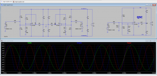

Hi Steve
Our posts crossed again. Thanks for the analysis. However, the op-amp simulation is a little above my pay grade. Are you saying the QSC power supply circuit has significant limitations that point away from using it with the type of amp circuits I have in mind?

The QSC circuit requires a separate PS for each channel, but that is not a problem for you, right? Another advantage of the QSC circuit was that the drivers need not span the supply rails, so an op-amp IPS was a great fit. But I don't know of any QSC style kits.
The QSC amplifier circuit requires separate power supplies for each channel. The older models also used the power supply in post #7. Newer ones used a conventional center tapped transformer - that was a requirement for the class H models.
The amp circuit and the supply with the pseudo ground don’t necessarily have to be used together, they just happened to be in the older QSC amps. That same power supply will work with most amplifiers, but it does effectively convert it to a cap-coupled design. The reason QSC used it was the effective cap coupling. A shorted output transistor would not send DC to the speaker.
A regular cap coupled design can be simpler, and is easier to understand. The circuit in post 6 is a lot easier to build and tolerant of mistakes. I’d increase the output cap to 10,000 uF, and use the same in the power supply, but thats me and my bass talking.
Sorry but this is not what QSC does.
They ground the speaker out and supply caps centerpoint is actually "hot" speaker out.
Of course you can not ground that point under penalty of shorting speaker out.

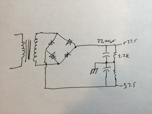

I used the split supply using transistors to get the ground for a circuit I designed.Either works equally “well”. Same strengths and weaknesses apply. Without the center tap connection you are at the mercy of voltage division between the two caps. For DC, the bleeder resistors enforce balance. For AC, the caps’ impedance needs to be “low” or that center connection moves around. It was good enough for 1980’s-vintage QSC’s. But they were not considered Uber-hi-fi, just fairly reliable.
I didnt want to use two wall warts so used one 24 volt DC supply and split it into two 12v supplies.
Worked well, but I dont know how well it would work for a power amp that takes a lot more current.
I would LTSPICE it to be sure.
The resistor divider isn’t what really splits it - it’s the job of the caps which handle the amps of ripple current. In that old QSC I had, the “ground”, or rather speaker out, did bounce all around with the woosy 3300 uF caps. Put a zero on the end and presto - no more bounce. The resistor divider just enforces voltage balance for DC - same as when you stack caps for voltage when making 600 volt supplies.Splitting the single supply with a 2.2 k or 3.3 k resistor divider is pretty wiimpy. Speaker ground wanders all around. As that happens speaker current is limited which may have its own sound. When Frank Beard whaps that bass drum you want a big current surge to the speaker. AX6 senses the center voltage and pushes it towards the middle with feedback to the input transistor , at a cost of a couple of resistors.
I wouldn’t do this with anything putting out a crazy amount of power. But it is a workable solution for an amp which wants split supplies and draws a symmetrical quiescent current.
