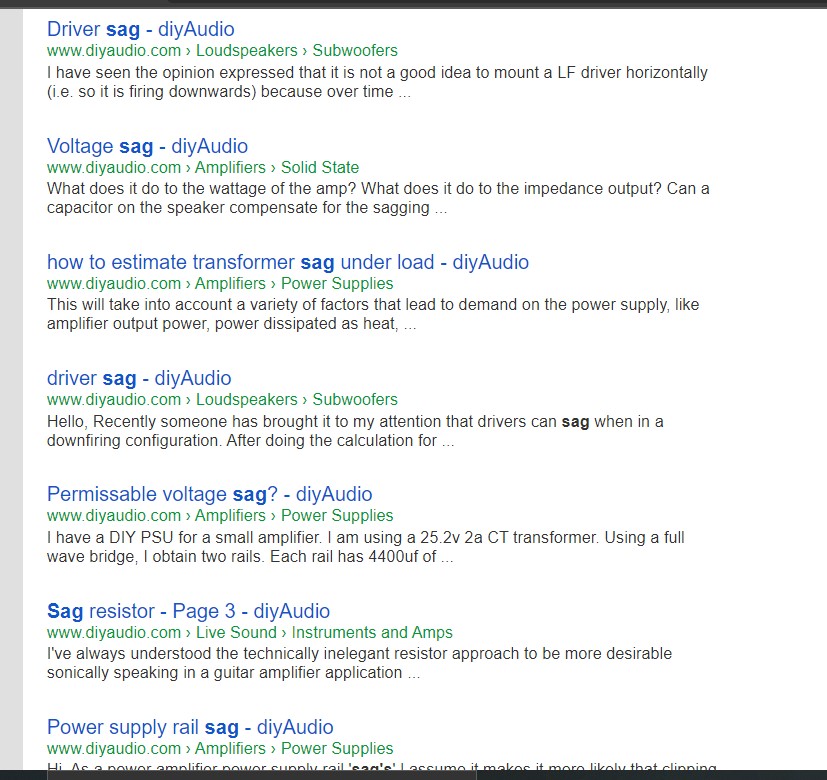

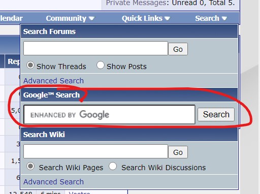

Thanks Mooly, the google search works a lot better. And now I know that people worry about sagging downward-facing drivers too 🙂
