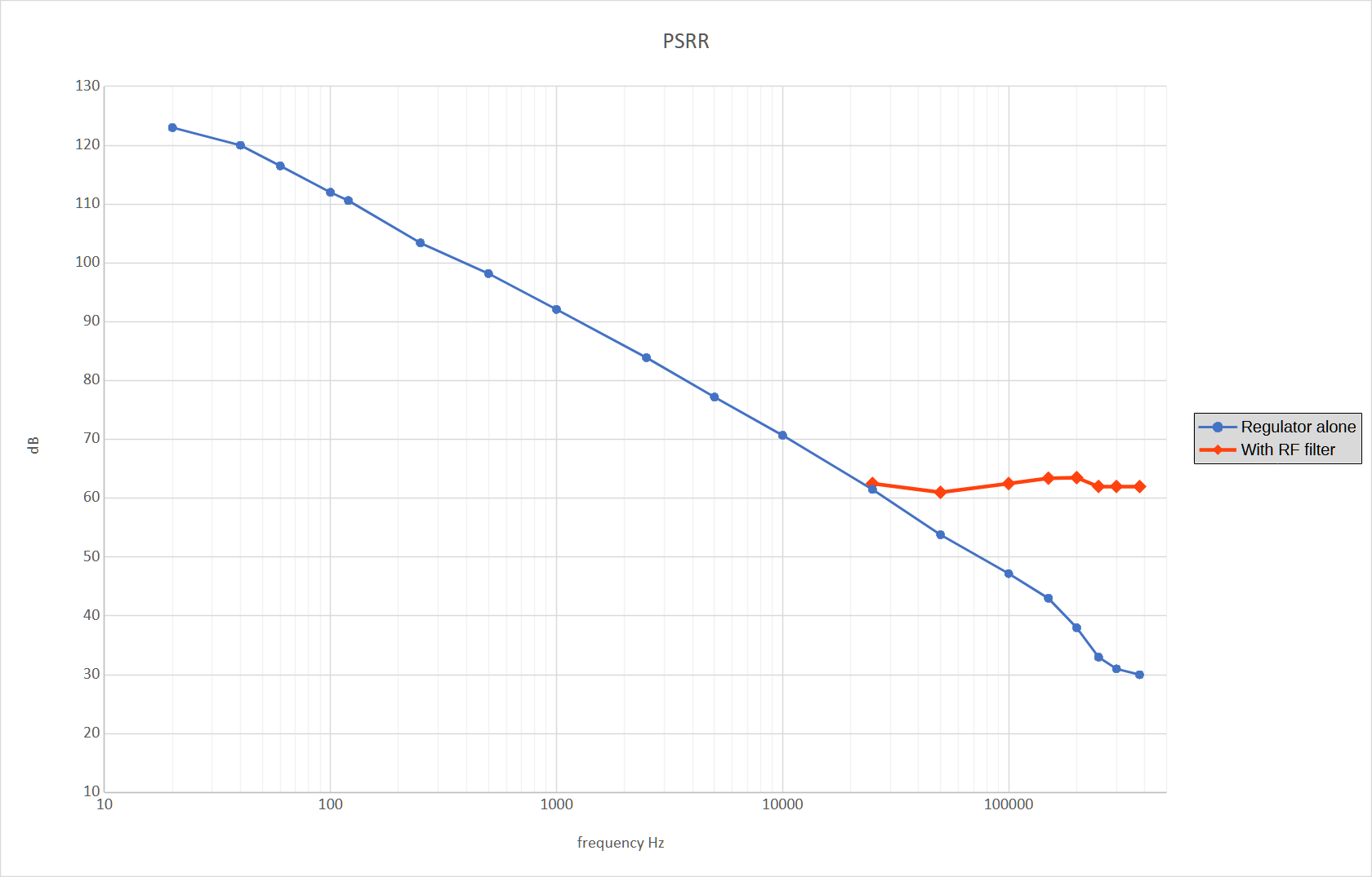

PSRR
It is a little better than with R21 at lower frequencies, but RF filter contributes to big difference at HF. Filter effect starts to show above 25 kHz. As regulator PSRR is falling at 6 dB/octave slope and filtering is increasing by the same, we get flat PSRR from that point. Checking filter datasheet, PSRR could remain at 60 dB up to GHz frequency.
Measurements are a little wiggly above 100 kHz, as voltage regulator input, at those frequencies, presents an almost short circuit to the signal source.

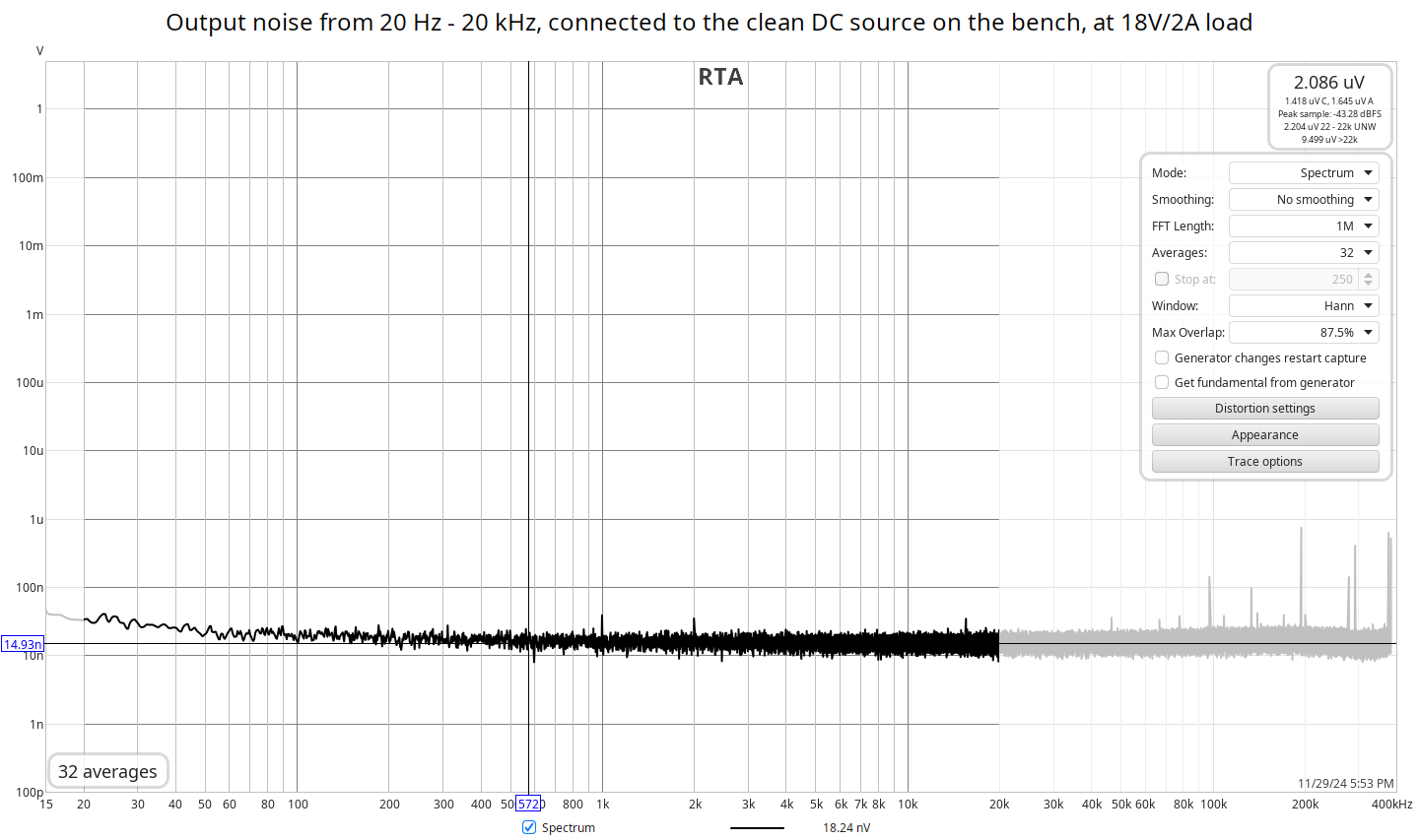

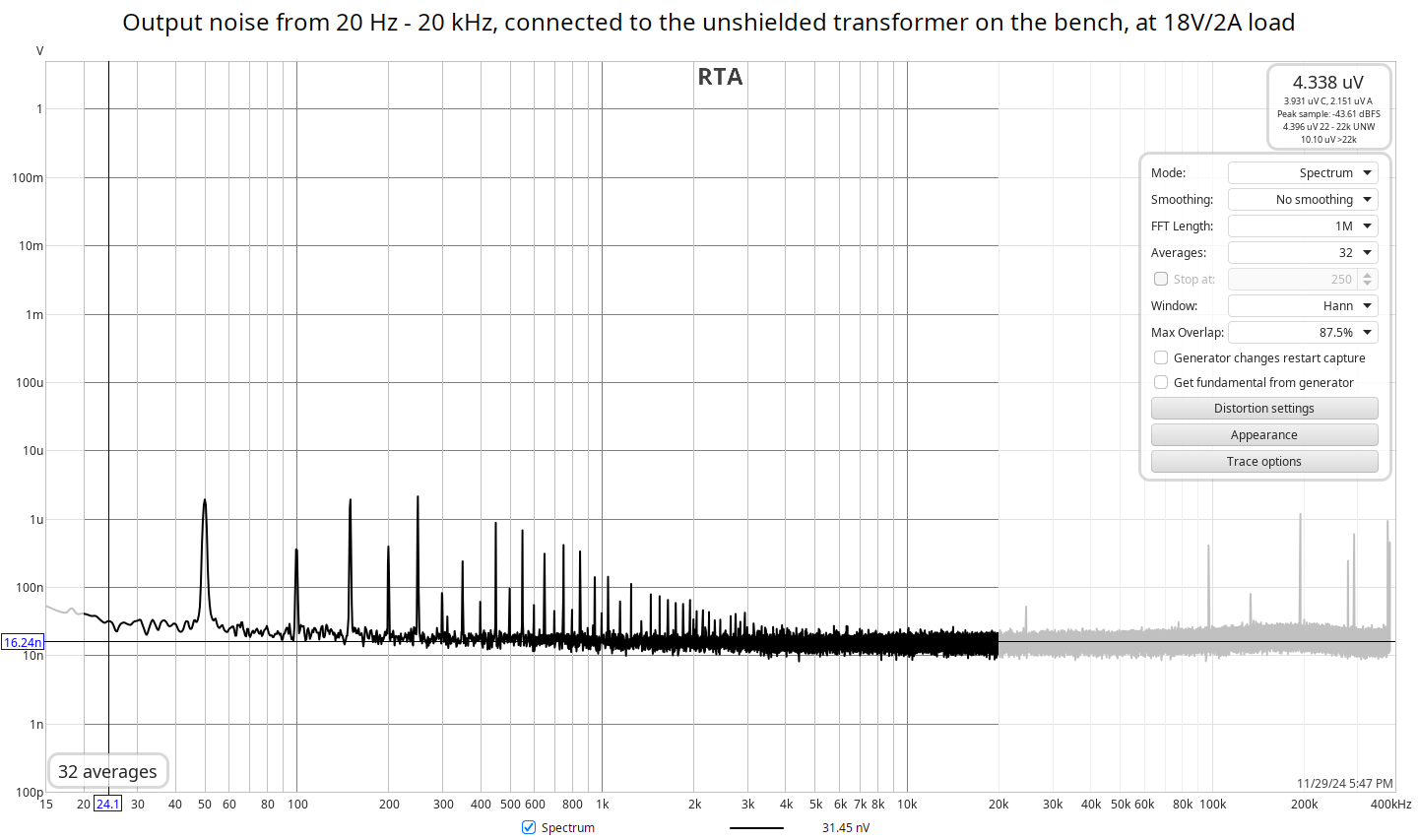

Noise
Self generated noise from the supply is only 2 uV in the 20 Hz – 20 kHz bandwidth. With ordinary transformer and no additional mains filtering, you can expect total noise to be less than 10 uV. In example, using crap transformer and everything close and open on the bench, I’ve measured < 5 uV.

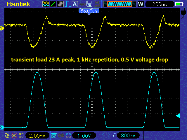

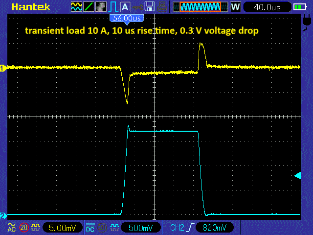

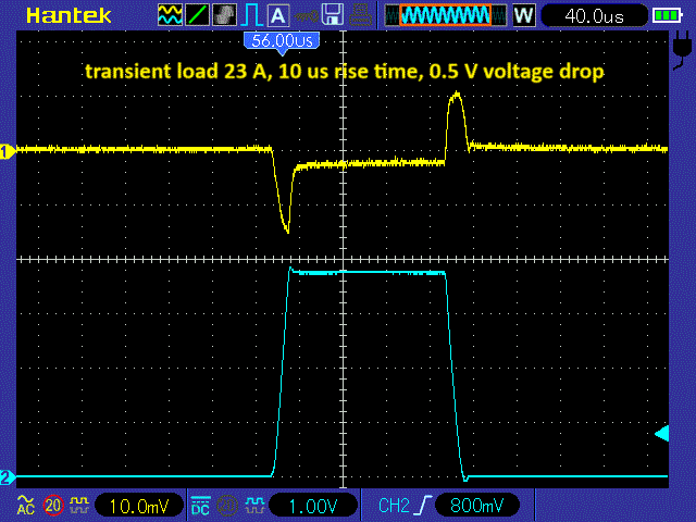

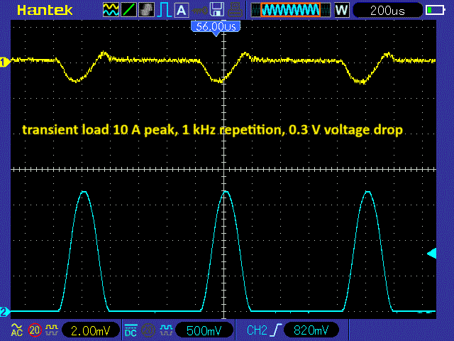

Transient response
Measurements were taken with high and fast changing load current, with rise time of 10 us, which corresponds to fastest possible audio signal. 20 A transients are ‘nothing’ to this supply.

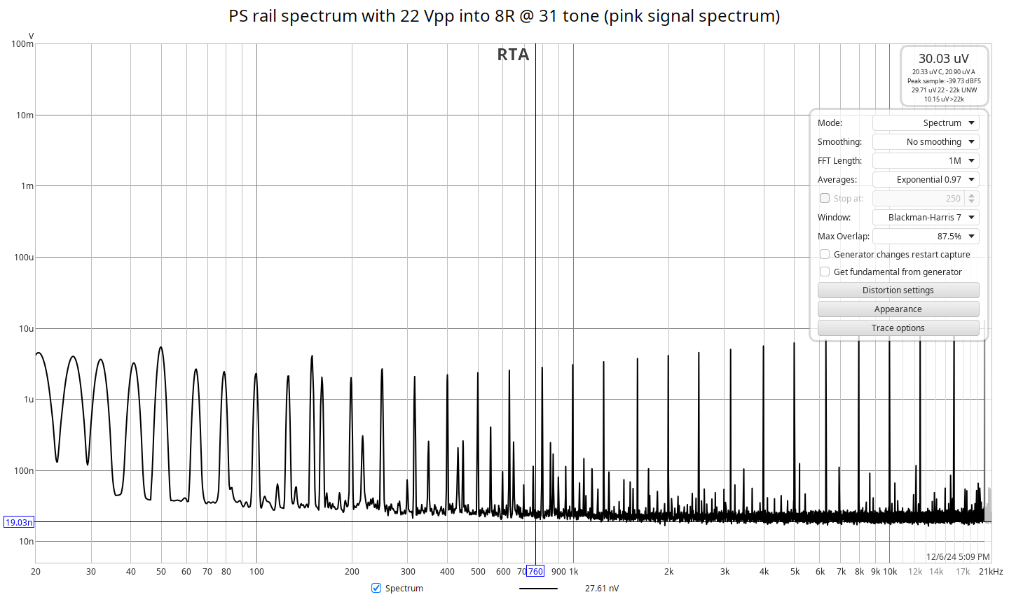

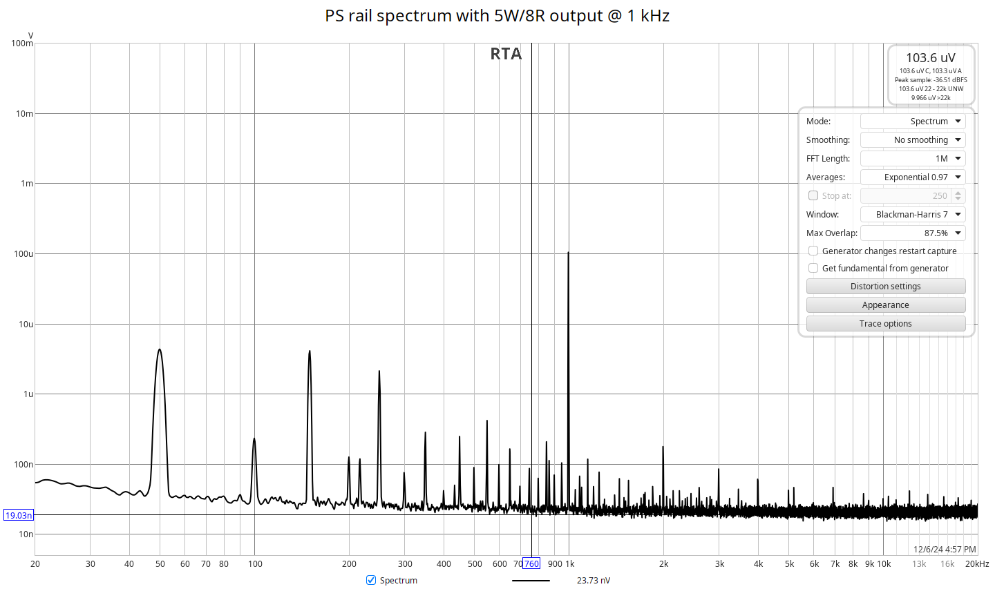

I’ve included output measurements with FFT analysis to check for harmonics and output modulation by a real amplifier load. First, single 1 kHz tone to check for harmonics introduced by supply. Next, 31 tone with pink power distribution, which is similar to the real music signal.
There is nothing of concern. Output modulation by load, for any power supply, is a simple product of load current and supply output impedance at specific frequency, and harmonics are a product of supply non linearity. We have here harmonics at residual levels of used equipment (LNA and ADC distortion).
I’m sure that everyone has heard of power supply or capacitor sound. Power supply can affect powered circuit output by noise and by not keeping its output constant at any load and frequency. Powered circuit has its own isolation factor between supply and output (PSRR) but it may be low for some circuits.
This supply is in practice pretty close to the ‘ideal power source’.

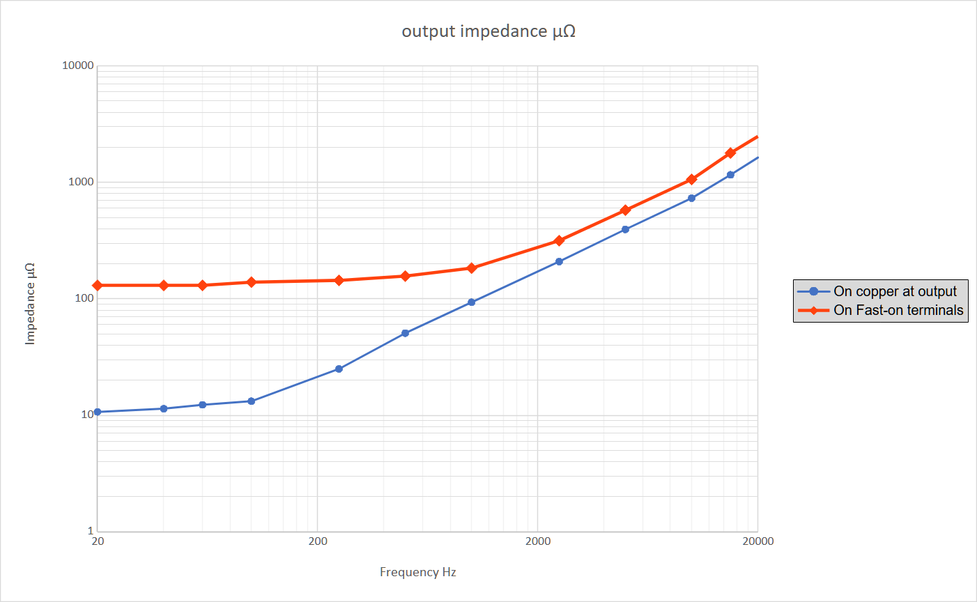

Output impedance
Output impedance includes PCB tracks to the output and solder + Fast-On connectors resistance. There are two measurements. One at the copper direct at output terminals and another on top of soldered Fast-On connectors.
