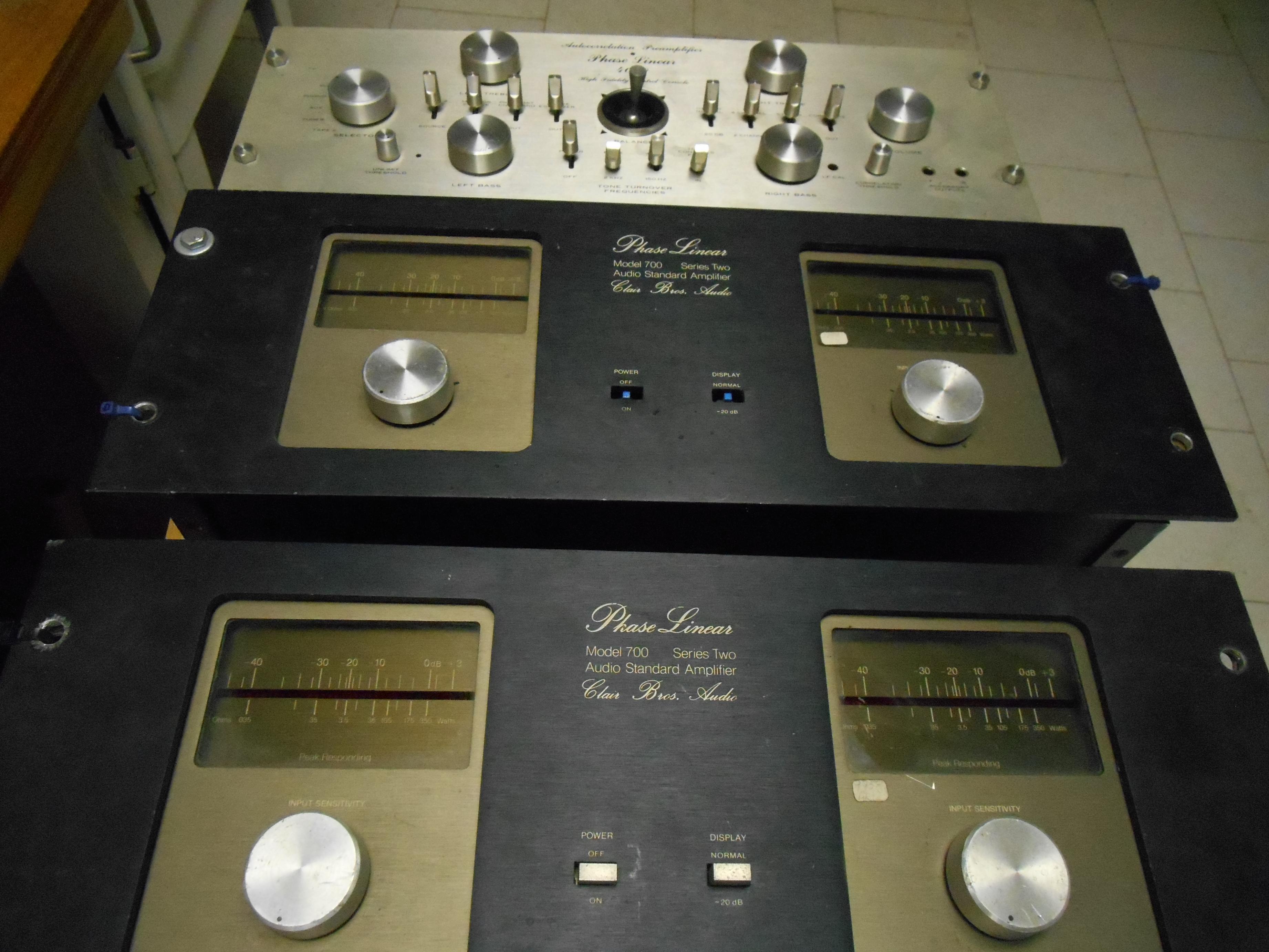

I am rebuilding a pair of Phase Linear 700 series II's with new White Oak Audio control and back-plane pcb's. With most of the mods completed on the first amp, I am measuring a voltage 'coupling' or leakage between the primary and secondary.
With a Fluke DVM between the primary coil (neutral side) and the secondary winding centre-tap; there is 62 VAC, dropping to 43 V when the meter is shunted by a 1 Meg resistor...and down to 0.64 V with 10k shunt.
Just wondering if anyone has issues with primary to secondary leakage in power transformers, acceptable limits, etc,
Thanks and Happy New Year, Peter in Canada

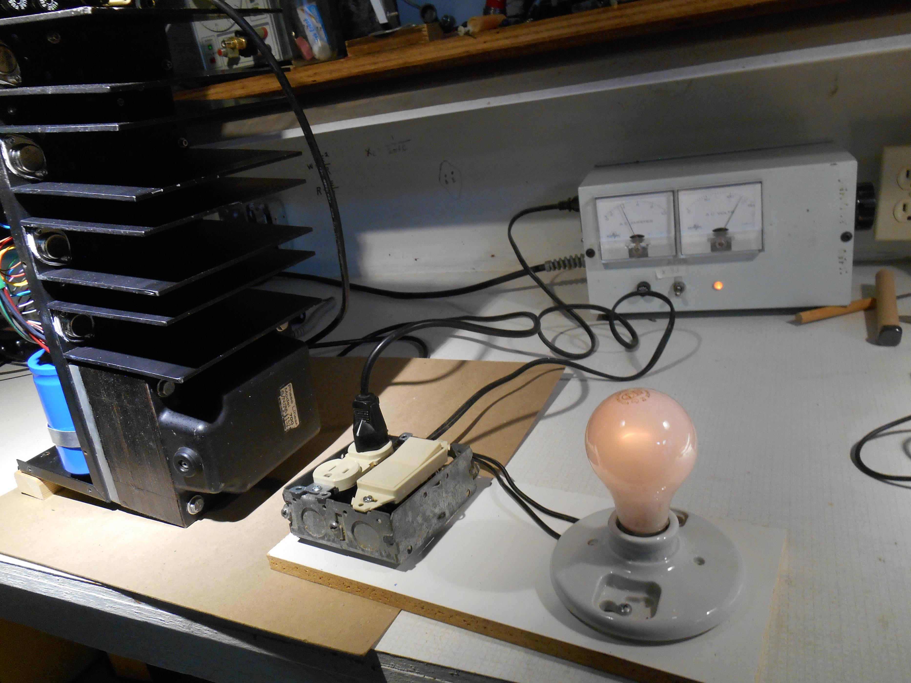

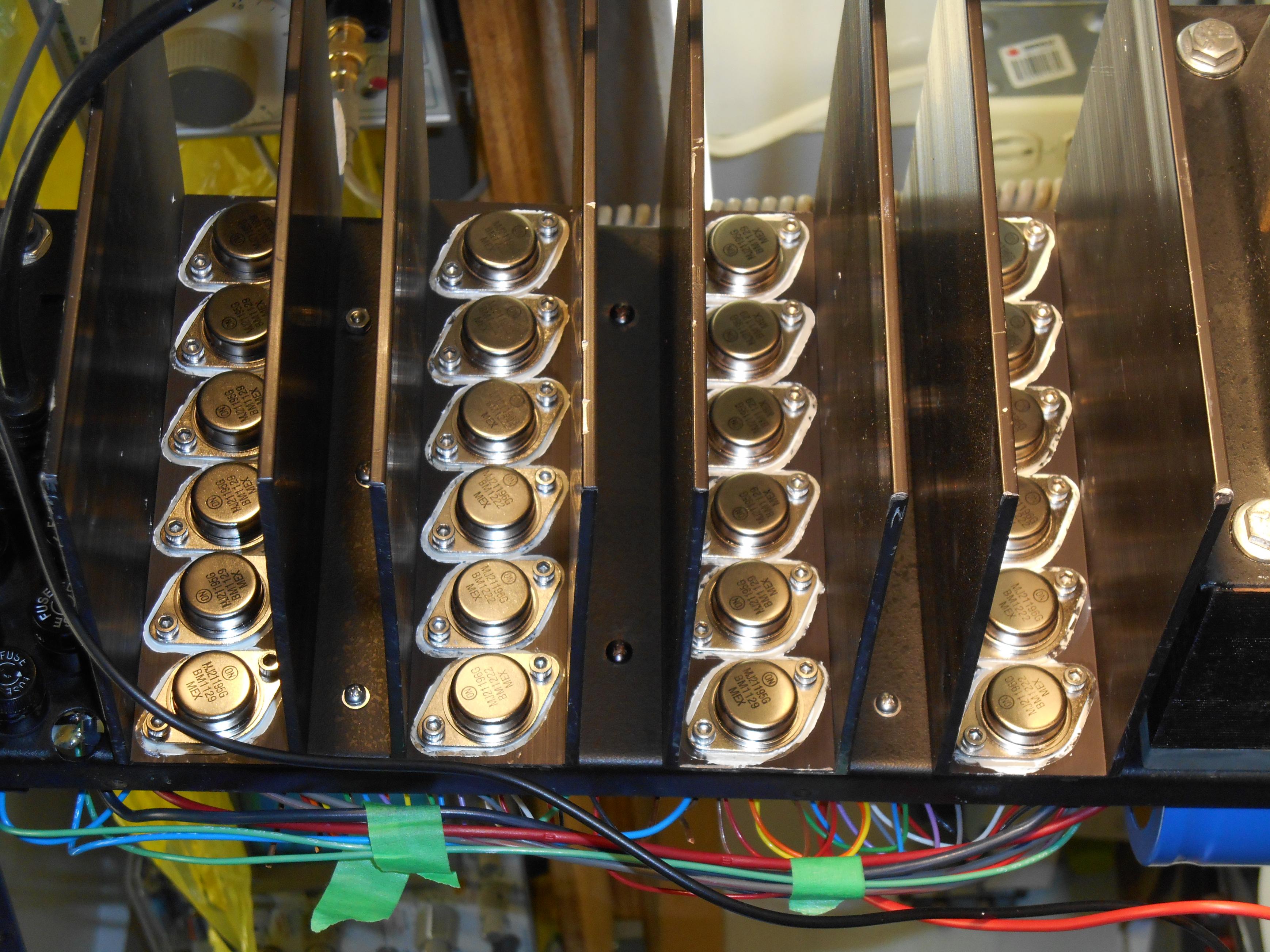

Here; all was going well with new PCB's and outputs installed. Amp was powered up OK with Dim Bulb Tester but when my signal generator ground was connected to the input ground, a severe hum was introduced.

Do you have the amp on a line isolation transformer?
This sounds like a bad ground loop which could damage a fair bit of stuff.
How not to blow up your test equipment
Hi Doug;
I am not using an isolation transformer. Don't all transformers isolate, unless they are auto transformers? 42 VAC across 1 Meg is a leakage current of 42 uA. Could this be acceptable?

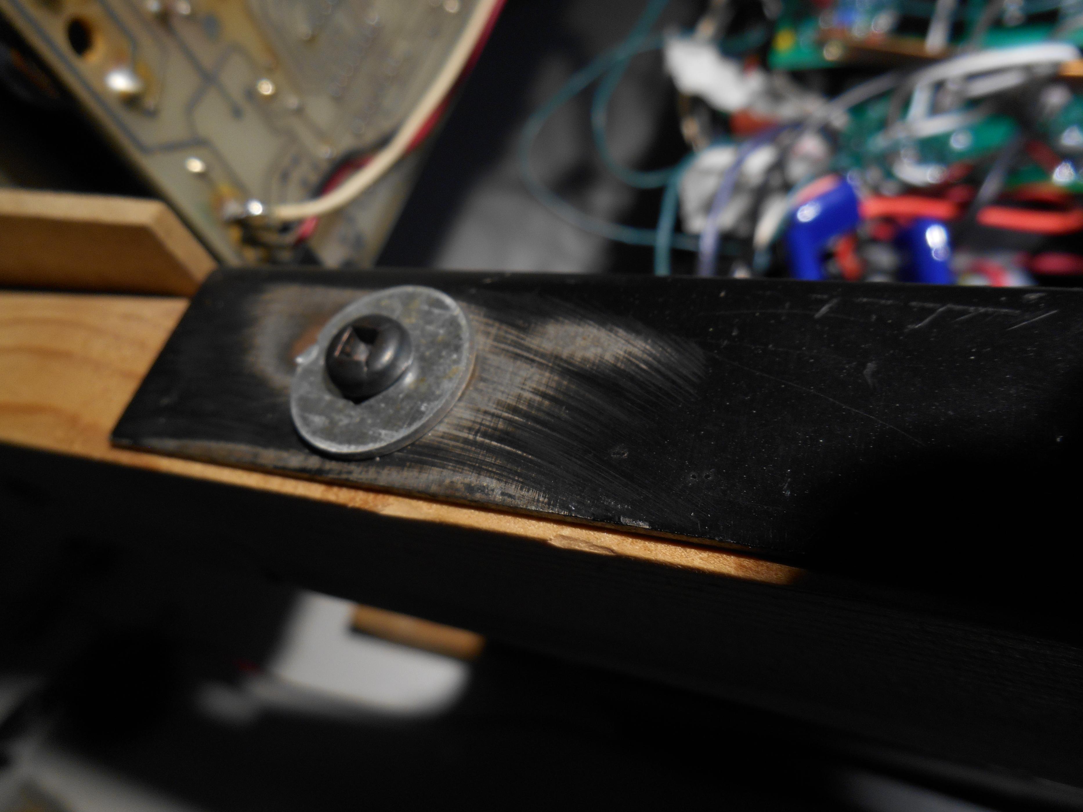

I've triple checked the input wiring. The original PL had all grounds tied together at the input jacks and speaker negative posts. The new White Oak mods have the input ground separated from the main ground by about 10 ohms. So this leakage would across that 10 ohms (adding to the input signal). The Leader signal generator has a 3 prong plug (closing the ground loop).
Honestly, I couldn't be sure if the Volume control had an effect on the hum level, pretty sure not. It was such an incredible level, I could smell the voice coil of my 'sacrificial' speaker. In an attempt to trace the cause of the leakage, the transformer was separated from the chassis. With the transformer mechanically and electrically separated, there was still 62 VAC from the primary to secondary centre tap (still dropping to 43 V when shunted by 1 Meg)
I suspect that the amp would behave if the chassis was securely grounded. Note the sanded rack tabs, maybe this has been a problem before(?)

if somebody tried sanding the rack ears to reduce ground noise via a better common connection they where barking up the wrong tree imho...

When you connect another piece of equipment to an input and get such a violent reaction, you can be pretty sure that's a ground conflict.
There are several possibilities... your dim bulb unit could be floating the chassis of the amp 40 or so volts above ground, then when you connected a piece of grounded equipment a ton of current would flow... producing the monster hum.
Another possibility is that the socket for your dim bulb is reverse wired, causing a difference in potential between the amp and the rest of you equipment... same result, dangerous races of current.
Yes transformers isolate... but in most 3 wire cords the ground lead is strapped to the chassis... and so is the 0 volt rail from the secondary. No more isolation. Ordinarily not a problem, so long as neither of the above are true.
A dim bulb tester will allow you to power up a piece of gear under test at minimal power... but it is NOT a line isolation device. For that you need what is called a Variac... a variable transformer that isolates the device from ground.
Follow the link in my first post (it's in red) and watch Dave Jones explanation of how this kind of thing can and does blow up amps, test equipment and sometimes people. He's not kidding, this stuff really does happen.
THIS line isolating variac tranformer is what you need to do the job properly. (Click on the word "this")

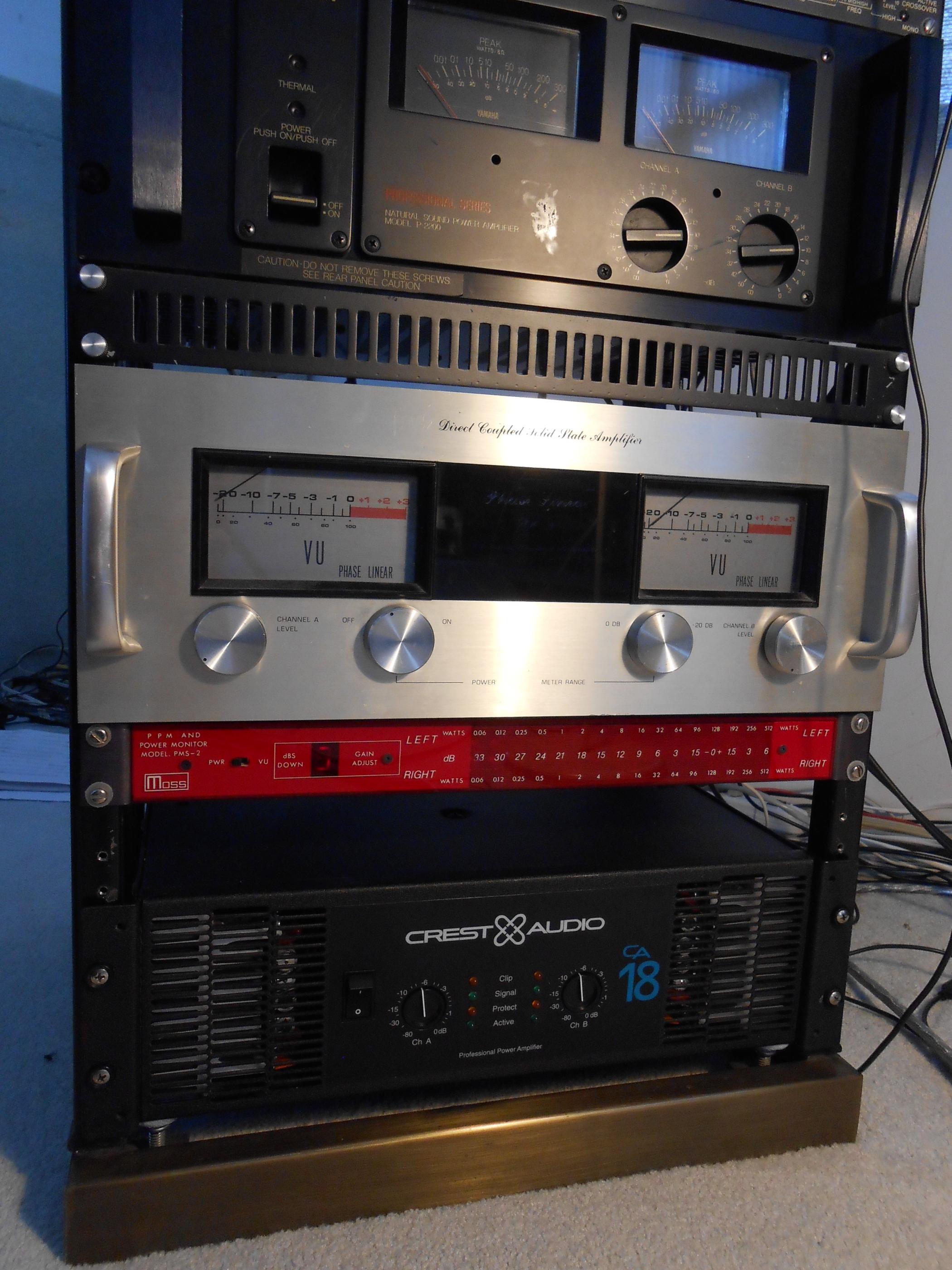

My first Phase is an original 700, bought from "Triumph" and still have it. My system is 3 way active and everything in the rack is mounted with plastic shims, sleeves for rack screws, and plastic washers. The original 700 and the current 700B are dead quiet with the chassis floating. Yes, they all have a direct/ normal switch which inserts a cap in the signal hot path. I don't believe they have to do with anything ground-related.

I have a variac (pictured in the background with Volt and AC ammeter. Thanks for pointing out that the Voltage drop across the bulb could cause a mess. I wired the 'DBT' with the bulb in the hot side of the line. It also has a bypass switch. The DBT was just 'in-circuit' as I was installing each row of output devices.

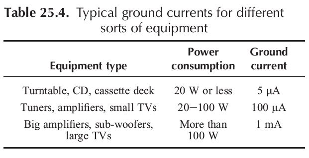

120V dropped to 40V in 1Meg implies 2Megs leakage.
This is "zero" for practical purpose. Safety code isn't interested until current is 100X higher than 42uA.
1.4nFd or 1,400pFd would leak 60Hz this much. That's a BIG transformer. 1,000+pFd seems quite reasonable to me.
It is common on anything with digital in it to have 0.005u or more line to chassis. 0.05u was acceptable to ground 2-pin guitar amps (this apart from the more dangerous things done in that market). 50,000pFd!! Thirty times more than you observe.

I am at a stand-still at the moment. I would like to put the amp back together and experiment with grounding the chassis, but before that, I would like to feel a little more confident that the transformer is healthy. Douglas Self claims that the lines ground should be tied to amplifier ground at the input ground. Sounds like the original PL, Input ground tied to output ground and Centre tap bus, but obviously no mains ground. Grounding the input shell to the output ground is not going to be a consideration with the White Oak upgrade.
