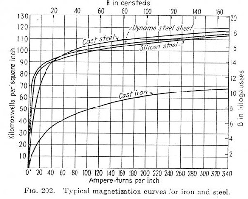

this is the magnetization curves of a traffo, flux versus magnetomotive force...
for as long as you stay below the knee of the magnetization curve, about 70maxwells/square inch, then the traffo should be fine....
i design my traffos well below the knee and that idle magnetization is quite low...
it is therefore easy to see that as more current is drawn, secondary current causes more magnetomotive force....since the turns are fixed and the magnetic path length is also fixed, therefore the current flow cause the increase and gets the traffo closer to saturation....
this is not all, inputting higher voltage in the primary than what was originally intended with the primary turns likewise causes core saturations, we have seen a lot of accidents that happened when a traffo designed for 110 was inadvertently plugged into a 220 wall outlet...
