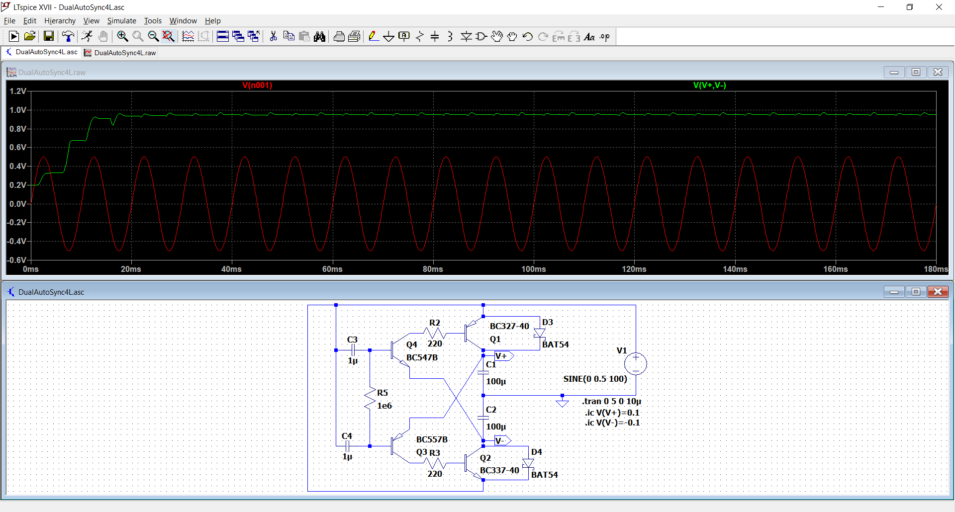

I think I have posted somewhere (on this forum) an example of efficient, speaker-powered vu-meter, but I am unable to locate it.
A single pilot light should be simpler, but the difficulty is in dealing with low levels: a volt or two into a normal speaker already makes a lot of noise, meaning the circuit needs to be sensitive, and operate for a wide dynamic range.
I have developed a number of active rectifiers, capable of starting at very low voltages.
This example already operates at voltages <0.3V rms, and provides a ~lossless, doubled voltage:
attachment.php
Of course, 1V is not sufficient to operate a visible LED, but one could convert the circuit into a quadrupler, or more.

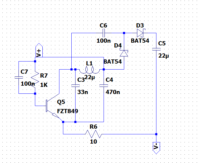

A simpler option is to use a matching converter, capable of operating under 1V. I have developed such converters, using one or two transistors and a single ordinary choke.
Here is an example:
attachment.php
To cope with the dynamic range, one could use a FET-based CCS to control the current in the LED.
If you use a blue or blue-derived one (white, ultra-green, etc), you don't need more than 100µA or even less to get a sufficient brightness.
With germanium transistors, the circuit could start with only 150mV AC

The duty cycle of real music would be a killer here Elvee. Your circuit is super neat :up: but imagine it delivering 100uA to a load with a 5% duty cycle that reaches the 0.5 volts needed.
And that is still really loud on most speakers.
I suspect a signal transformer might be needed to boost the voltage.
I don't think this is a problem: a quick calculation based on your figures shows that the peak current would need to be 2mA, assuming 100% efficiency and no voltage transformation.
Factoring in a 1:5 transformation ratio and 50% efficiency would push the peak current to 20mA, something a 8 or 16 ohm amp output could easily provide.

If you design the circuit to operate at a duty cycle of 1%, with large enough smoothing caps, it could rely on the odd bass surge happening from time to time and still require ~100mA peak, which remains manageable.
The best solution would be to replace the Si transistors with Ge ones: with a 150mV sensitivity and the peak factor of normal music, the LED would remain lit for reasonably quiet listening levels
