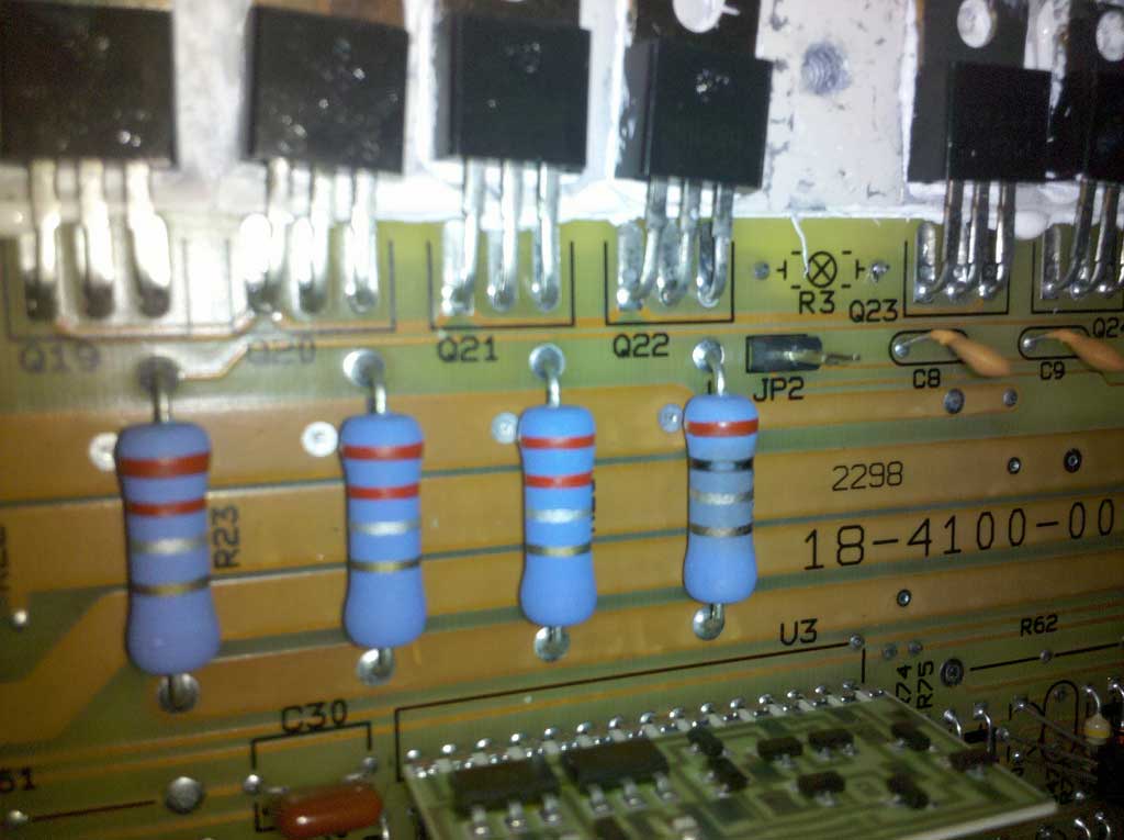

It is a 0.22 ohm 3 w metal oxide but if it is burnt then the output device to which it is connected is bad.

Thanks. Also I have a old school soundstream reference 10.0 amp that has a blown mosfet I believe it is a Motorola tip 109 mosfet looked everywhere for one and can't find one if anyone can shed some info that would be much appreciated
