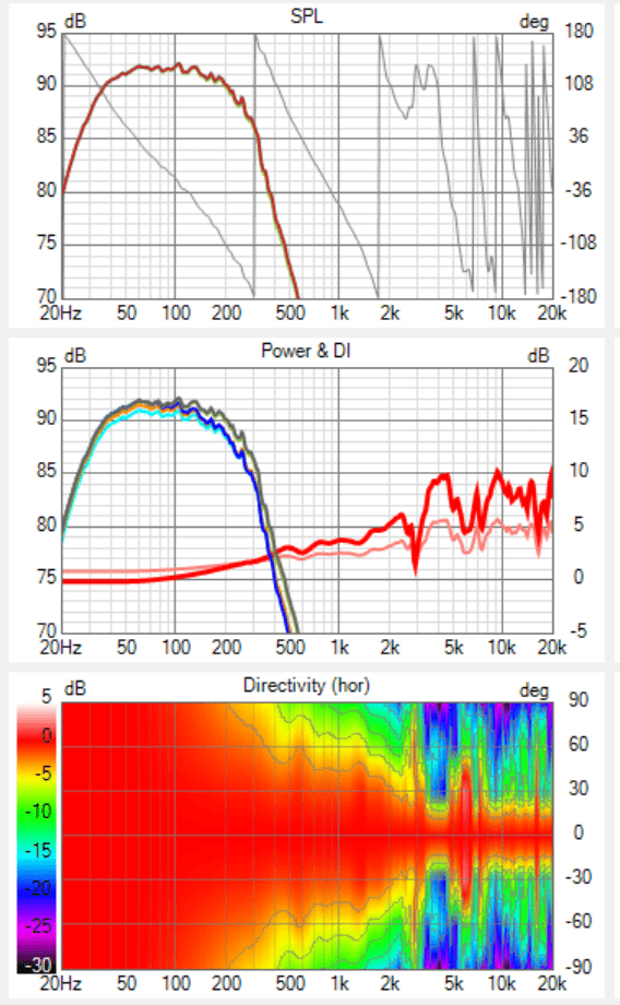

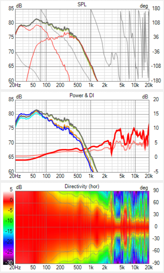

Here’s something I prepared earlier.
A lower woofer is measured in the nearfield and farfield, and merged as per VituixCAD2 manual instructions, including the simulation of baffle diffraction simulation, where one woofer represents two. Check the manual Measurement with CLIO or ARTA or REW or SoundEasy for details
Here’s the response after filtering.
I "moved" the lower woofer to the back panel by putting (Z=400) (depth of the cabinet) and reversed the phase on that woofer, then performed a quick and dirty copy of all of the DSP setting that kind @vineethkumar01 shared in his post
With a bit of fine tuning I could sculpt it a bit more, but this is what it looks now. As you can see there is an additional octave of directivity control.
