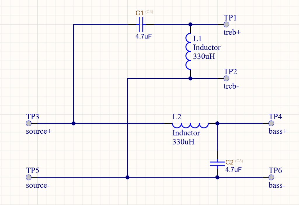

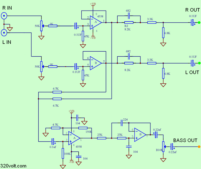

I want to build a 2-range speaker system (treb and sub). I came across 2 circuit diagrams. One uses a preamp to filter out the frequency and then connects to the amplifier.The other one does this using a crossover.
What is the difference between a preamp and a crossover when it comes to filtering out the frequency?Which one would work best in a small speaker setup?

The 'preamp' you mention is normally called an 'active crossover', the LC crossover being called a 'passive crossover'.
The choice between the two is really up to the designer, both can work very well but the active crossover gives more opportunities for noise to enter given the extra opamps.

With one more addition, active crossover on picture is not replacement for passive crossover on second picture.
This active crossover only separates sub frequencies from full range L &R out. L& R out still have all frequency on it's outputs. Passive crossover on second picture separates highs and lows on each output.

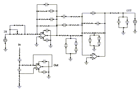

Furthermore, any active circuit quickly becomes more complex in case -in addition to "plain" filtering- equalization of midwoofer peaks heave to be dealt with. In passive a simple LCR circuit will do that, in an active circuit you need some form of a notch, e.g. a gyrator notch, twin T, Fliege, Bainter or whatever citrcuit. Advanced active is not for the faint of heart or absolute beginners. The circuit attached is from the Linkwitz Orion speaker, containg a number of equalizing networks.

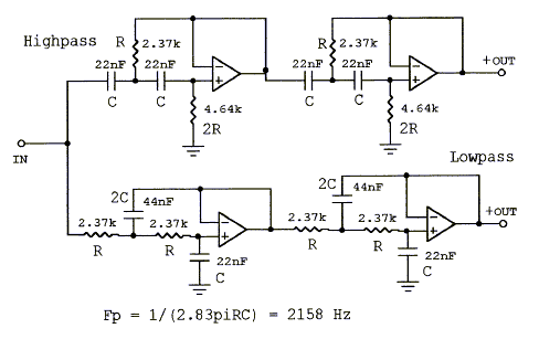

I found These interesting schematic on his webpageLinkwitz

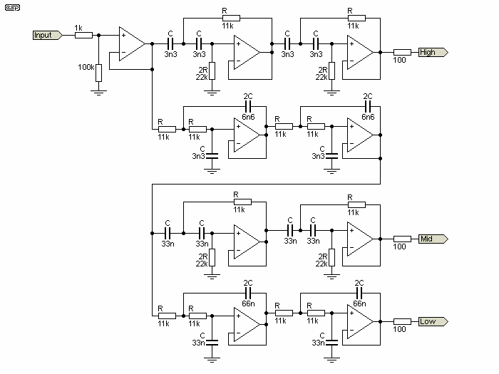

and this 3 way crossover
The first schematic, the two way, would be a very good starting place if you want to build an active-crossover system. The very first thing would be to choose a crossover frequency that’s well within both the high frequency range of your woofer and the low frequency range of your tweeter, and then gain confidence in calculating the R and C values needed to realize the filters involved.
