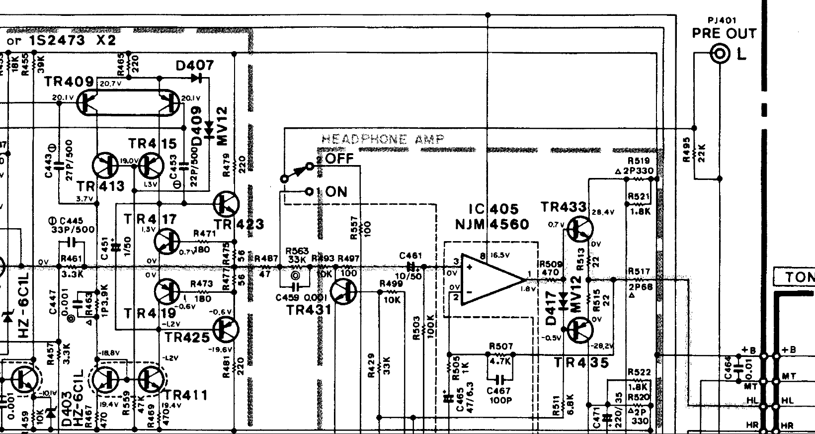

Another concern is the very sensitive VR adjustments of EQ Amp midpoint. Very hard to set it to a stable required rating. Can that be a possible cause for the output transistors to heat up? There are three points of adjustments for this preamp.

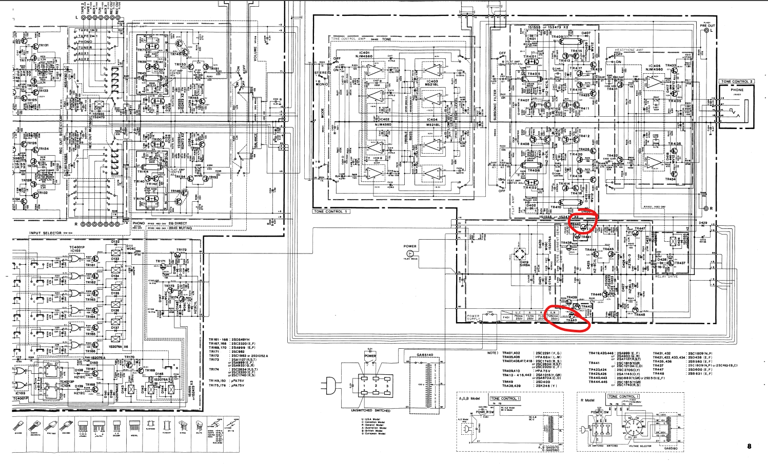

They get hot because of the voltage dropped across them and the current flowing through them (W=I*V) and any replacement would be just the same. I'm guessing the transistors on the heatsinks are TR440 and TR443 which are series voltage regulators in the power supply and they will run hot.

These are simple DC offset adjustments and with discrete circuitry like this the set point will wander with temperature change. With the preamp fully warmed (top on) quickly remove the cover and check the settings aiming for as near zero volts as possible.Another concern is the very sensitive VR adjustments of EQ Amp midpoint. Very hard to set it to a stable required rating. Can that be a possible cause for the output transistors to heat up? There are three points of adjustments for this preamp.

The regulated power supply has two fairly large 30W transistors (TR440 & TR443 = 2SD880) mounted on the heat sinks near the transformer.
These likely generate most of the heat and the case is vented in that area.
The unit is also rated for 40W max power consumption.
So I suspect the heat you observe is normal.

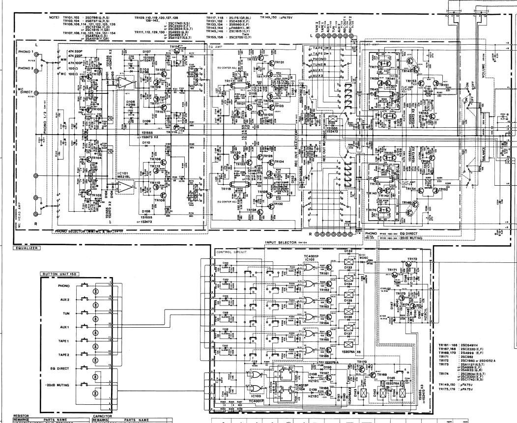

The schematic has lots of useful info about the voltage that should be expected in multiple points. I wish I knew the right succession of steps to follow the flow and track down where the possible misconduct (if any) starts.The final output stage isn't very current hungry

But I would check the voltages before and after the regulator transistors and compare them to the values in the service manual.
