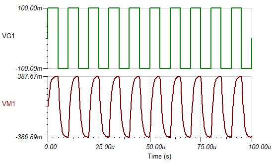

I tried your suggestion but the simulation results make me worry What's wrong? (Check attachement!)
Why do you think, that using a virtual ground is better than pulling the input signal to VCC/2 ? I have never designed any audio amplifiers, but this worked pretty well in my ultrasonic rangefinder design
Remove C1, it is too small for the lower feedback circuit.. You do not need it with a virtual ground...

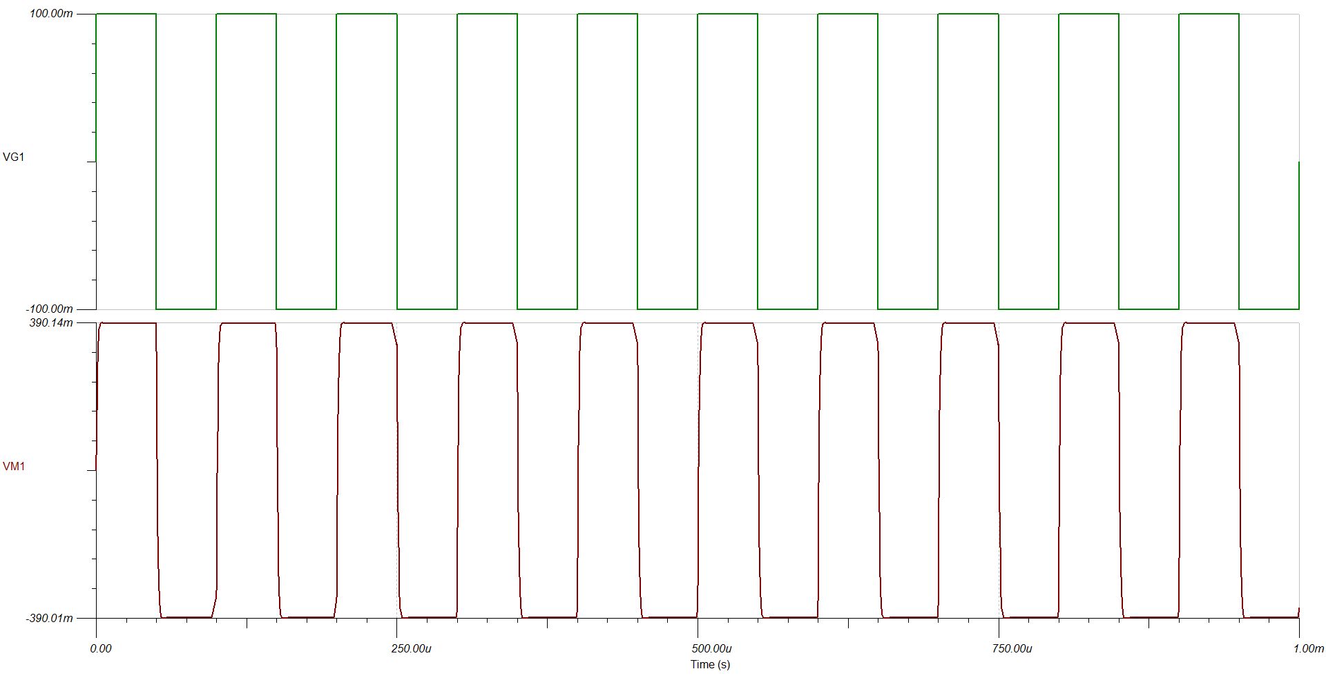

It is much better now (attachment!), but I still see some distortion in the resulting square wave.
The Bode plot looks also much better. What do you think about the phase shift, is it acceptable?
So tell me what are the draw backs of just pulling the input to VCC/2 instead of using a virtual ground?

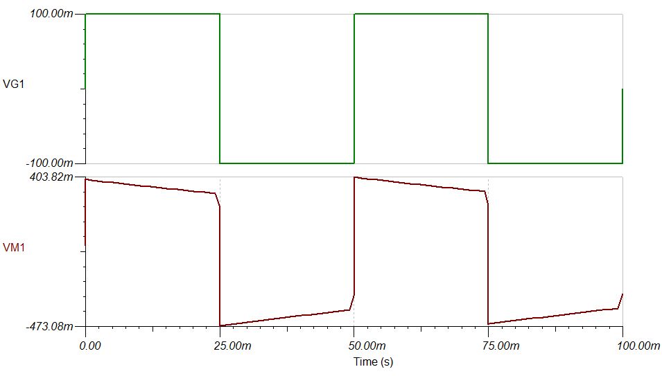

Nothing wrong with the square wave.
C3-R3 and C4-R7 blocks DC and this is the result with a 100Hz square wave.
You have a freq. response around 5Hz to 100 kHz (-1dB).
You can modify this by playing with C2, C3 and C4, but the values you have now are right in the ball-park.
Test square waves 1k, 10k and 100k.
If there is no or little overshoot and nice fast rise/fall times, you are good.
Change the scales on the gain/phase curves to see something more meaningful, -20dB to +20dB, +20 to - 180 degrees, 1Hz to 1MHz.

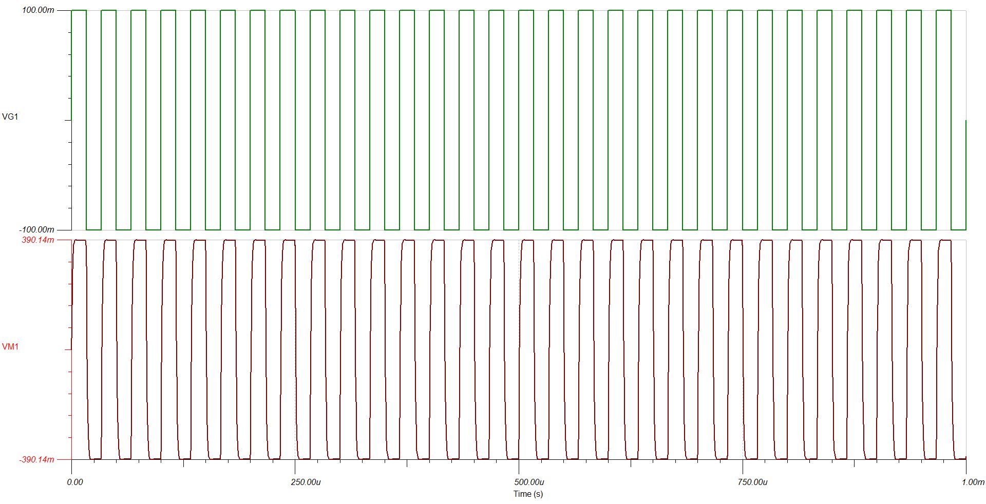

Ok here are some more test, with different frequency square wave. What do you think, will it sound good?
Frequencys from the left to the right: 100k ;30k; 10k; 20Hz; 1k
There is some random clipping on the trailing corners that you did not have before?
But the basic circuit you had in post 13 will be fine, it is textbook.
Simulator cannot tell you much more on a simple circuit like this - the variables will be in power supply, part selection, PCB layout and interconnection...
Do not forget to put ~100nF very close to each supply pin of the chip.
Use MKT for C3 and C4 (MKP if you must, but this is car audio). MKP, silver mica, C0G or X7R for C2.
