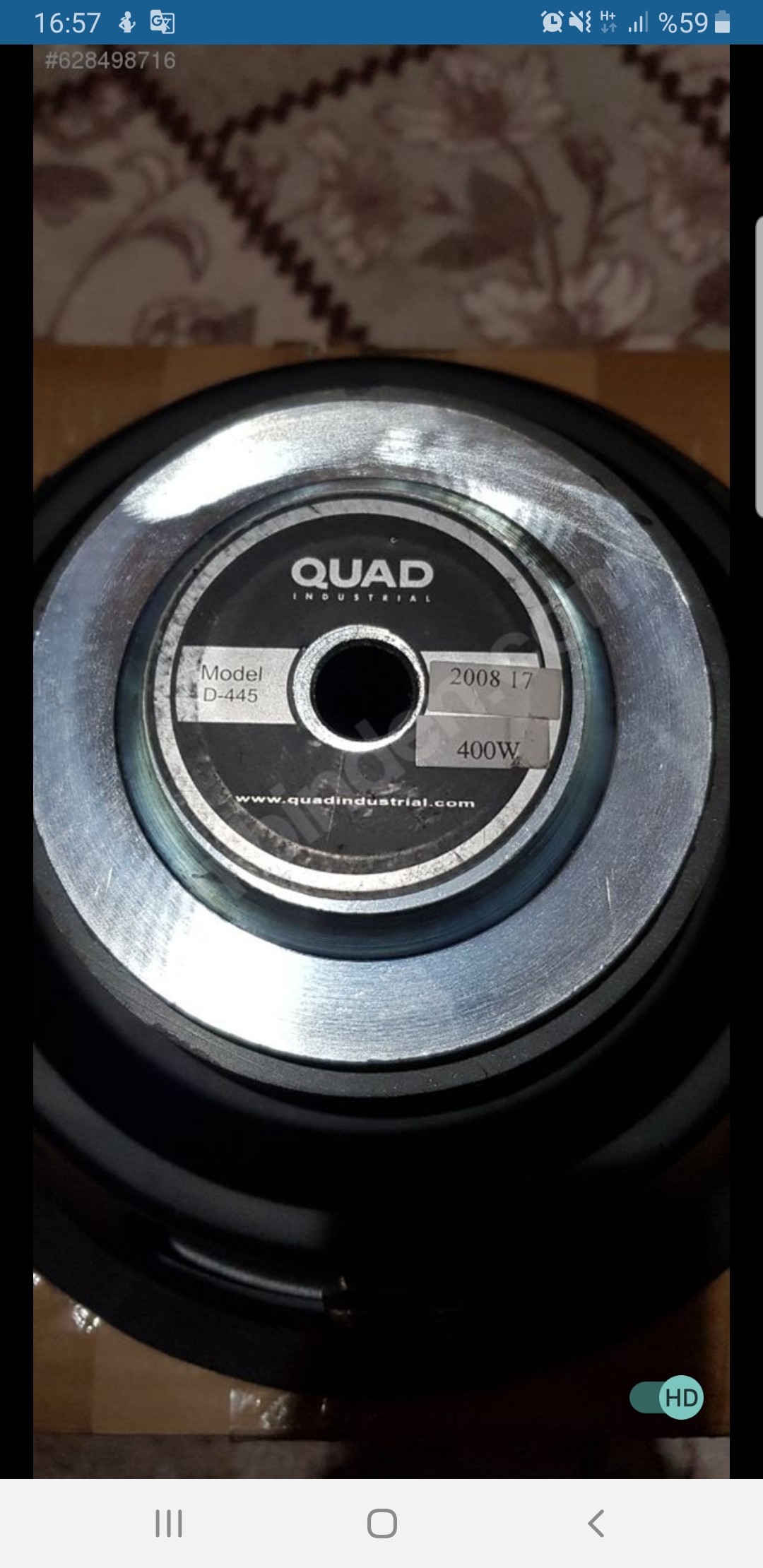

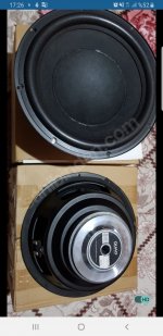

And Front side.They are used in good condition and only 2pcs available.Dual coil 2x8 ohms.400w
Most likely you will have to measure them and what little I found for the brand implies cheap mobile audio, so MAYBE OK for home 'sub', but with no specs.........
GM
GM
Hi.Here is data of speaker made with these drivers.
https://static1.squarespace.com/sta...69608/1447400973010/QI+Brochure+2014+0521.pdf
It seems driver is "Q Suba " s driver.Please check.
