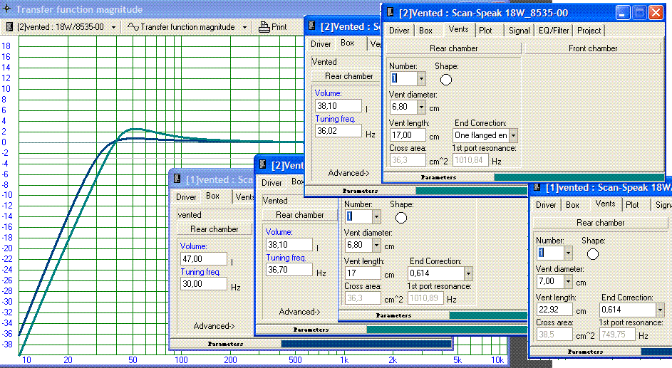

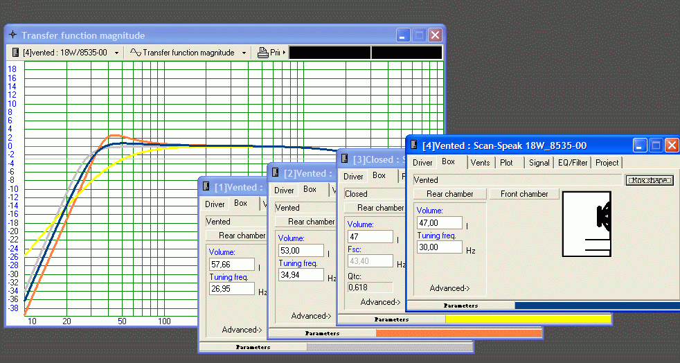

azoran said:My problem isn't Xover. I think cabinet is the problem. I followed your last link and I want to try 8535 ProCub; 47L, Fb=29Hz (BR) design but can't find cabinet drawing.

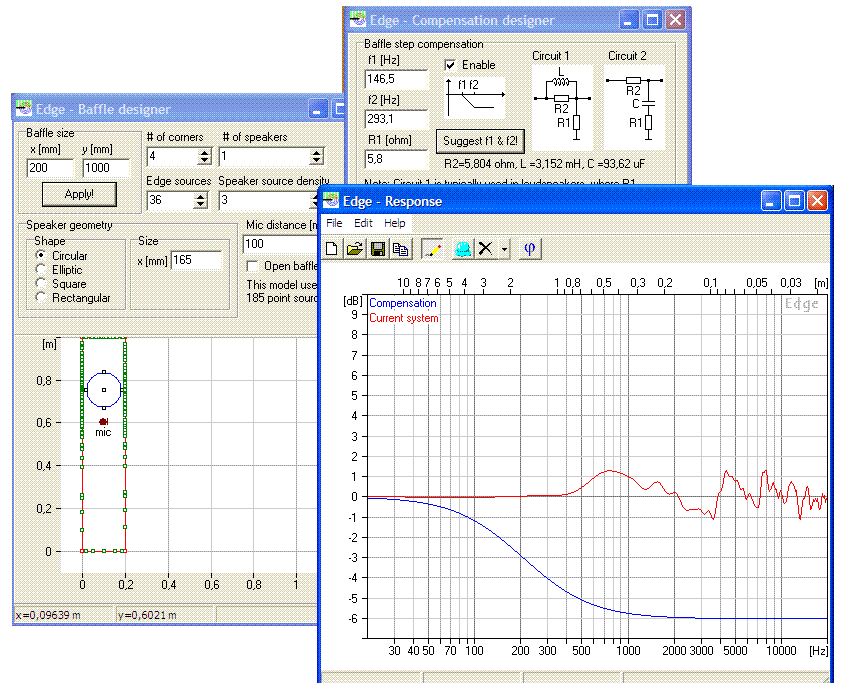

What metod are you using for the size of the box/vent?
Here it is a rough calculation using WinISD. You can use this settings with your existing box, but (your) port is not that favourable at such high frequency (35Hz). To bring it to 47L/32Hz you need a circ. vent of 70mm-d/200mm-l or one of 50mm-d/90mm-l. An idea is to pad the inside with a soft foam pipe of the same size or to make it longer about 196/200mm length. I have one that states "75mm port with variable length" from 135mm to 255mm (max.), "PL 75" that is in reality a 66mm int. diametre from www.caliber.nl. You can also use cardboard tubes. Do you have the ports/vents cut already in the speaker?
For a 47L/30Hz a 50mm/108mm or a 70mm/230mm,
for a 47L/29Hz a 70mm/248mm,
for a 50L/32Hz a 70mm/180mm.
This if they are free ends with end correction (E.C.) of 0.614. Take all this only as a guide not like the best set-up. I am also making sure you are using the size of the box (volume) in liters w/out the volume of the (internal parts) speakers, vents, xovers, braces, wall thickness.

port type & sizes
This is to show that a port type that is flanged on one side (one flanged end/...or two) gives also a lower frequency on the bass of less ~1Hz, what is good in your case. For your case the lenght of the tube (170mm) is not enough with same diameter (blue line). So you need a longer tube or a smaller diameter, as I said in the post before.
The original ProAc has a predominant frequency in relation to Volume/Tuning freq. that they call a "bass performance outstanding" that causes "a few small anomalies" in "the lower midrange". Or it does not produce enough midrange or it's a bit weak (-10dB at 400Hz - stereophile, 1996).
Now with that size of port 70x140mm we can see that it works well with the 38L box and a tuning freq. of ~36Hz on the pic with the green line;
with two free ends:
1. case: End Correction 0,614 ~37Hz
flared port tube:
2. case: End Correction one flanged end ~36Hz.
This means we can manipulate to reinforce the bump or peak or lessen it around 50Hz.

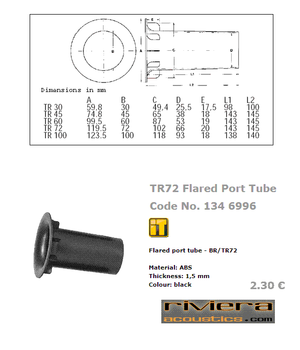

If you want to look at flared port tubes the TR 60 (maybe for a bigger volume box >40L) and the TR 72 maybe for the original ProAc (<40L) and both with 143mm lenght, look good.
http://www.riviera-acoustics.com/catalog/product_info.php?cPath=43_26_86&products_id=447&language=en
