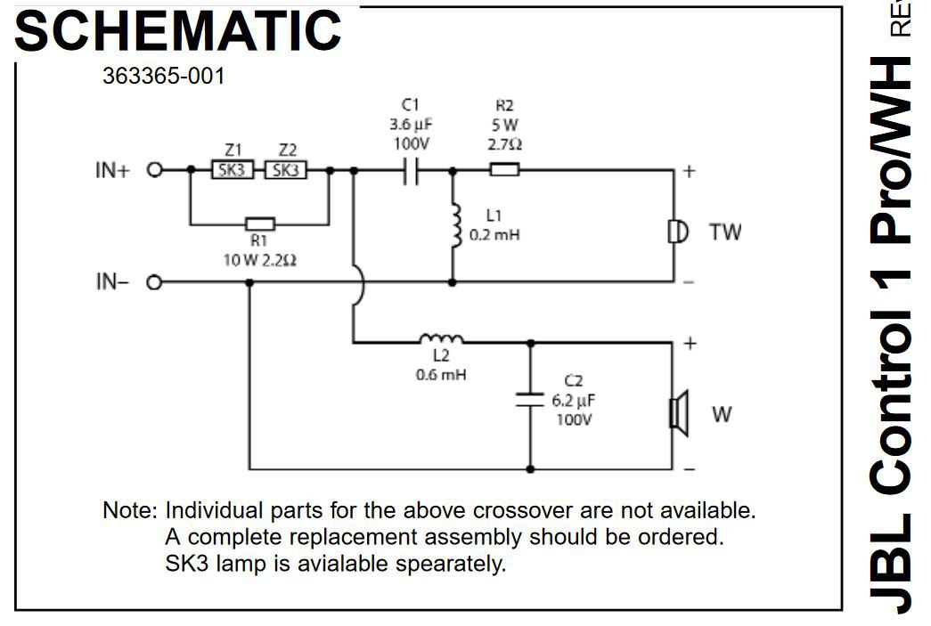

Here’s one specifically for that, I’ve seen them a lot on pro stuff and years ago I had a pair of Boston acoustics two ways that came with one built into the crossover. Speaker Crossover Tweeter Protector Lamp

It is a bit disingenuous to claim that a light bulb in series with the "protects tweeter without affecting the sound"! The bulb will modulate in resistance thus shifting the crossover frequency and tweeter level as it heats up and cools down. Back to back 3 watt zener diodes across the tweeter is an alternative where there is a series resistor in the tweeter feed, say 3.3 volt volt / 3W https://au.mouser.com/ProductDetail/ON-Semiconductor/1N5913BRLG?qs=y2kkmE52mdMaB8%252B0DLi8ZQ%3D%3D

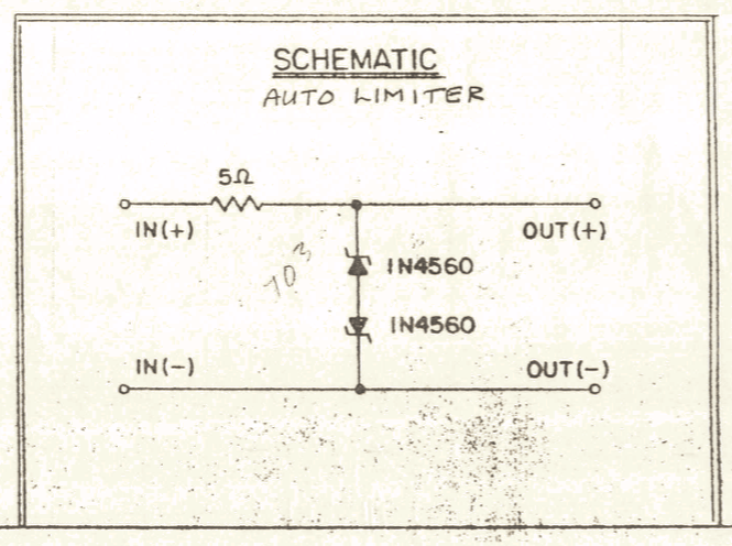

This is a tweeter protection circuit used by Electro-voice in the 1980s. The resistor would normally be the attenuator to match the tweeter sensitivity and sets a minimum load for the amplifier when the limiter is activated. The zener types here are selected for a PA speaker, not a domestic loudspeaker. From memory the zeners were in a T03 package and mounted on an aluminium heat sink.

I've not heard of the double-zener arrangement on tweeters before. Are these kinds of TO3 chassis'd parts still available?
Wolf
EDIT: Looked them up, and that is a no for the TO3 zeners. They are either $160 each, or largely unavailable.
