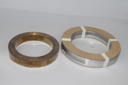

Distributed air gap toroids (powder iron) have very low permeability and are not suitable for SE use.
For SE or DC chokes toroidal core is being cut in one place with band or disk saw (e.g. 0.5 or 1mm thick) and then filled with compound, or in 2 or more pcs for assembly in a cage, with thick epoxy layers between pieces.
I suspect that the Plitron SE Toroid transformers use a very thin spacing material (plastic tape or thin paper) between the many wound layers of the very long steel tape lamination.
I don't know if its possible to make gapped core with technique you have described. Wound core needs to be heat annealed, so plastic ribbon is very likely to melt and burn.
PS. I'm in doubt it makes any sense to make toroidal SE transformer. As I mentioned before, it limited to fixed air gap thickness because of machinery, thus, its geometry and winding can't be optimized to the same extend as conventional ones. On the other hand, gap in double C core is easily adjustable with plastic film layer(s) to almost any meaningful value. In short, its more like fetish rather then measure of quality.
