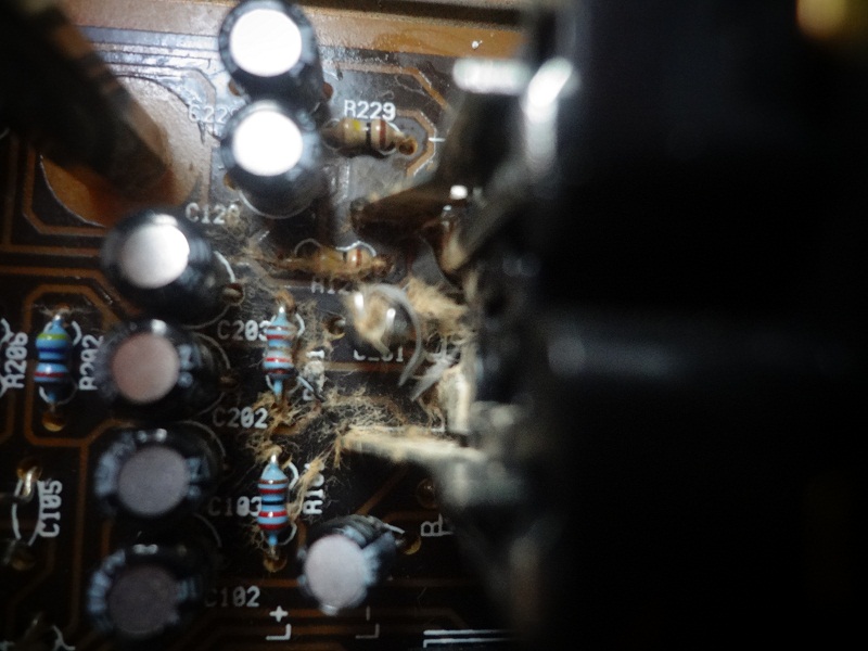

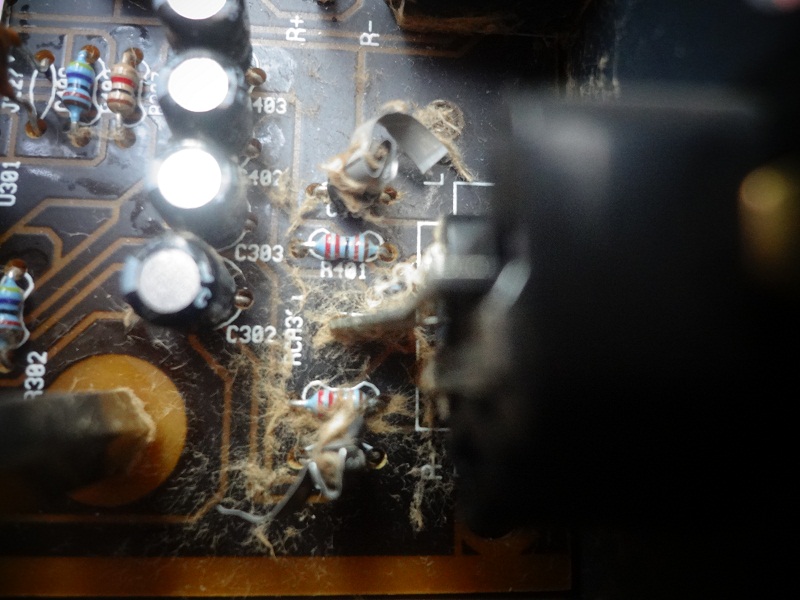

im openinig the pack of Amp and see 4capacitore is destroied
i changing theme but still its not working
any help appriciated🙁🙁🙁

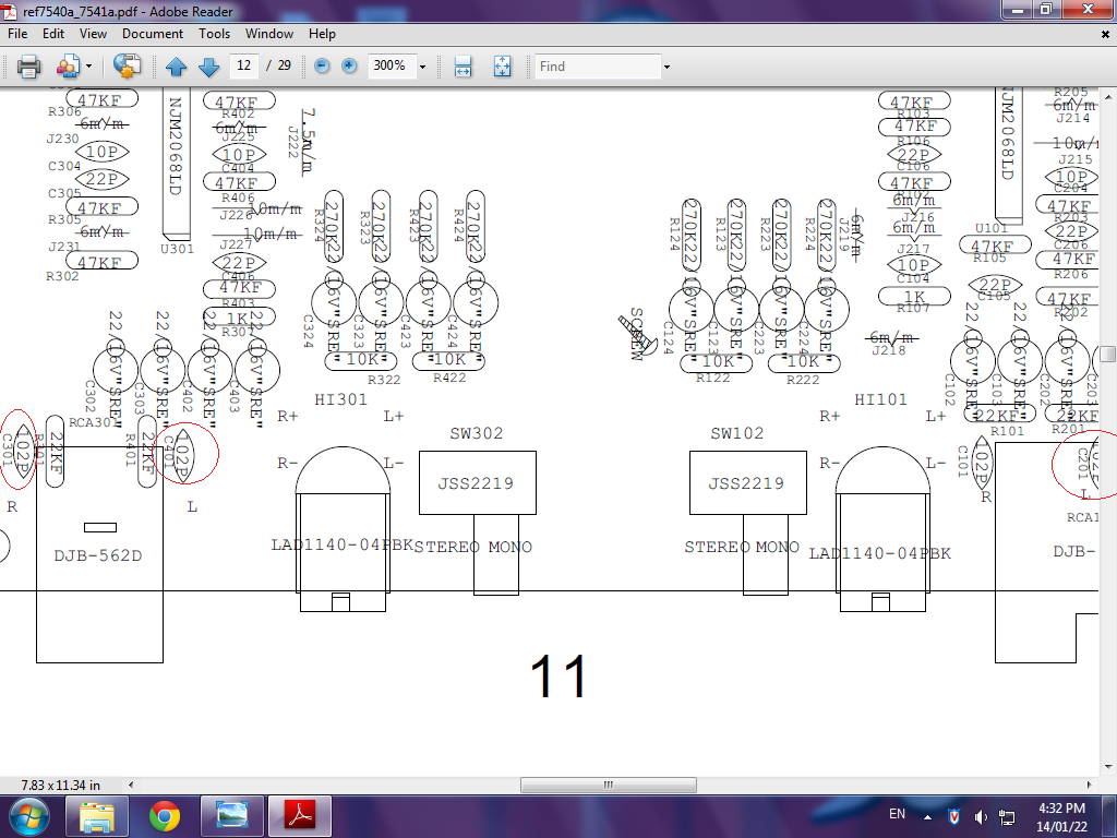

here is the picture of Amplifier...
and service manual i marked damaged Capacitores With red Circule
Those are electrolytic. Probably due to either high voltage input or excessive dc voltage.
Look like 33uf 16v.
The ones you got circled on the diagram are ceramic.
Look like 33uf 16v.

tnx for replay...
yes those Are Ceramics and Spefications( 10uf 16Volt)
i changing Theme to 10uf and 50Volt
but not Working and one change is The light flashing are different now...
protect light now flash Slower Than Others
how Find Out problem from where?

I looked at the schematic for the amp, and those caps are used to decouple and DC voltage from any input source to the amp, but they also can do the same in reverse if your amp has shorted rails back onto the ground common of the amp internally so I am thinking you might have blown channels and or a shorted power toroid, not so much the toroid though.
Just replacing those caps will not fix a blown amp channel issue and so if they get replaced they will just explode again like they already did unless you tech out the rest of the amp and fix what else is internally wrong with the amp. It looks like way more then 16 volts hit those caps and that is why they exploded. Must have been very noisy when they went on you. A simple voltmeter testing will tell you what voltages on on those blown up caps, but I am fairly sure your amp has shorts elsewhere inside of the amp causing this issue....hope this helps some..
