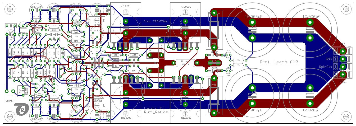

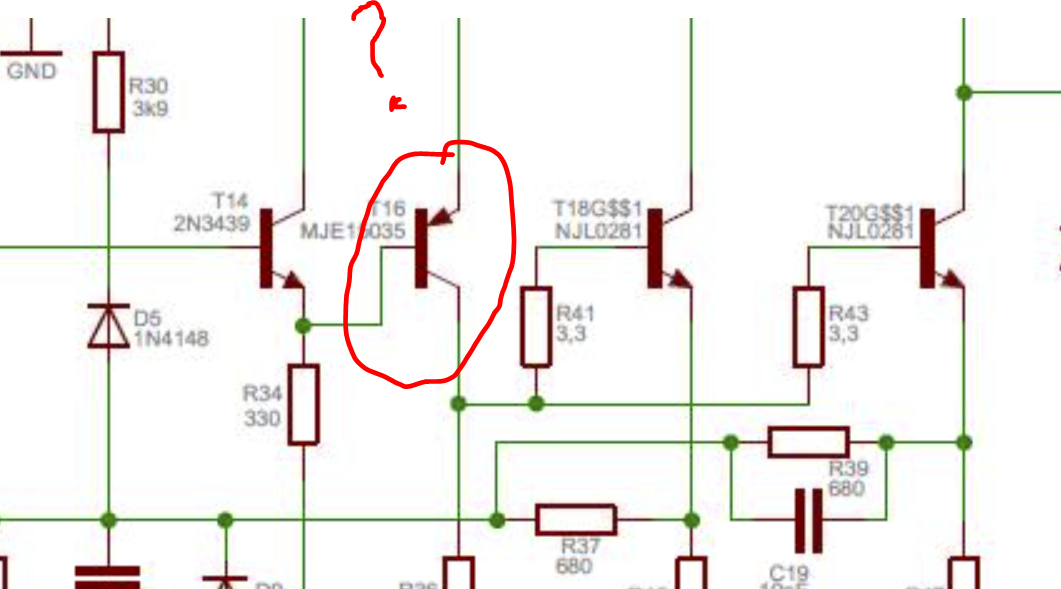

I have remembered Prof. Nelson Pass' amplifier (Release 4.5) to sound very well and have done a layout of my own.
Image1 shows the schematic; Image2 shows the layout.

Well done Rudi,
only those round TO39 heats up, and if you want to put on some round heatsinks - you have to see if there will be space on the PCB and will not interfere with other parts.
i use such similar, only black anodized.
4PCS TO99/TO39 TO-99-39 Aluminum Heat Sinks For OPA627SM LME49720HA OPA128KM | eBay

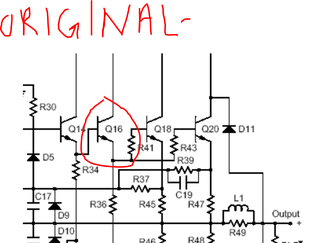

Rudi:
Check that schematic carefully if you want to build a true Leach amp. There is at least one error!
For example, Leach uses a true emitter follower triple for the output stage; the schematic you showed doesn't.
Best Regards,
mlloyd1

A couple (late) recommendations:
Since the power rails VCC & VEE are meant to run very close to +/– 60V, the electrolytic decoupling capacitors should be rated for 100V, not 63V. If lower voltage parts are used, they will have a much shorter lifespan.
In the older amp designs, such as this and the DH-200, -220, the C12 value was only 100 nF. Modern designs use a larger value here, such as 220 uF. The voltage rating on this cap may be 16V.
100V capacitors can be very large ... I think 75 or 80V is enough, look at what is available. seems to be 80V caps usually have 6800 uf or less.
The importance of using sufficient voltage rating for the power decoupling capacitors is such that I would recommend making the PCB larger, if necessary.
Voltage rating is more important than temperature rating (as all are rated to at least 85°C) for electrolytic capacitor lifetime.
Edited to add:
I was originally referring to the smaller 1000 uF capacitors, which can easily be sized for 100V rating. The larger 10,000 uF caps may be more problematic. While 100V would be preferable, 75V or 80V may suffice.
Edited to add:
osscar,
Leach uses the T output triple approach that Bart Locanthi developed many
years ago - I recall that he talks about it in his articles. The positive drivers and outputs should ALL be NPN and the negative drivers and outputs should ALL be PNP.
Error is highlighted in the attached schematic snips comparing Leach's original schematic to Rudi's.
There may be other errors; I stopped checking after these.
Best regards,
mlloyd1
Best regards,
mlloyd1
output seems to me to be correct ...I don't see any error
Ok. Thank you...now i see

@mlloyd1:
Thank you for pointing me to this error.
I have mixed the drivers (MJE15030 / MJE15031) and have changed the schematic / layout accordingly.
I will check the grid of the used capacitors, before I order (on the weekend).
Best regards - Rudi
