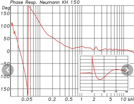

I can't tell from this angle whether it's any good, because they just FIRed one axis to within an inch of it's life.
OMG! The phase!! The phase @ 50 Hz rotates one round !
And the bell is rather large! Can we talk about 'bell' in this case? So from 500 Hz the magnitude is regular and that's good!
BTW the reflex ducts that are angular like in the Neumann monitor...really sucks! Ah ah ah

I did not listen to these monitors. The comrade who has the Hedds says that with the linearizer turned on they sounds "a little bit slightly better"))I can't tell from this angle whether it's any good, because they just FIRed one axis to within an inch of it's life.
OP can test this himself
