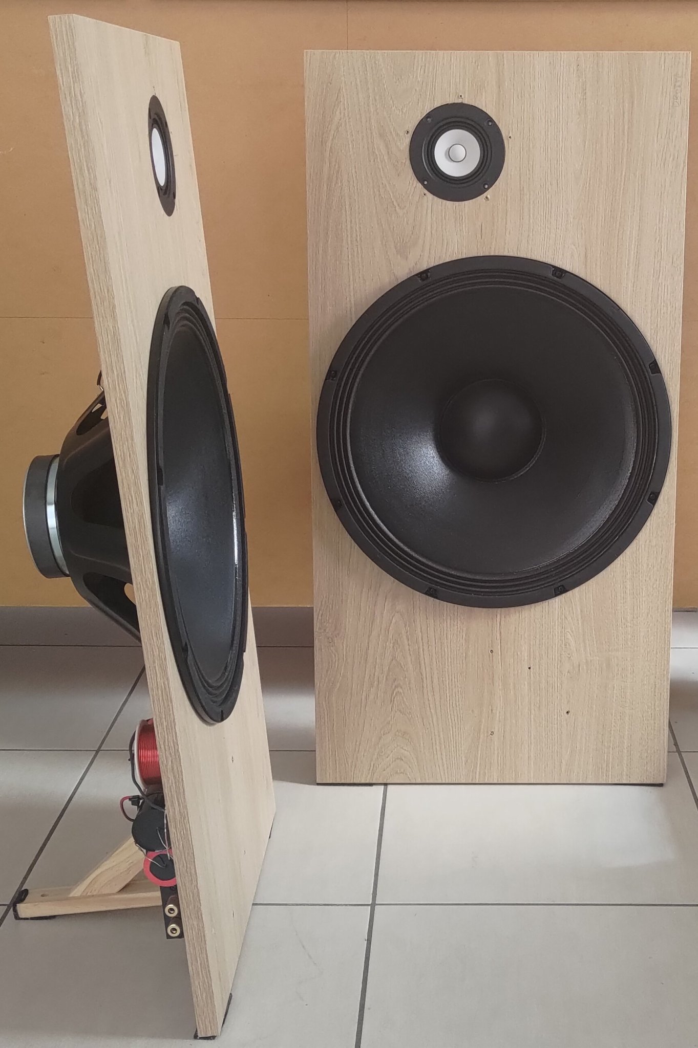

The bandwidth is 50Hz-20kHz 87db/2,83V . The Qt of the woofer on the panel is 0.8 and 36Hz resonance. I made some measurements, the response curve of the speaker is honest. The crossover frequency is 640Hz.
I was a little lazy for the construction, the panel is a shelf board with standard dimension 80cmx40cm.
It is a compact open baffle. I add a shelf bracket in the back to tilt the panel.

I enjoy a lot the speaker, it works good to my ears.

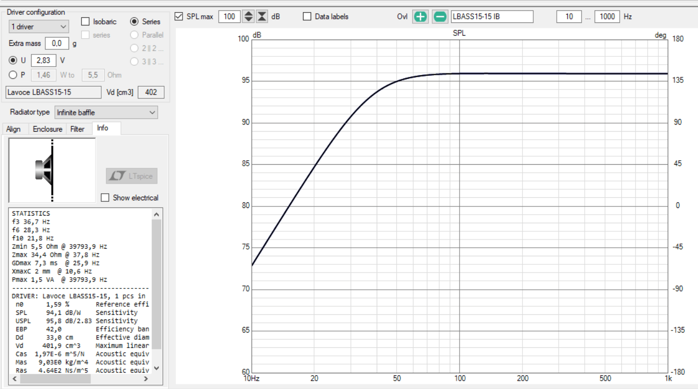

Looking for a woofer usable for OB, I found this one, a driver for bass guitar : Lavoce LBASS15-15-8
Some challengers were simulated Fs < 40Hz Qt > 0.6 Not a lot of contenders.

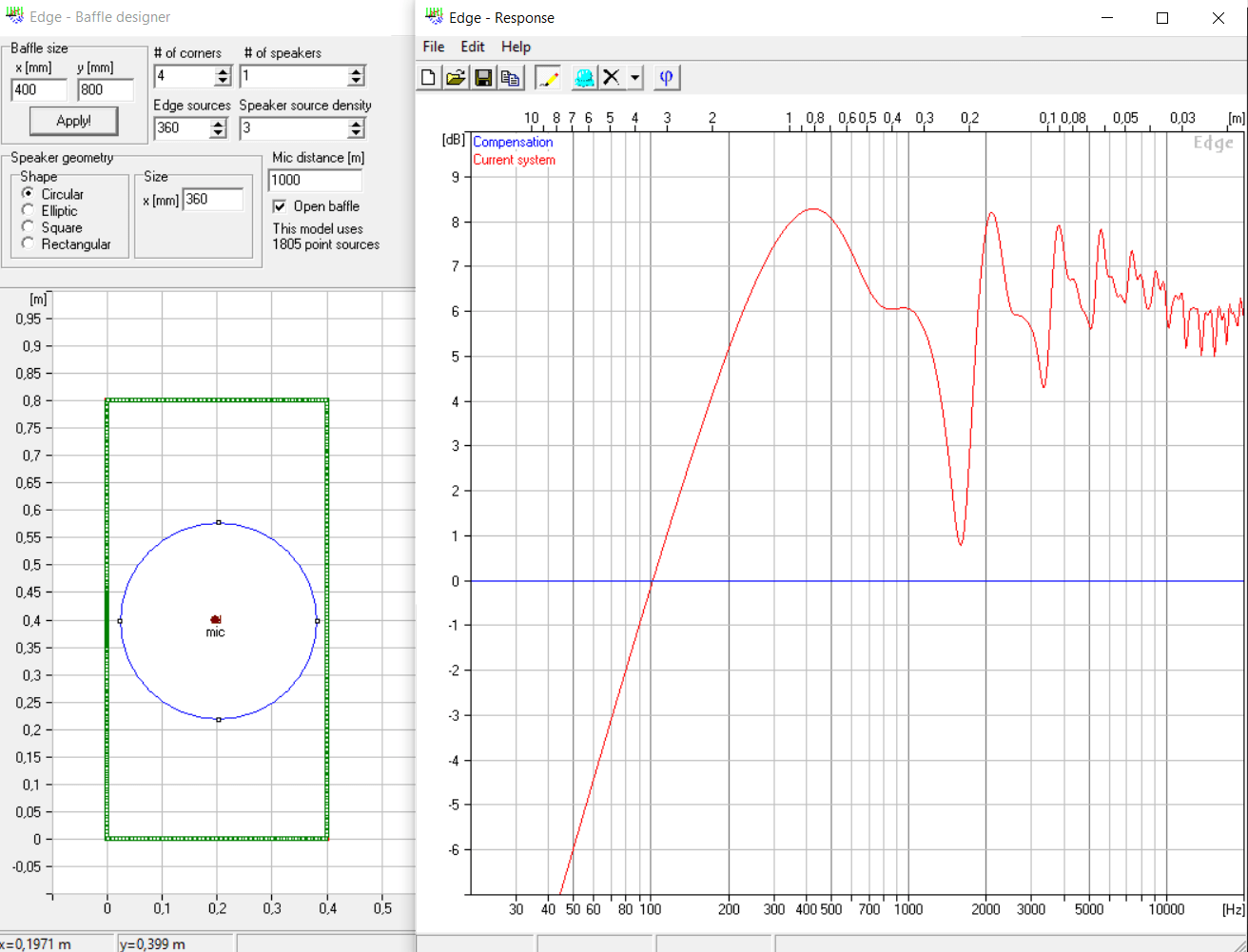

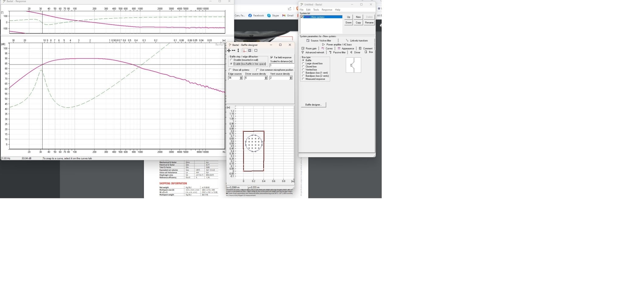

It can't if you are 1000 m distant (as you defined in edge).can play bass
(Edit: I agree it's a bit confusing that the mic distance needs to be defined in m, but the rest in mm!)
Yes it plays bass very well !Are you sure this OB can play bass? How, where is the magic?

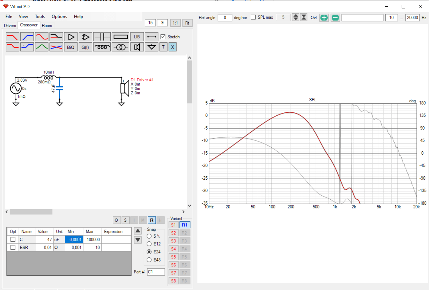

The magic is equalization : the big 10mH coil extend the speaker response down to 50Hz (-10dB less level) and the room contributes to the lower notes.
See my references in the first post and Martin j king website for a starting point : http://www.quarter-wave.com/OBs/OB_Theory.html

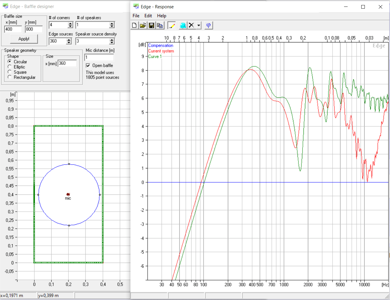

Please read the references. The problem with your simulation is all 15" drivers have the same behaviour on the same open baffle. It is a false assertion if you don't take into account TS parameters like Qts. Imagine the same thing with a box : All drivers have the same bass response in the same box !?
Well, your 1st plot shows 28Hz @ 90dB which is -6dB, so plenty of output.
But for better simulation try Basta with room gain, box/baffle in free space and so on. You might find a different result.
I guess you are familiar with Basta as you are using Edge. And Basta is the big brother of Edge with more advanced capabilities.

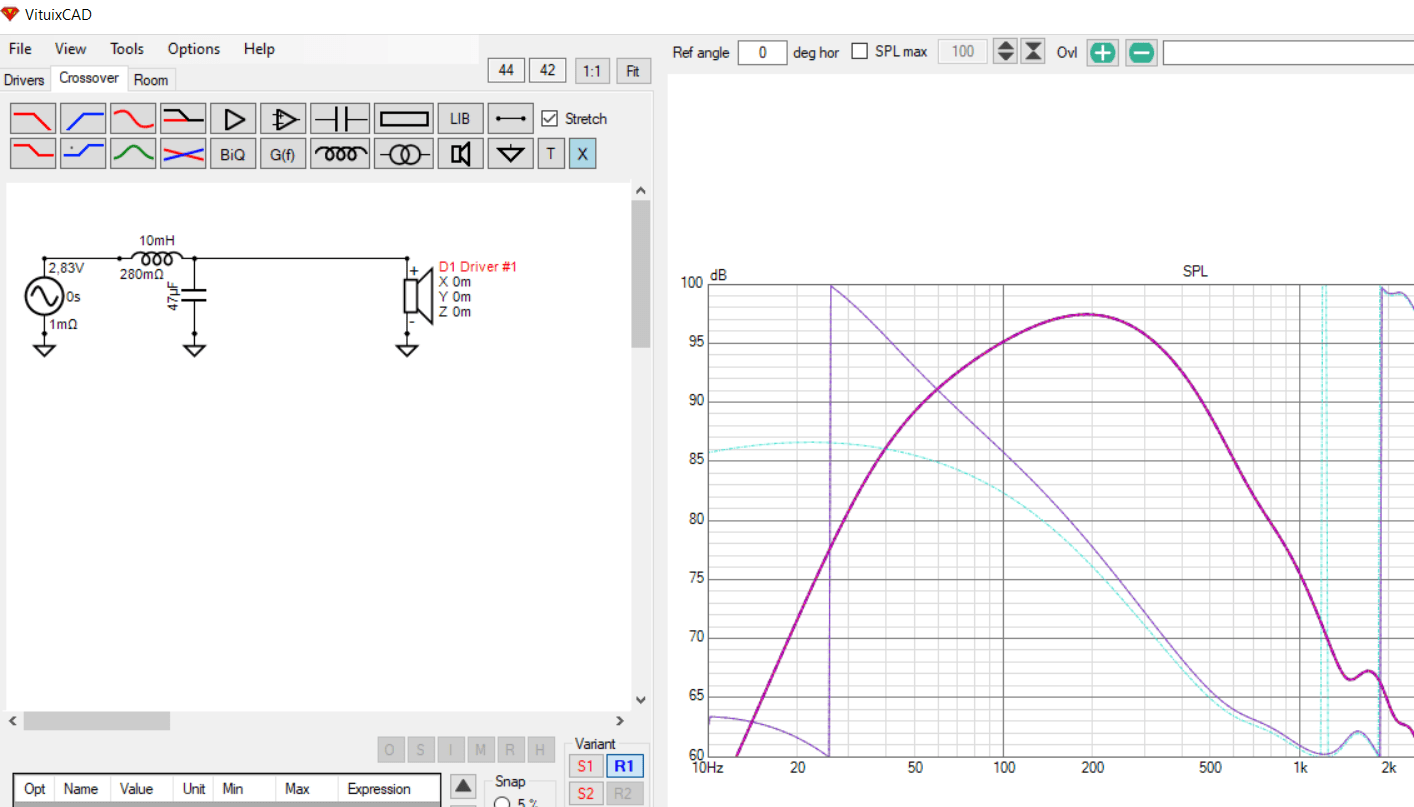

All things combined, it works. The 10mH coil lowers the output leaving the bass high, and this is why a high sensitivity woofer with high Q and low Fs is needed. The coil also places a boost at Fs if low enough DCR. This is a benefit here.
Perry Marshall's primer on boosting passively could also be used.
