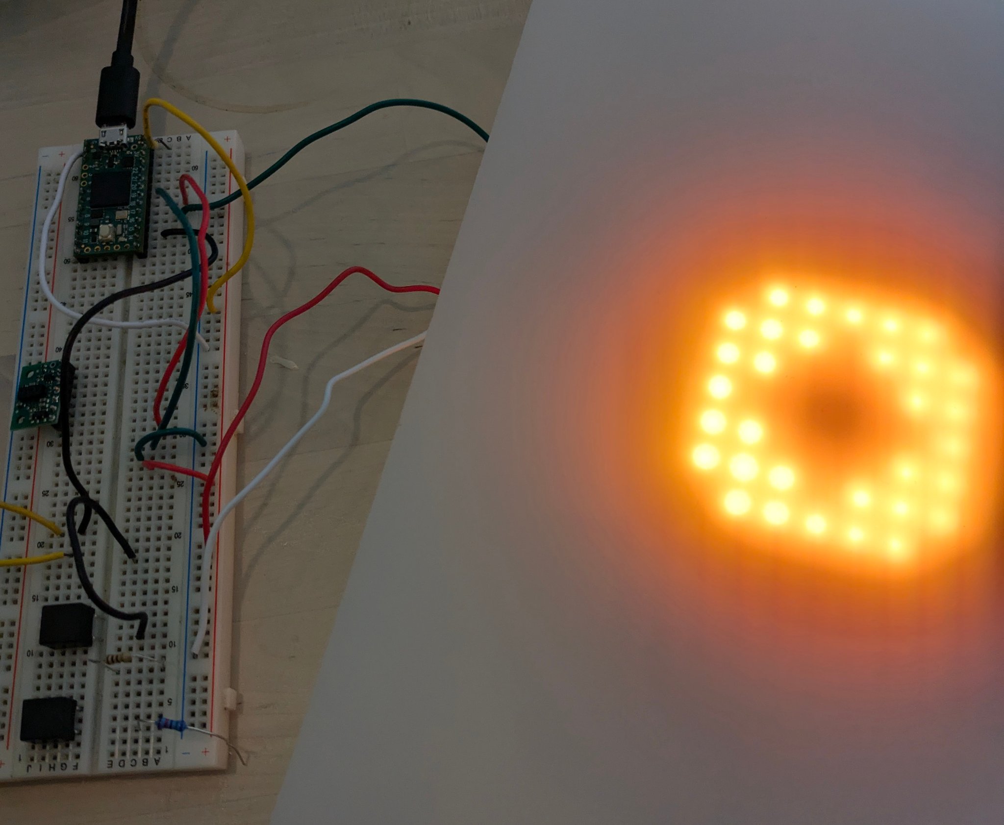

A little further in the UI with the TOF sensor. Sorry it is so dark but I needed to lower the brightness because the interface increases it in the demo. I made it so if 75% of a corner is highlighted for a second an action is taken. In the demo you can see the brightness go up.
The end result will be each corner will adjust a setting: brightness, visualizer, hue, and maybe something else.

I like your idea of the different diffusers. I do have a thick piece of plastic and gave it a go. For the final project, I was thinking that there should be a sort of holder for a diffuser but I never thought of star and other shaped ones-just plain white.
I have the same visual demos running through the plastic.
