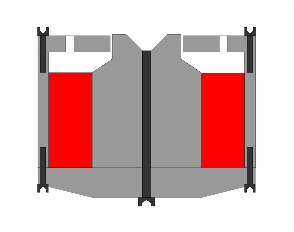

Field Coil Motor Structure:
I have spent a lot of time looking for other field coil projects, for any information on FC design or about available products and i have to say there isn't
much out there. From the pictures of opened FC units i could see a basic shape of the pole pieces. I have to say this is amongst the first design issues i encountered, there isn't much freedom to design these pole pieces, not like the case with permanent magnets anyway.
The next thing one can notice is that the new FCs are low impedance type and this is easily understandable. I have decided that my field coil will also work with 12-15V supply.
Underhung design means thick top plate. Of course this will cause a drop in flux density in the gap. The compromise here i found to be between flux density value and voice coil excursion. Since this speaker will mostly be used horn loaded i sacrificied Xmax to make a thinner top plate. I use standard 1010 steel with a maximum of 0.13% carbon, the best i could get my hands on.

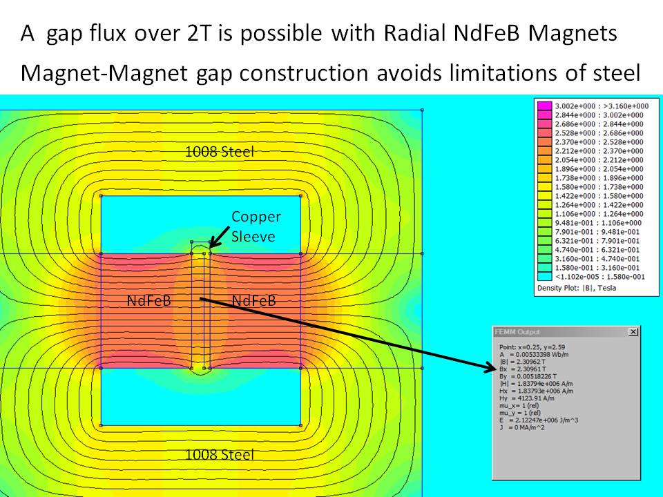

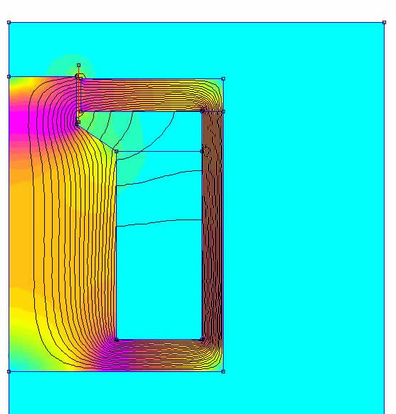

I ran simmulations in FEMM for different values of top plate thickness, FC's number of turns, dimension, wire diameter etc. Here are the results i stopped at:
- magnetic gap height: 12mm
- magnetic gap width: 1-1.5mm
- 5.3 ohm FC 1400 turns of 1.25mm copper wire
Below you can find a rather crude sketch of motor structure:
Here are some results from FEMM analysis:

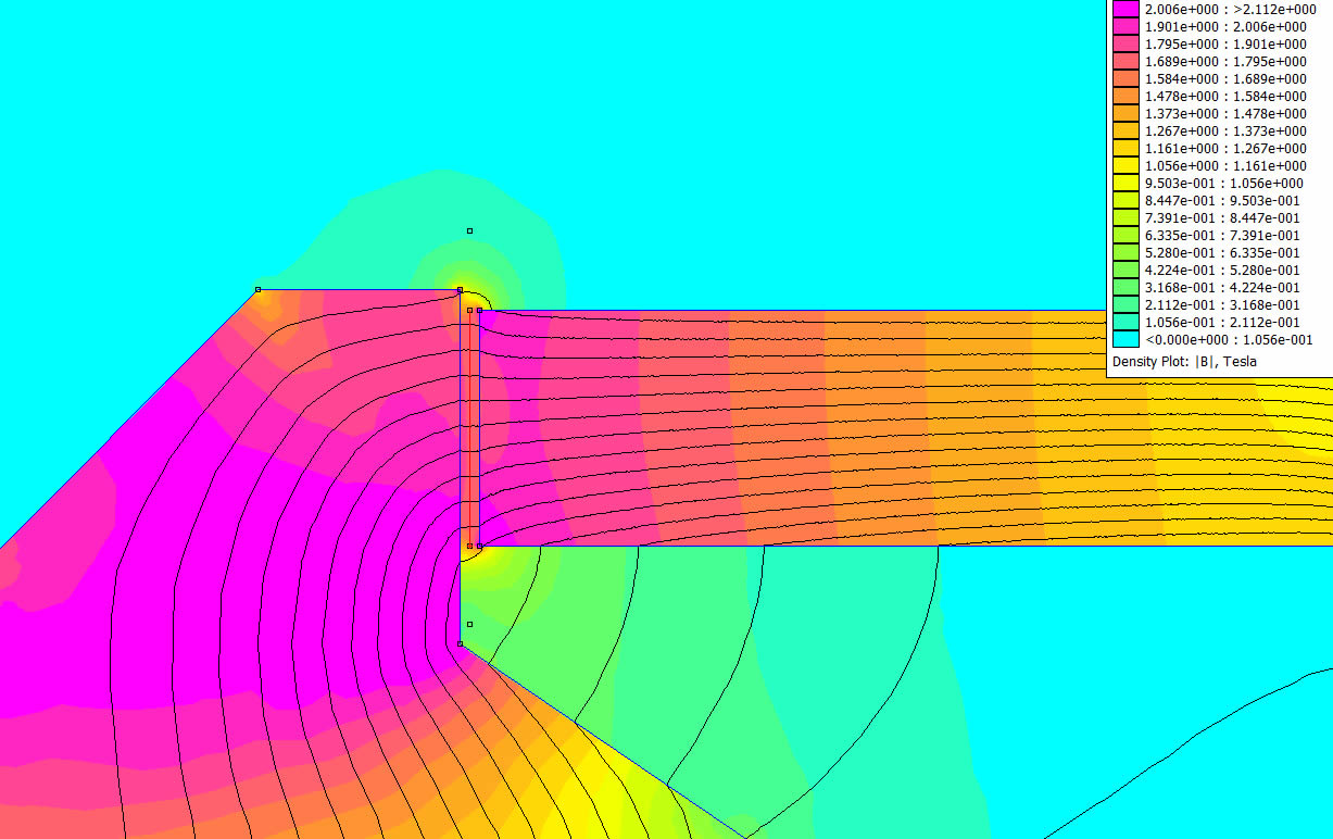

I ran simmulations with 1010 steel as well as 416 steel (has slightly more carbon typical 0.15%) to see the differences.
1010 Steel Curve over 20mm and 12mm:
416 Steel Curve over 20mm and 12mm: (actually the curves are smoother had to lower resolution a bit because of my computer)
Magnetic gap:
AS it is, at 2.2 Amps we have 25W for the FC. I don't expect to have too much trouble with heat at this power. Test will tell tho, depending on how well the metal does the job of sinking the heat. The value predicted by FEMM lies around 1.6 Tesla. In reality i believe this value will be smaller 1.4-1.5 T. In tests i will drive the FC with 3 amps and see how much it heats up.
In this design the gap width is 1.5mm. Somewhat large, I'm thinking to add a 0.5mm thick copper ring right in the gap (yellow part from picture below). Now
it's true i have never seen a picture with a FC unit having a faraday ring and I'm not sure if it's necesary. I guess the FC itself has a role in that too.
I'm also making a 1mm gap variant (without copper ring) in hopes to get more flux density. The FEMM simmulation shows:

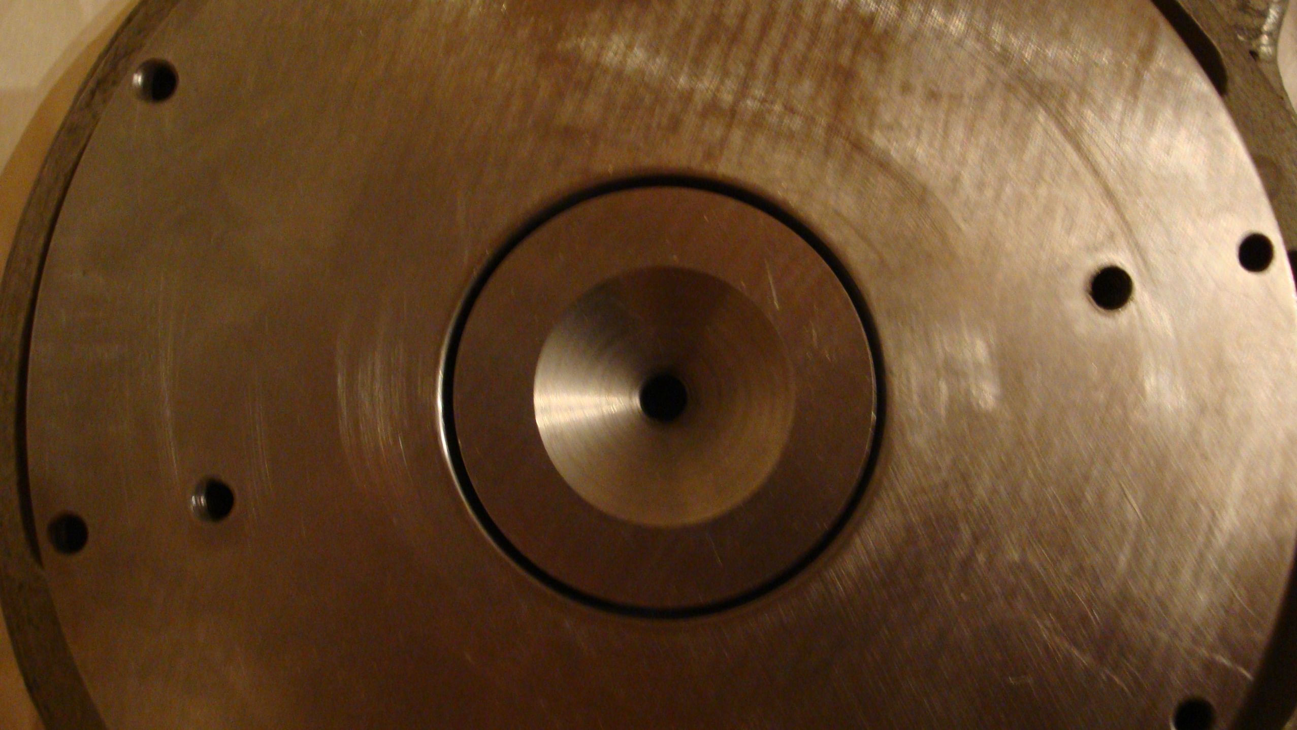

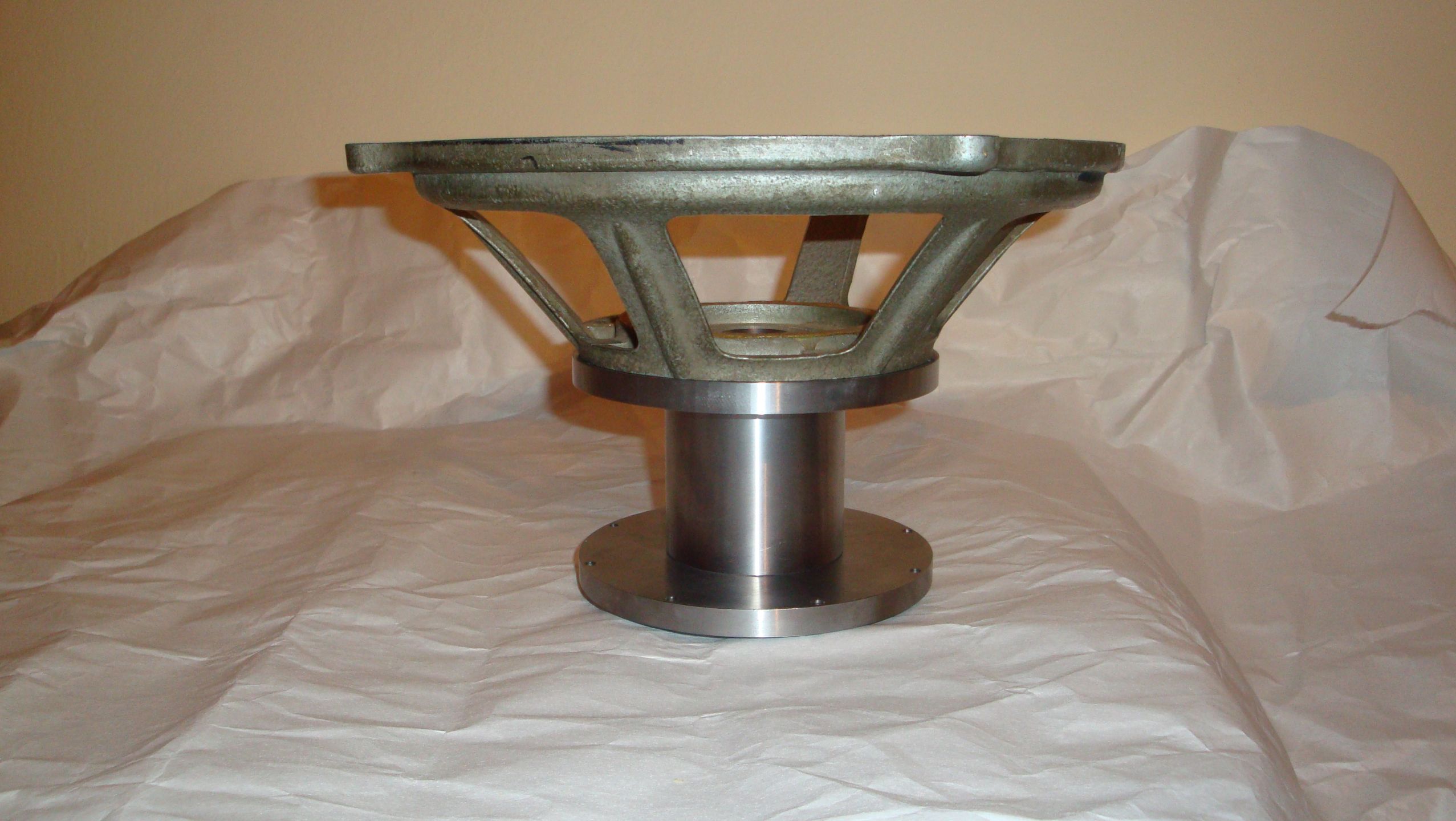

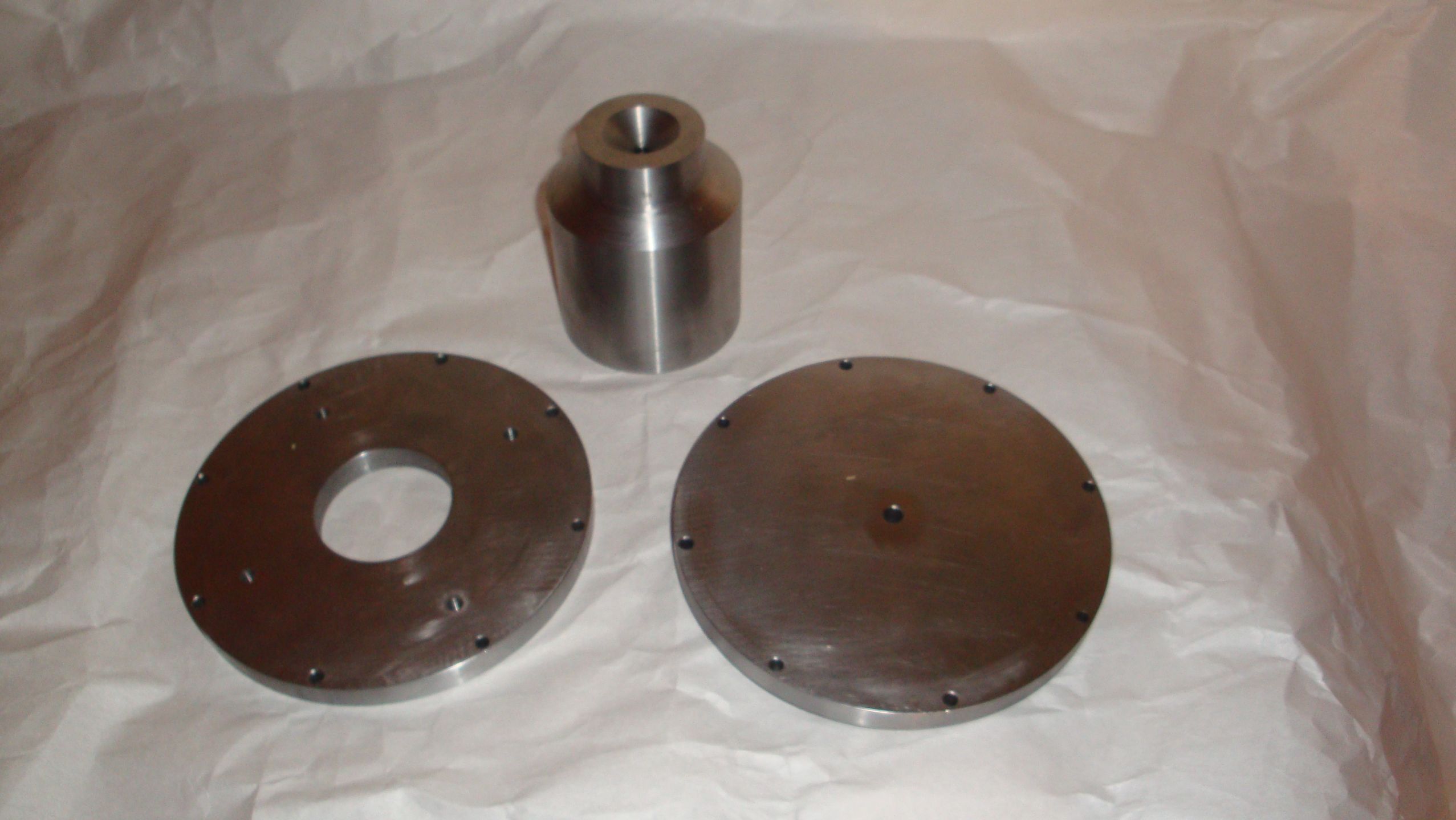

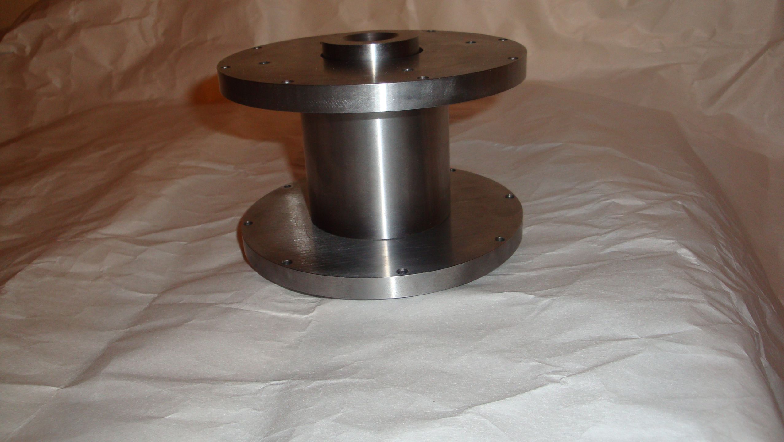

Here are some parts of the magnetic structure after machining:
![FC_Structure01.jpg](https://s17.postimage.org/aqrcqetvz/FC_Structure01.jpg)
![FC_Field_h_C_2_2_Amp.jpg](https://s16.postimage.org/df2cnz6ut/FC_Field_h_C_2_2_Amp.jpg)
![FC_Field_LC_2_2_Amp.jpg](https://s16.postimage.org/9wqcrl5yt/FC_Field_LC_2_2_Amp.jpg)

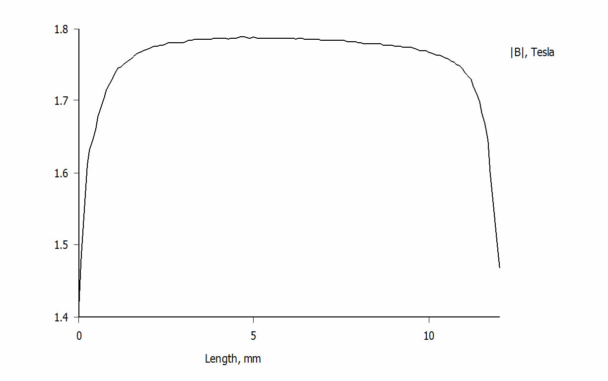

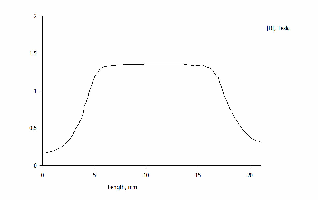

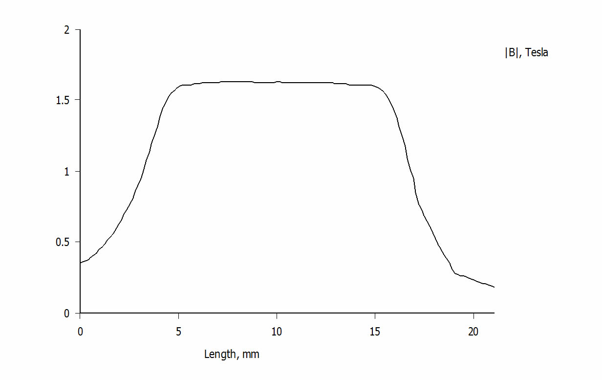

![FC_B_LC_2_2_Amp_20mm.jpg](https://s10.postimage.org/ci8vmtou1/FC_B_LC_2_2_Amp_20mm.jpg)
![FC_B_LC_2_2_Amp_12mm.jpg](https://s10.postimage.org/4bgvv8yrd/FC_B_LC_2_2_Amp_12mm.jpg)
![FC_B_h_C_2_2_Amp_20mm.jpg](https://s10.postimage.org/fmjjjm5mh/FC_B_h_C_2_2_Amp_20mm.jpg)
![FC_B_h_C_2_2_Amp_12mm.jpg](https://s10.postimage.org/48seuo5q1/FC_B_h_C_2_2_Amp_12mm.jpg)

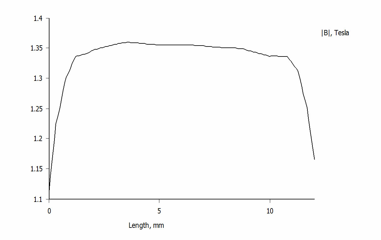

Magnetic gap:
![FC_Field_gap_LC_2_2_Amp.jpg](https://s17.postimage.org/4ns5pgx5b/FC_Field_gap_LC_2_2_Amp.jpg)

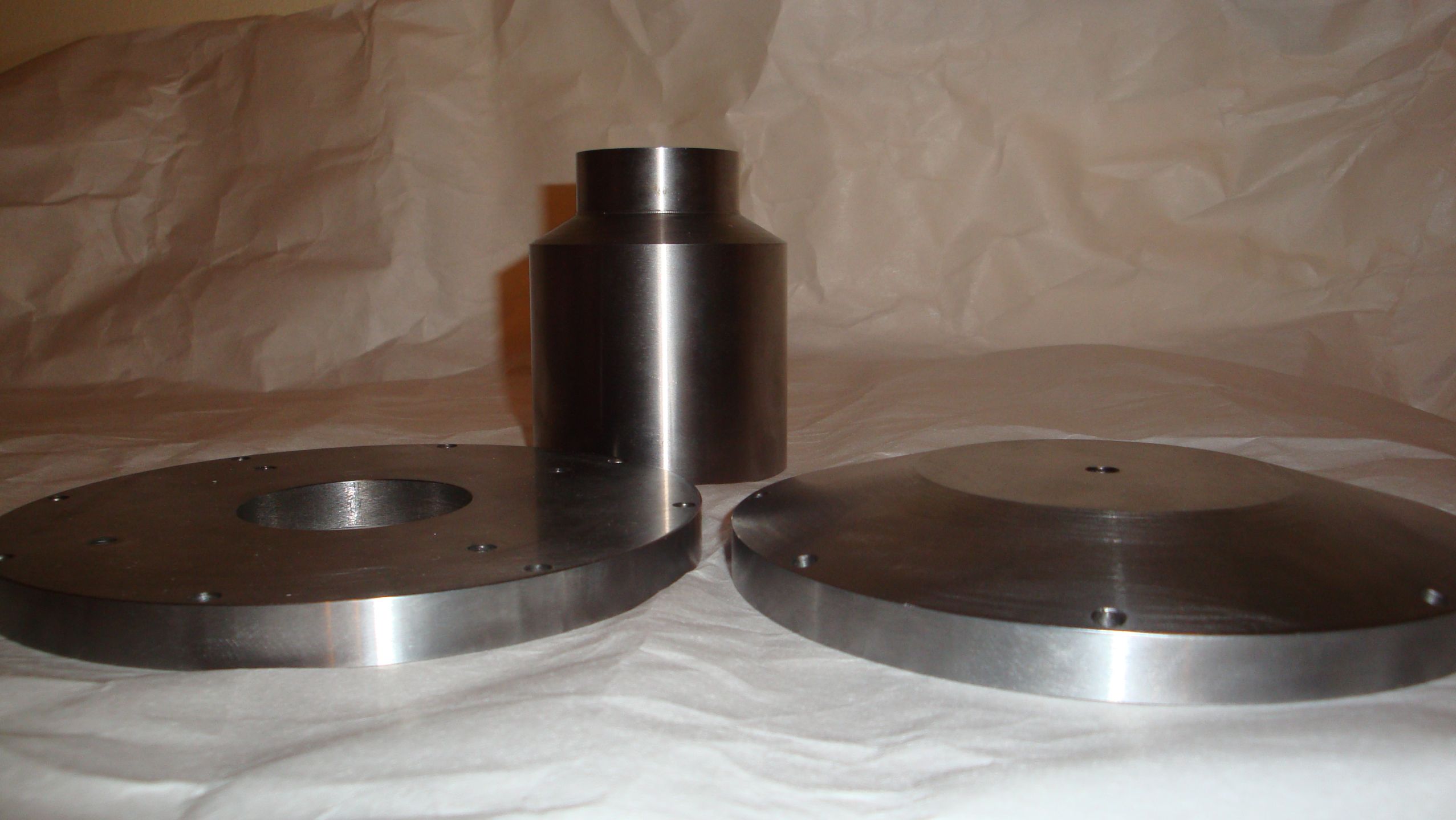

![DSC02849.jpg](https://s10.postimage.org/usgej2gvt/DSC02849.jpg)
![DSC02854.jpg](https://s10.postimage.org/evhmmcohl/DSC02854.jpg)
![DSC02857.jpg](https://s10.postimage.org/8vygwft2x/DSC02857.jpg)
![DSC02858.jpg](https://s10.postimage.org/lbv6q6mex/DSC02858.jpg)
![DSC02863.jpg](https://s10.postimage.org/6txzi6v3t/DSC02863.jpg)

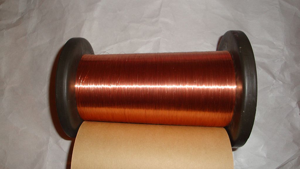

Voice Coil:
Voice coil is 2" diameter. Haven't decided on the former material yet, and there is still some designing work to be done. I will use 0.13mm copper-clad aluminum wire (hoping to receive it Monday).
Data for the ECCA wire is as follows:
Copper Vol: 15-17%
Density [g/ccm]: 3.7
Resistivity [ohm*sqmm/m]: 0.0255
I will come back to the voice coil issue soon.

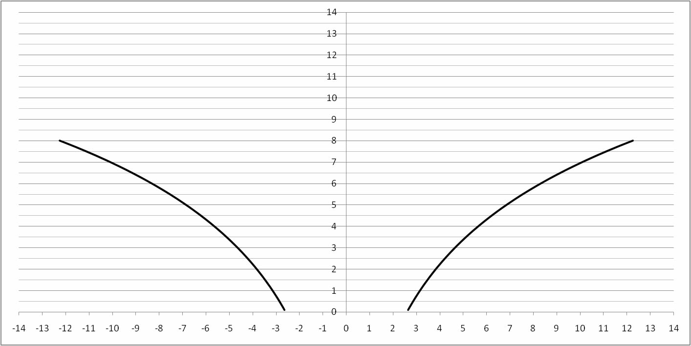

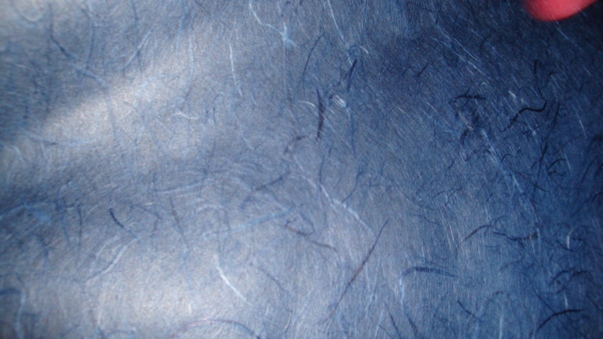

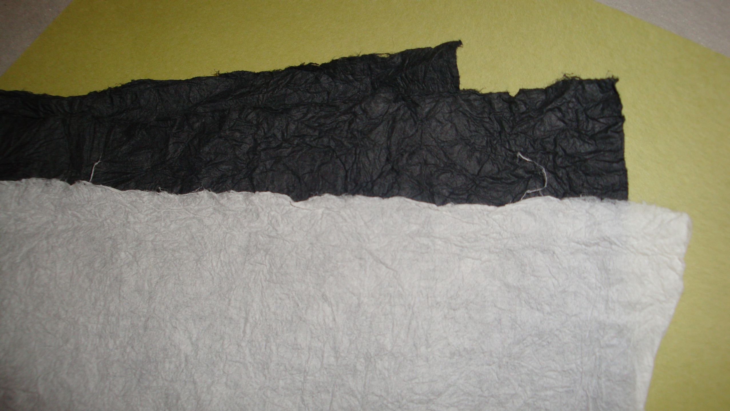

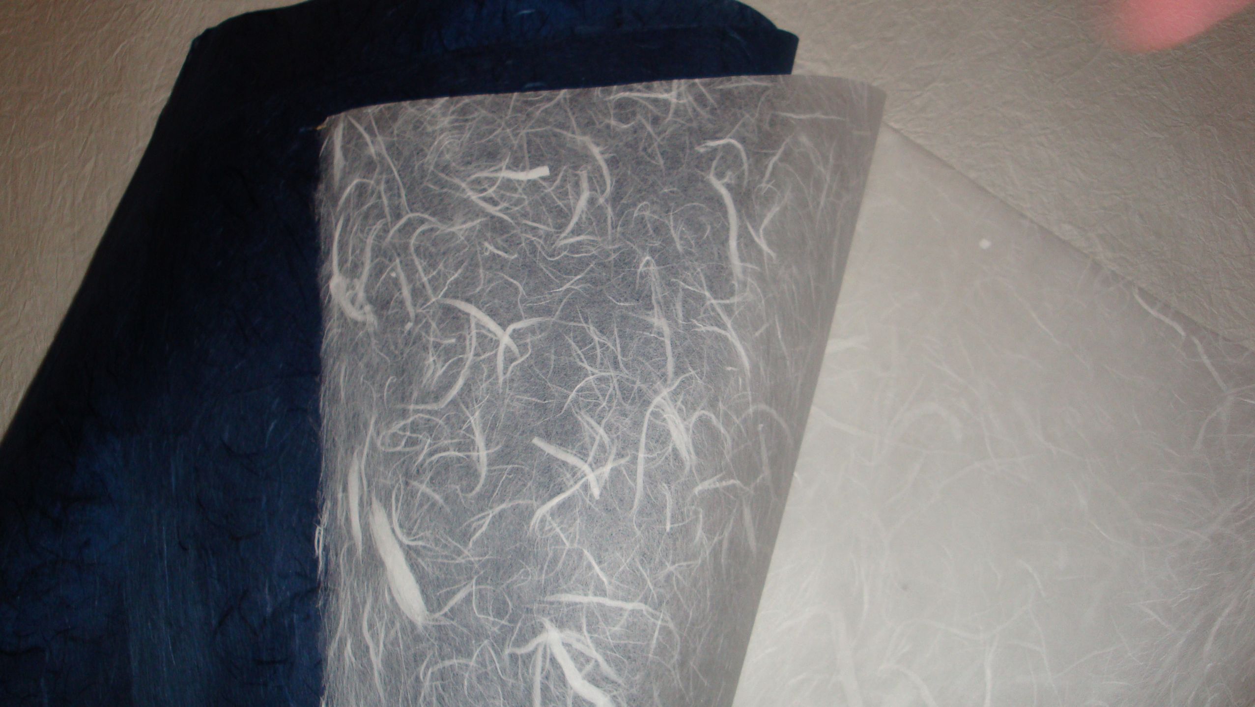

Cone:
Cone will be made of japanese paper called washi (fullrange crowd might now why hehe). I got a few rolls of washi of different types and will test a few variants.
![DSC02864.jpg](https://s10.postimage.org/tjx4b6ebd/DSC02864.jpg)
![DSC02866.jpg](https://s10.postimage.org/9dtmcaint/DSC02866.jpg)
![DSC02867.jpg](https://s10.postimage.org/jcekyrs3d/DSC02867.jpg)
Next week work will start on cones, most probably will be made from 12 petals. I will test both straigth and curved cone. An exponential curved profile like in the picture below has a calculated flare rate of 0.387/cm which should correspond to a freq close to 1050Hz. Have to look into whizer cone as well.
![cone_contour.jpg](https://s10.postimage.org/jrl9e1omx/cone_contour.jpg)
Thats it for now, let me know what you think so far. I will post more info as i go with this project. I hope it will awake more interest into fieldcoils and
shed some light on the matter.

Hello, glad you find the topic interesting.
Yes, a high BL is mandatory for high efficiency. I am also looking to tilt the response upwards in frequency, as in higher sensitivity while going up in band. This will be very helpful when using horn loading.
Of course electromagnetic overdamping will be an option on how hot you run the FC.
But as you identified, i aim to get 1.4T and not overheat the FC.

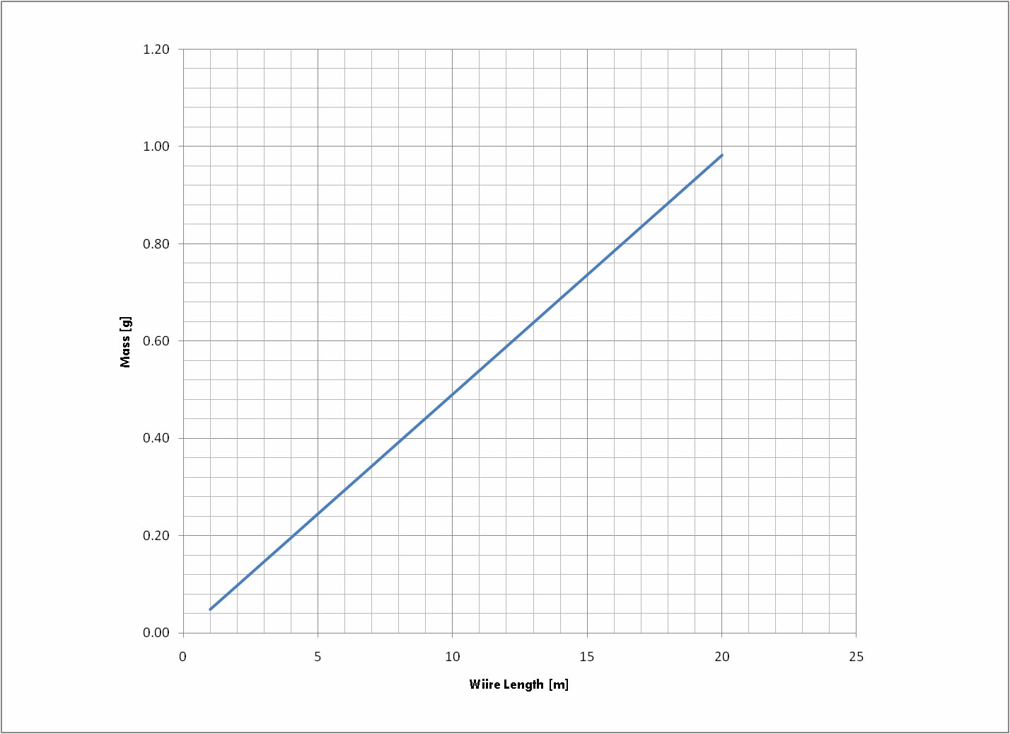

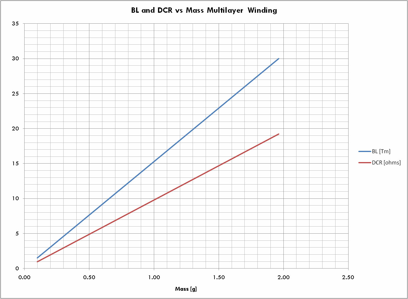

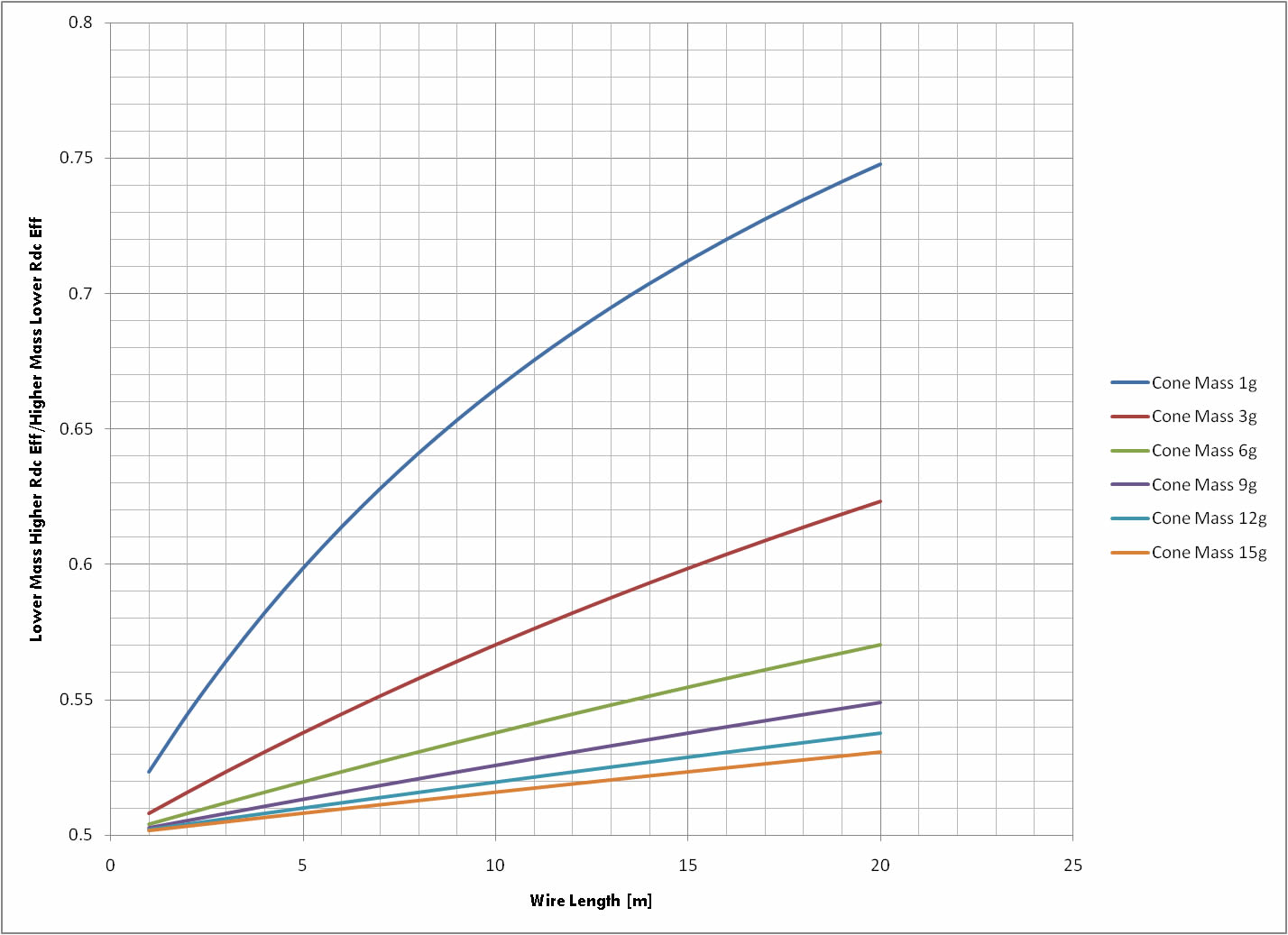

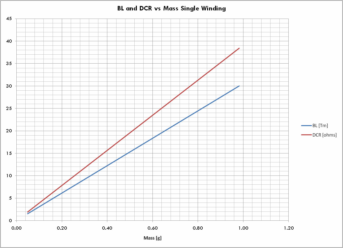

More on Voice Coil:
The magnetic gap is 12mm in height and this is the VC's height limitation as well. At first i was looking into a 9 mm height vc but the xmax figure was unacceptable. A thinner wire tho allows me to reduce the height to 6 mm to give the theoretical +/- 3mm of excursion. I made the pole piece 1 mm above the top plate to make a more gentle slope on curve in case this excursion is exceeded. Now i think it could've been 2mm as well or maybe better.
When calculating the voice coil parameters at first i was obsessed with low mass. I was even thinking of a single layer of such thin wire if it was possible. It presented too many issues tho both electrical and mechanical.
With a single layer i would have a small BL value, high DCR and the voice coil would be too fragile for a 12 incher.
So i wondered with such a thin wire how much mass can i save by not going multilayer? It turns out that gain in mass has a too small effect on efficiency compared to the increase in BL.
Of course one needs to consider this gain in mass in addition to the cone mass. The chart bellow compares the two efficiency values for different cone mass. As you can see the cone has to be very very light, has to have a mass very close to that of the wire to make a difference. Once the weight lies mostly in the cone its best to put as much wire as possible in order to get high BL.
One more aspect i needed to clear. The actual motor force figure. DCR opposes current so it's not enough to have a high BL i needed to factor in DCR. Looking at efficiency formula the figure [BL^2/Re] stands out. And it makes sense as this figure is the actual motor strength figure. This is a constant for every loudspeaker even the ones with dual voice coils. In dual voice coils BL can change depending on how you wire the coils but Bl^2/Re remains constant.
Considering all this i came to a 16ohm nominal voice coil made from 2 paralel coils of 14.6m each. One can eliminate the parallel windings by using thicker wire.
6mm Hvc
Zn---Len---Rdc---Obs--------------BL------Mass---BL^2/Rdc
16---7.33--14.09--Single layer------10.995--0.36---8.580303971
8----7.33--7.04---2 Layer Parallel---10.995--0.72---17.16060794
16---14.6--14.09--4 Layer 2 S 2 P---21.99---1.44---34.32121588
Bellow are some charts i made when doing calculations for this specific 0.13mm ECCA wire.
