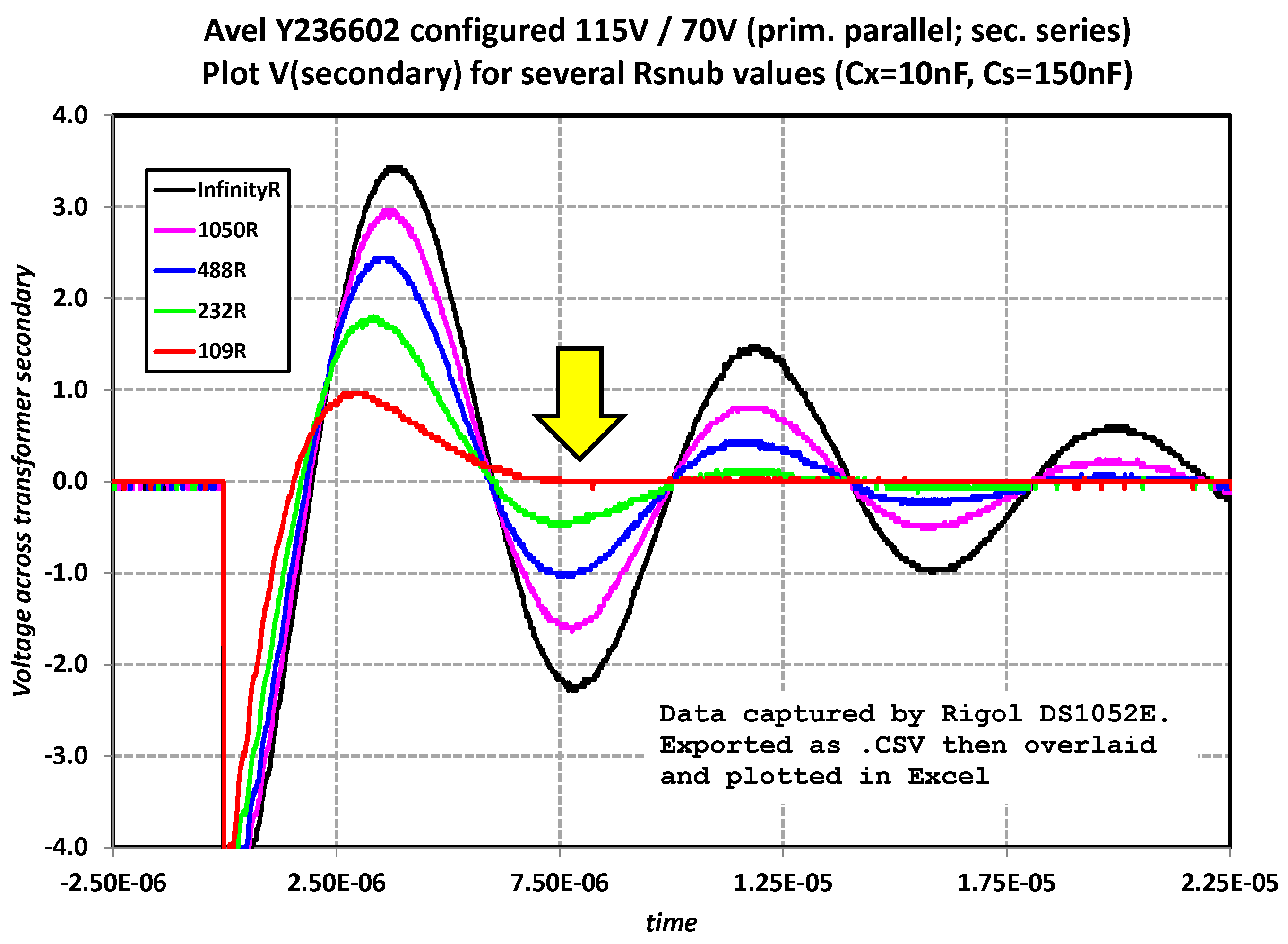

I have had good success focusing exclusively on the "L" part of RLC resonant circuit. I attach external components directly across the two terminals of the transformer secondary. The external components are directly in parallel with the resonant "L", namely, the secondary leakage inductance.
(Here is a link) and some oscilloscope overlays are attached below.

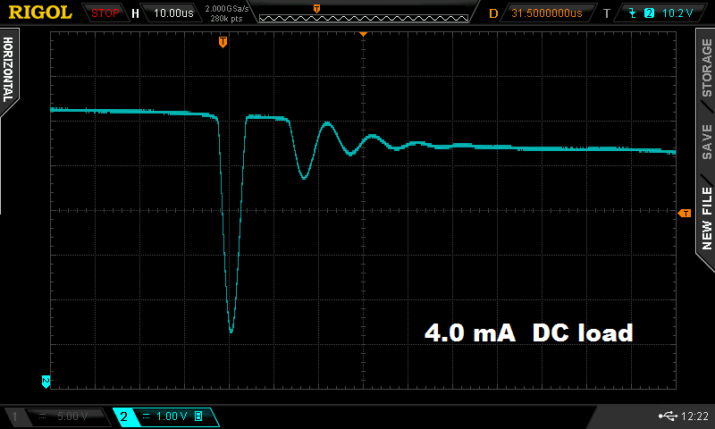

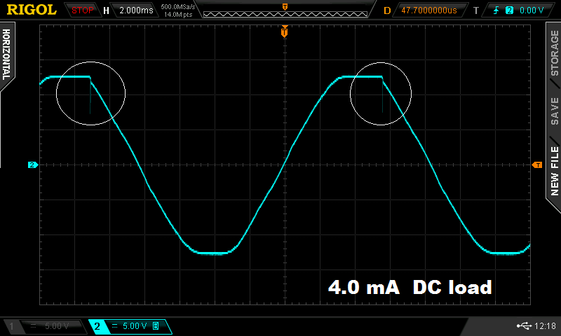

Here's a low voltage power supply delivering a low current (4 mA). The oscilloscope is measuring the voltage directly across the transformer secondary. Secondary AC voltage, with all-too-common flat top distortion found in California, is plus or minus 13 volts. RLC resonant ringing is present, even at this low voltage and low current. Some people would make no changes (leaving it in their power supply), others would snub out the ringing. It's completely a matter of individual choice.
Does the ringing get worse when you increase the load current? Of course it does!
Photos are from post #652 of the Quasimodo thread.

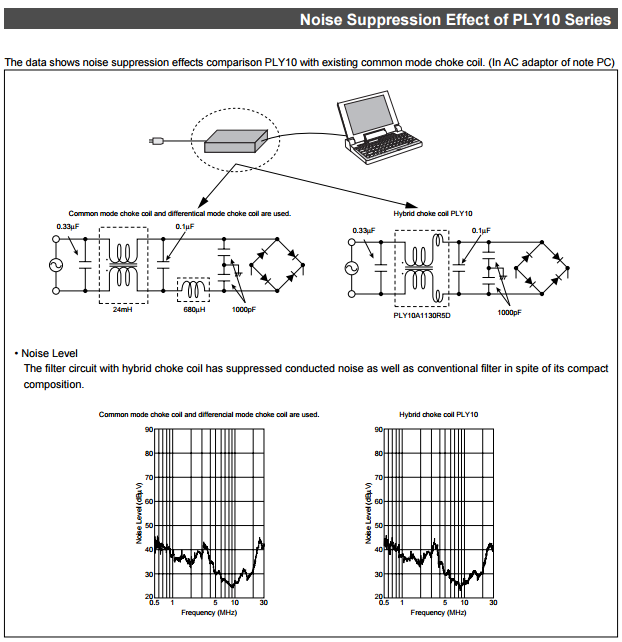

Here is the rest of the drawing from the Murata datasheet (post#11 only presented a small portion). The PLY seems to sell for USD 3.26 at Mouser. It's a shame they don't show data for a cascade of N=2, 3, 4, ... PLY modules in series, which some hobby enthusiasts may consider using, in light of the mantra "If some is good then more is better"
