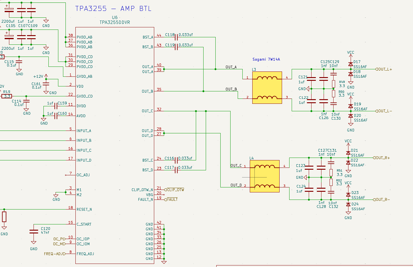

I am currently designing a 6 channel class D amplifier with DSP using the TPA3255 chips. One thing I am really concerned about with class D is the possibility of damaging the amplifier when no load is connected to the output of the LC filter. On the forums, I heard of people using load resistors to keep the amp loaded to some degree or using catch diodes to clamp the maximum LC filter to the voltage rails (PVDD and GND) so that the fly back effect does not go back in to the amp and damage the output stage of the IC. I am most keen on using the diode protection method, but where do I place the diodes? Do I place it before or after the LC filters? I seen Wondom amplifier boards place the catch diodes after the LC filter right before the outputs, but I also seen amps like the TDA7498E that place the catch diodes before the LC filters. Any suggestions?

Placing these diodes before the filter would simply be 'redundant' as the MOSFETs already have body diodes built into their structure. I would place them after.

With a Zobel network, there should be no need for such protection, as it would damp out the unloaded filter resonance to a good extent. Besides, filters are designed to cutoff just above the audio range so that they do not resonate near the PWM frequency.

The diodes should work, they will clip output signal ringing to rails.
The ringing can be way above the rails with no load which can damage the filter capacitor if not sufficient voltage rating

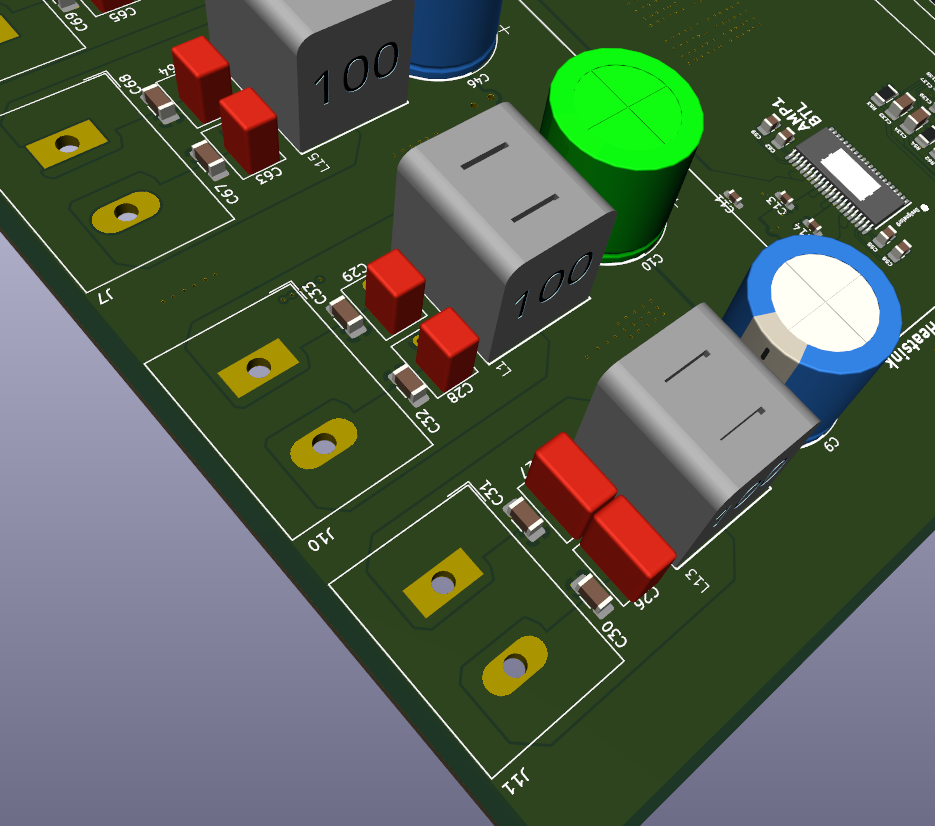

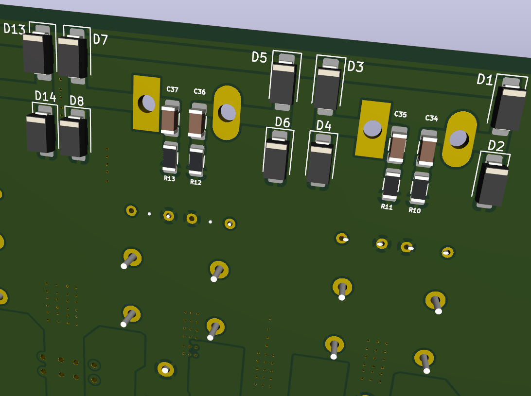

So in this case, are the caps before the diodes (1uf 100V, 1nf 250v, Zobel network (cap is around 250V rating for that one) be unprotected? And how much greater will the ringing be above the rails? Also, does this layout for the diodes on the PCB look fine?

If I were you I'd just put the diodes and finish it off instead of asking for trouble.
