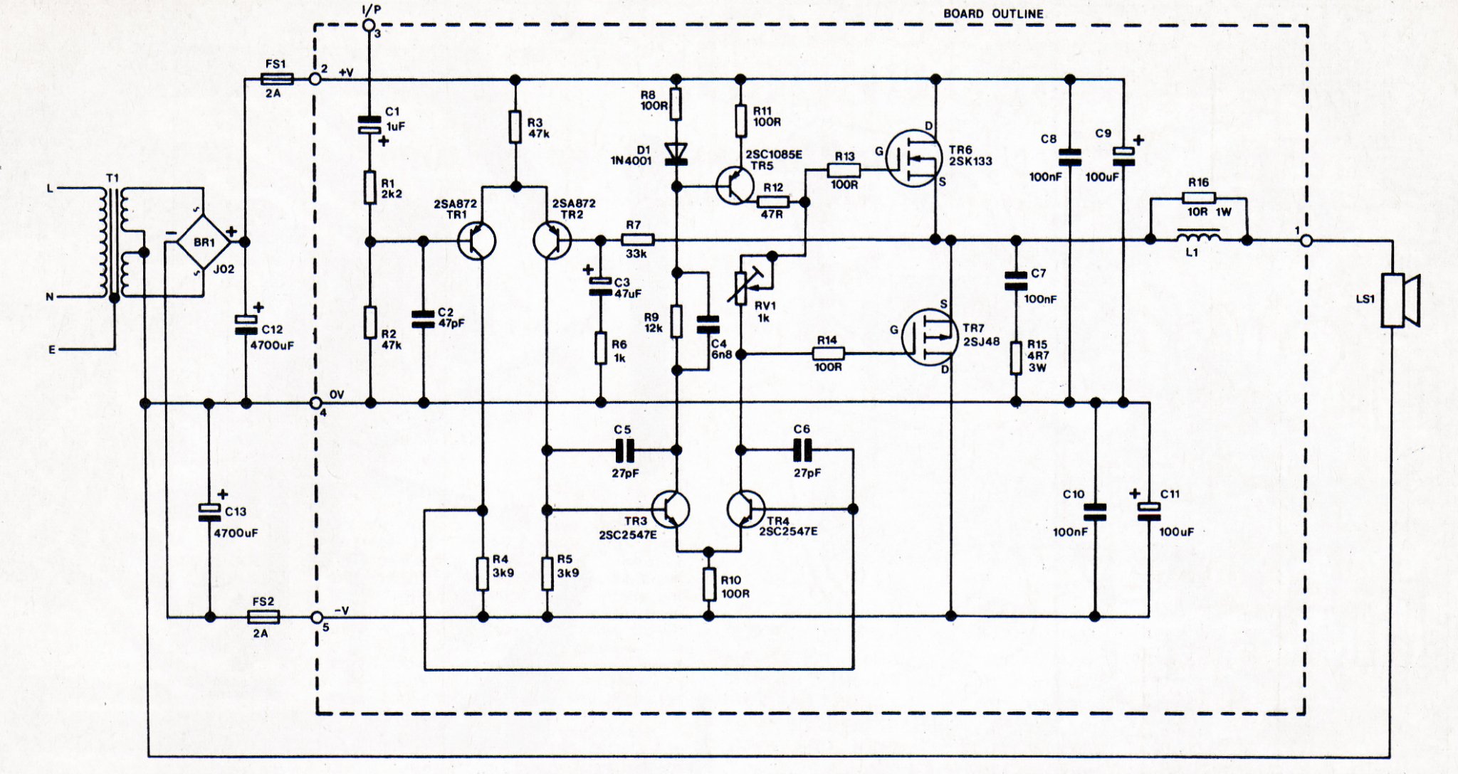

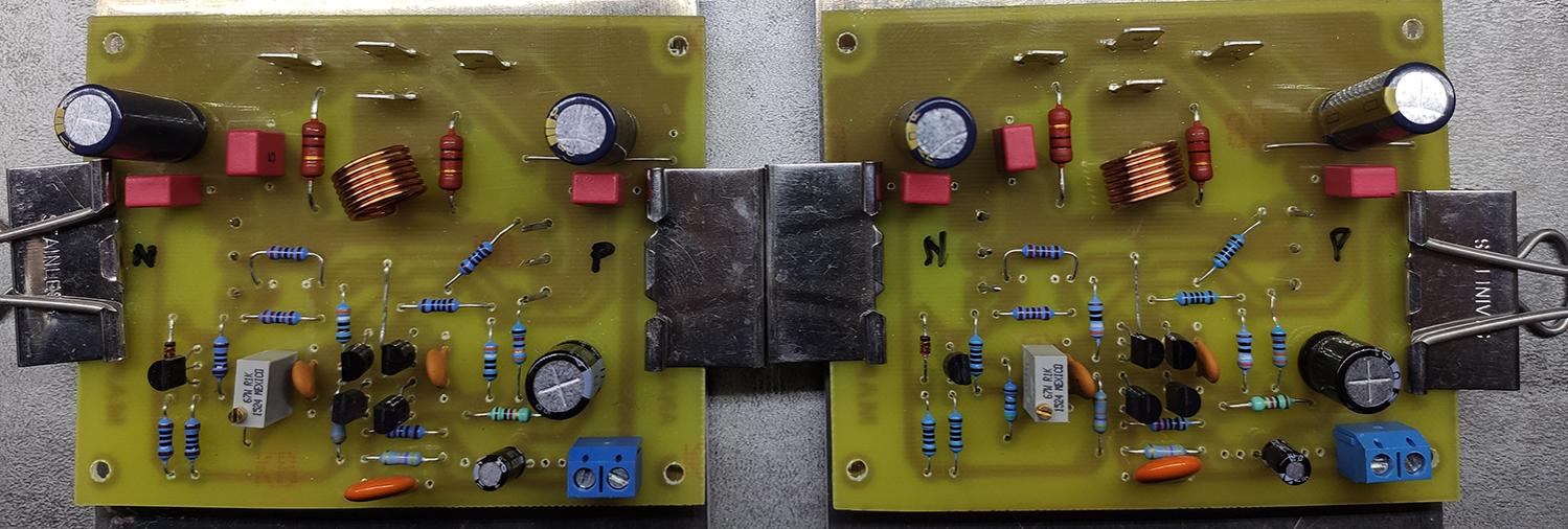

I would suggest a vintage design made very popular by Maplin in the UK.
It uses lateral mosfets outputs sold nowadays by Profusion (also in the UK I think).
Probably the simplest design you can get for that sound quality and power (~50W/8ohms).
PCB shown was drawn by Prasi, an active member here.
Works surprisingly well.

Gosh, that brings back memories. I shall have a look around and see if I can find any noise measurements for it. As a design I perhaps like the vhex+ more, however I have some of the output devices mentioned for the maplin amp. So it is well worth knowing about; I might build one, whether for this application or another.I would suggest a vintage design made very popular by Maplin in the UK.
