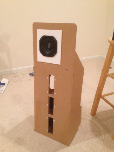

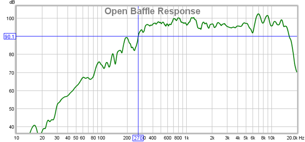

I proceeded to mount it to my cardboard test OB "Cheap and FAST, Literally" setup after making a new foam core adapter plate. Here is a photo of the setup. The driver is offset so that the center is 5 inches from the side and 5.5 inches from the top in a 12 in wide open baffle with small wings on the back. I hooked it up with the mic on axis at 1 meter away and took this measurement:

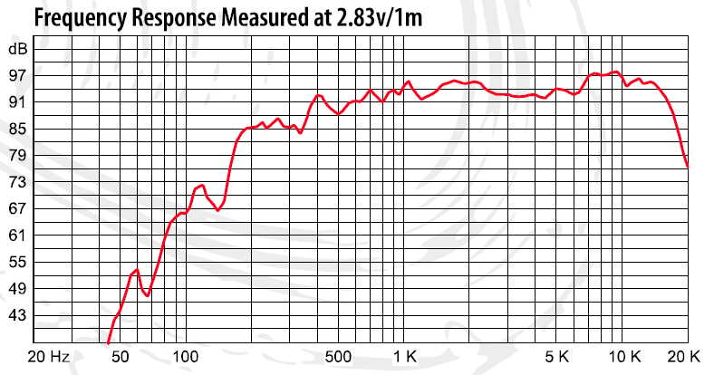

Here is the factory frequency response data:
I was really shocked by how good this measurement looks, and I think that you will agree that may even be smoother than many a more expensive 95dB class full range drivers out there with names starting with an L or F. None of them will match it in SPL capability. Many folks will be perfectly happy with 15kHz highs, and a helper super-tweeter can always be added for more "air". The bass starts falling off at 340 Hz here, and that is consistent with a 12 in wide baffle with a one inch offset mount.

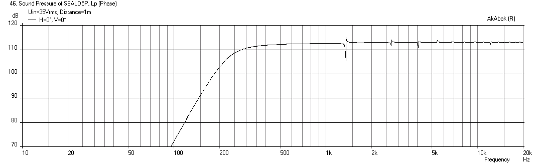

For a simple yet high SPL capability, high passing at about 230 Hz (in a 6 liter sealed box) lets you put into it a solid 200 watts RMS for 113dB SPL (xmax limited), and still stay below the 250 watt thermal rating. If you front-horn loaded it, you can get some amazing SPL's in the 120+ dB range. Here is the prediction of the SPL in a 6 liter sealed box (Q=0.707) with 35 volts rms of drive:

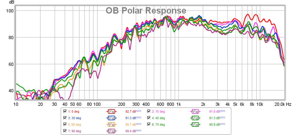

Polar & HD measurements
I took some measurements of this driver at 1 meter away in the OB shown on post 1 at the following angular positions: 0, 15, 30, 45, 60, 75, 90 degrees:

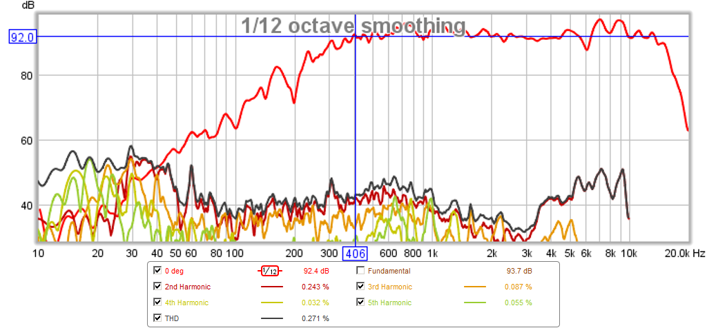

Here is the distortion at various harmonics at about 92dB SPL:

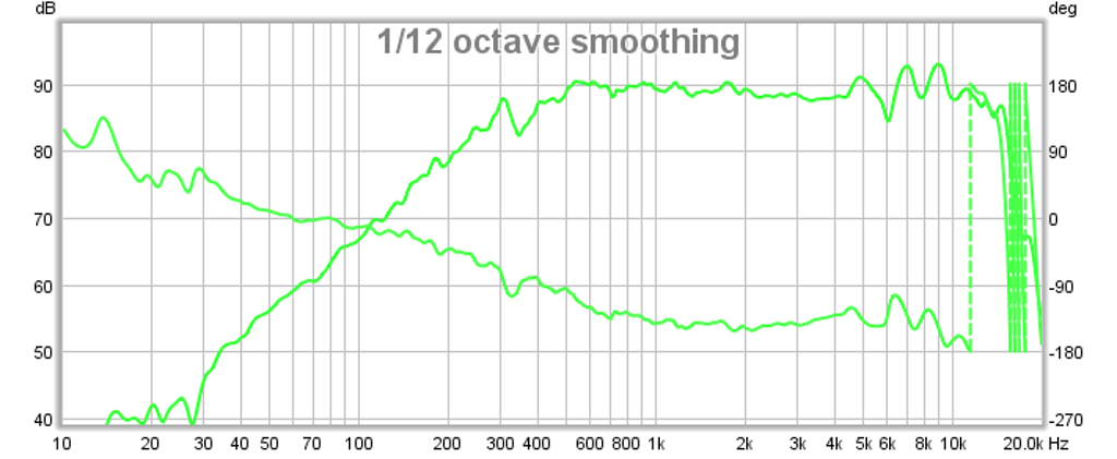

Here is the nearfield (0.4 m) showing the phase linearity of the point source:

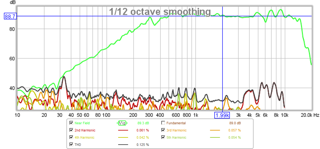

Here is the nearfield (0.4 m) showing harmonic distortion at 89 dB SPL:

The harmonics seems are few too.
