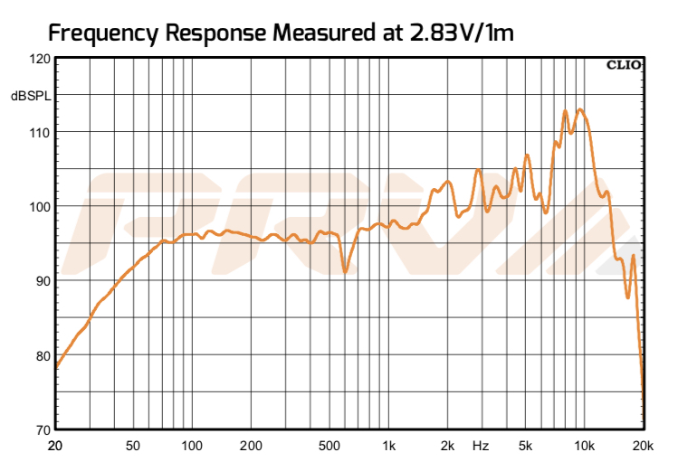

Edit: just saw that you updated post with model number - 10FR300PR. This is a new one to me. Super high sensitivity but with a dramatic rising response and peak at 10kHz. This would lend itself well to a front loaded horn to balance that out. But without a horn, that 113dB (at 2.83v) peak will need a shelving filter or it will rip your ears off with shout when played loud.
https://www.parts-express.com/pedocs/specs/294-2888--prv-audio-10fr300pr-spec-sheet.pdf
Published response:
If you want a full range from PRV, I have used the 5MR450NDY. There is a good thread on that here:
PRV 5MR450-NDY for FAST/WAW applications
For first build with full range drivers, I would suggest a 0.40x scale Karlsonator with either a 3FE25 or TC9FD. If you want more bass, try 0.53x with dual 3FE26-16 in parallel or dual TC9FD in parallel. Both are wonderful sounding. The little 0.40x scale with a single driver is very high bang for the buck, and easy to make. Make it out of foamcore board if this is your first full range project. No tools or sawdust. Cheap and sounds great.
Mini Karlsonator (0.53X) with Dual TC9FD's
Published response:
Edit: just saw that you updated post with model number - 10FR300PR. But without a horn, that 113dB (at 2.83v) peak will need a shelving filter or it will rip your ears off with shout when played loud.

I'm very interested to learn more about what peoples' experiences are with this driver. A friend of mine is interested in 'big but low cost' sound for a big indoor equestrian riding arena, and I've been kicking around the idea in my mind of mounting one of these in the middle of a 4x8 sheet of plywood, oriented long side horizontal (aiming to get rid of baffle step), with a sonotube well-braced off the back to get to the 4.30 cu ft that Parts Express says will give a lower f3 of 38hz.
Only know what the published specs tell me below its ~180 Hz upper mass corner and that a rectangular baffle's BSC point will be somewhere between its two sides, so will need [2] 4x8 shts. just to get it down to a ~90.5 Hz/F3, plenty good enough for PA.

Can someone recommend a simple series inductor value to help flatten the rising response of the PRV 10FR300PR--so the driver can be assessed as a balanced full ranger? Or more complex circuit for OB use?
Good question. I'm not the one to answer it as I have a very basic understanding of all the factors involved. Looks like using a .85 mh inductor would start the roll off around 1500 hz, then it would become less effective as the impedance rises with frequency, but maybe not enough? Would you need a resistor in parallel with the inductor?
as a direct radiator (vs mine in a Karlson coupled cavity box) it would probably make sense to approach the rise with a regular baffle step filter - perhaps use one leg of an L-pad as adjustable resistor in parallel with the inductor and adjust that resistance to taste or measurements for the best overall subjective balance - then replace the L-pad with a fixed resistor.
Hmm, with a 0.27 mH [Le], there's no impedance rise to speak of and with a ROT calculated transition to TL mode BW of ~754 Hz combined with huge whizzer, this rise is all the whizzer and its 'hot spot' attachment, so as I originally suggested, using acoustic solutions to acoustic problems would be best overall; otherwise a 1st order XO around ~754 Hz* is a good place to start electrically for on axis listening or treat it as a frequency contour shaping filter [RLC] as Freddy recommended to fine tune it.
*1.17 mH based on HR calculated ~5.534 ohms impedance, online 1st order calculator: 2-Way Crossover Calculator / Designer
