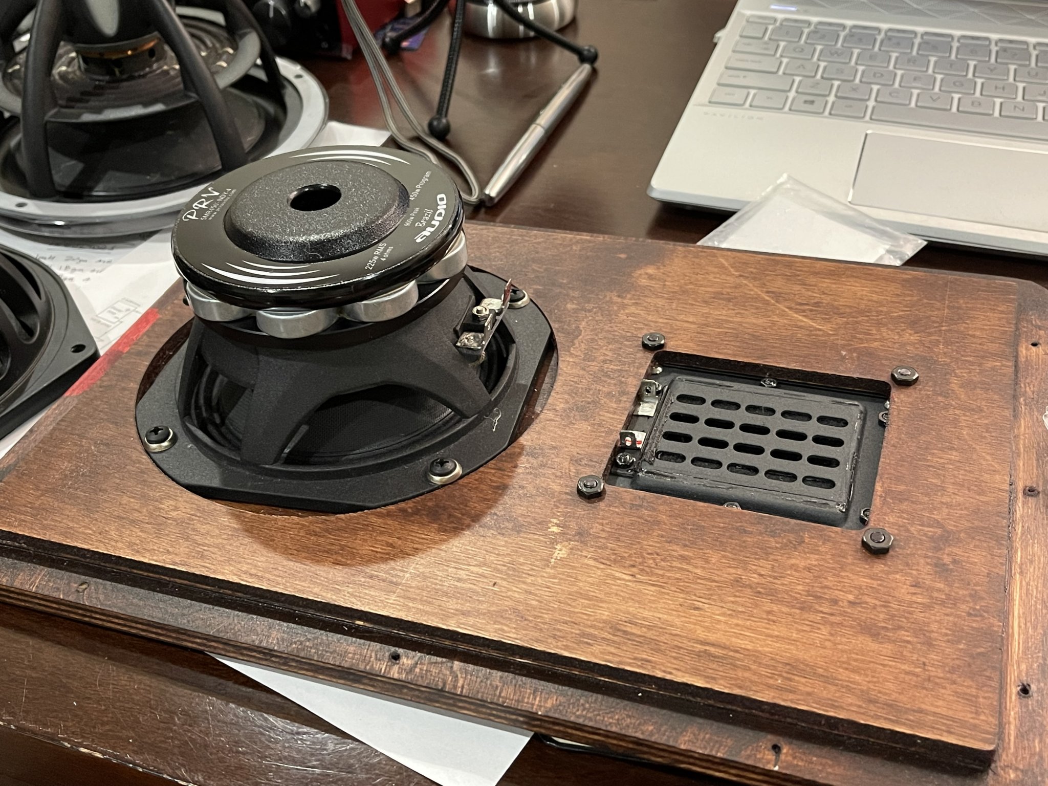

I don’t know about woofers but their 5MR450NDY midrange is one of the best sounding drivers I have heard. Very well built with cast baskets, neodymium motor, copper shorting rings etc. You can see where I am using it here from 470Hz to 4700Hz. Nearly most of the important mid range. I have actually used it as a full range up to 12kHz before. Below I am using a planar tweeter above 4700Hz.
