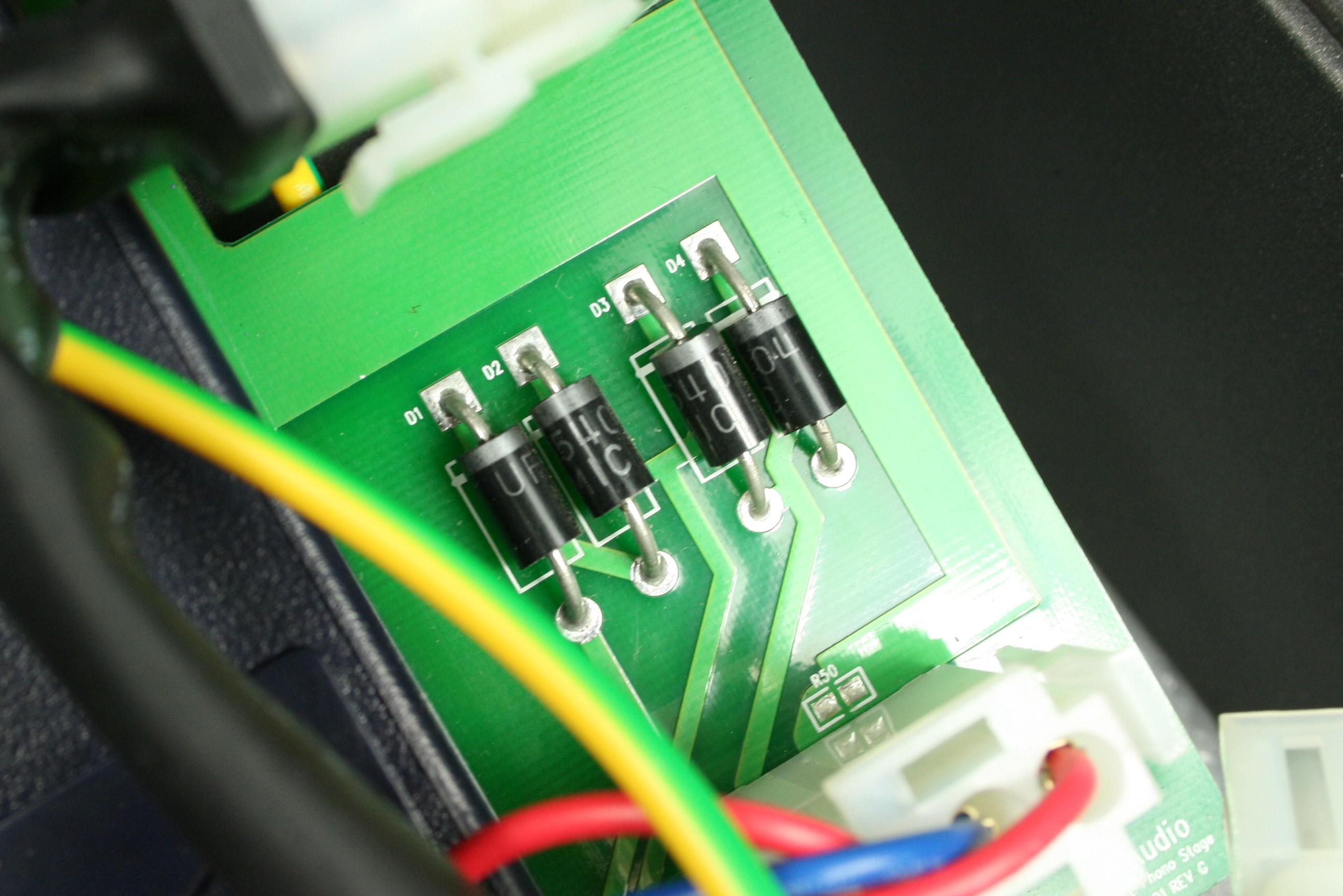

The (4) diodes which need replacing I believe are the ones located to the lower right on the board (when viewing from above) situated in a row. The (4) electrolytic caps I believe are the small ones located in pairs to the middle left and middle right and just in front of the large caps on the center of the main board. The 1/2 and 1W signal path resistors though I am not sure of and have no idea of how to locate without a schematic or service diagram. The other parts and their locations are just speculation but I think my guesses are logical? Could be mistaken though.....😕
Any thoughts?

Thanks, had not considered removing the gain cells for inspection of input signal. My thoughts were the signal path resistors were the tiny ones located in pairs just under the right and left channel pairs of electrolytic caps in the picture. Of course this was merely speculative.
Close up of the diodes also attached.

Google is your friend-the three pin devices with the heat sinks are very likley the main voltage regulators (there may also be secondary regulators, much smaller, as 6 pin ICs on the board). Read the part number on the the three pin devices and use the internet to find out what they are and relevant specs.
The main power supply diodes will be easy to find by locating the input traces from the transformer. The first components the power hits after the transformer will almost certainly be the diodes-these are the black tubular shaped components with the silver ring at one end. They will also be marked on the board with a designator: D followed by a number (likely D1, D2, D3, and D4). Replace these with something which features really soft recovery (read data sheets). I would replace the main power supply caps (the big ones) with something really good, a high quality compact cap that will likely fit is the Mundorf Mlytic.
