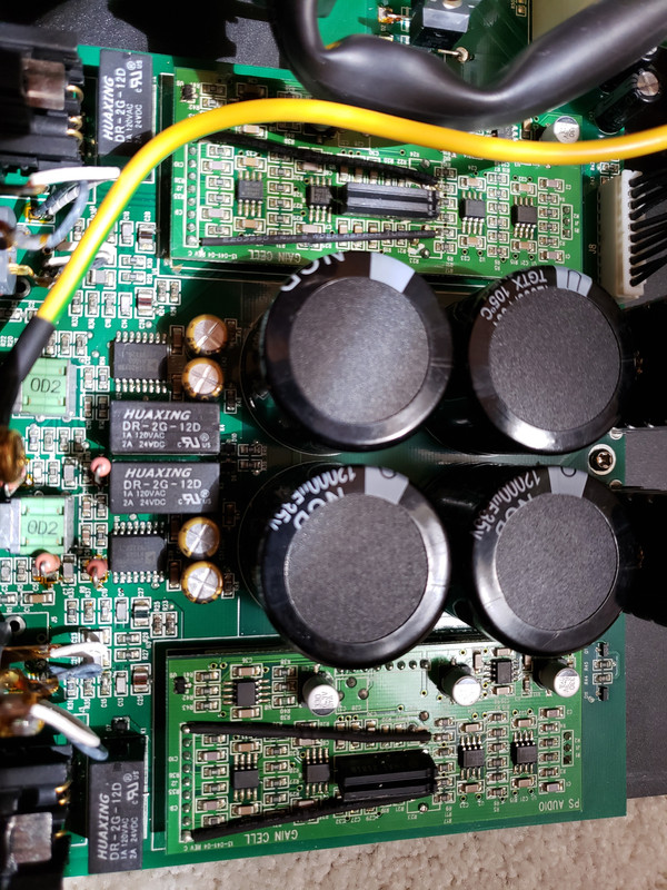

Hi. Lately it seems all my equipment is giving me greef… My PS Audio GCPH has developed a peculiar problem: if I don’t use it for a few days, left channel dies, but only on RCA output; on XLR output it works, but not as loud as it should be; right channel has nearly zero DC on output (0.1mv), and it does not change when I turn volume knob all the way up; left has about 1.3mv, and it goes higher and begins to cycle between about -6 to +6mv on full output. I wonder if it’s a simple re-cap job, or is the output chip kaput? I managed to find a reverse-engineered schematic online.

Sounds like one phase of the left channel is out.
That would cause a 6dB loss at the XLR output, and
would be the positive phase output to kill the RCA output.

That’s what I thought. But why would it come back and work fine if I leave it on? It almost seems like there’s a cap leaking somewhere. I’m posting a picture with plastic covers removed from the gain cells. There are three electrolytics in each.
Left channel comes back after a few hrs of I leave it on, and keeps working, even after I turned it off for a few hrs. Weird. Seems like a leaking cap somewhere?
Could be an electrolytic (not so likely), or more likely just a bad solder connection.
Those can be difficult to find with SMT.
The schematic will help to narrow things down. Can you take some closer, very sharp photos?
I will. The pictures I posted are not from mine, I didn’t open mine yet. Just getting over a “pi…d-off” period )))
