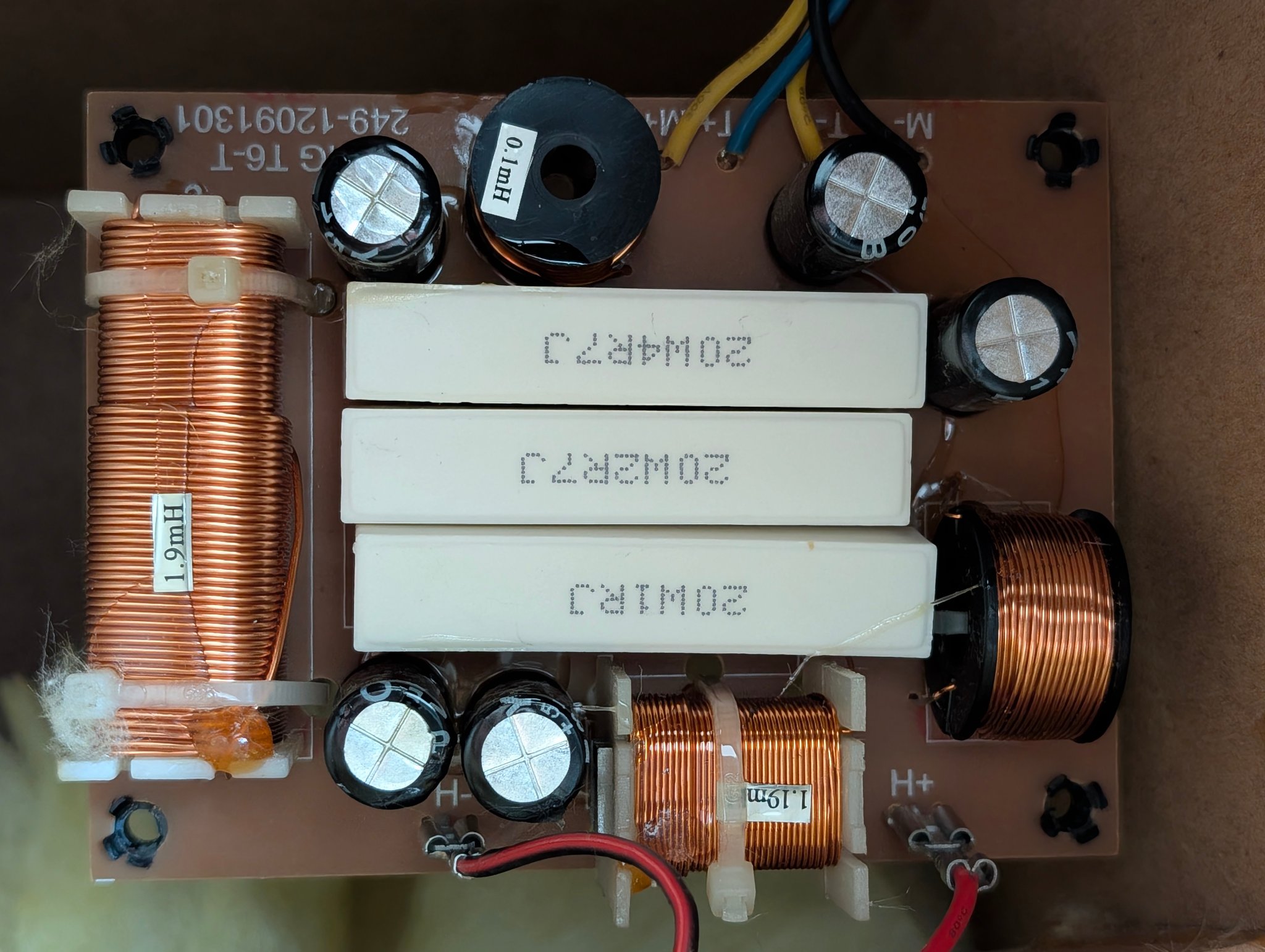

Next up check the 2 crossovers, first is behind the terminals and a second which behind the tweeter.

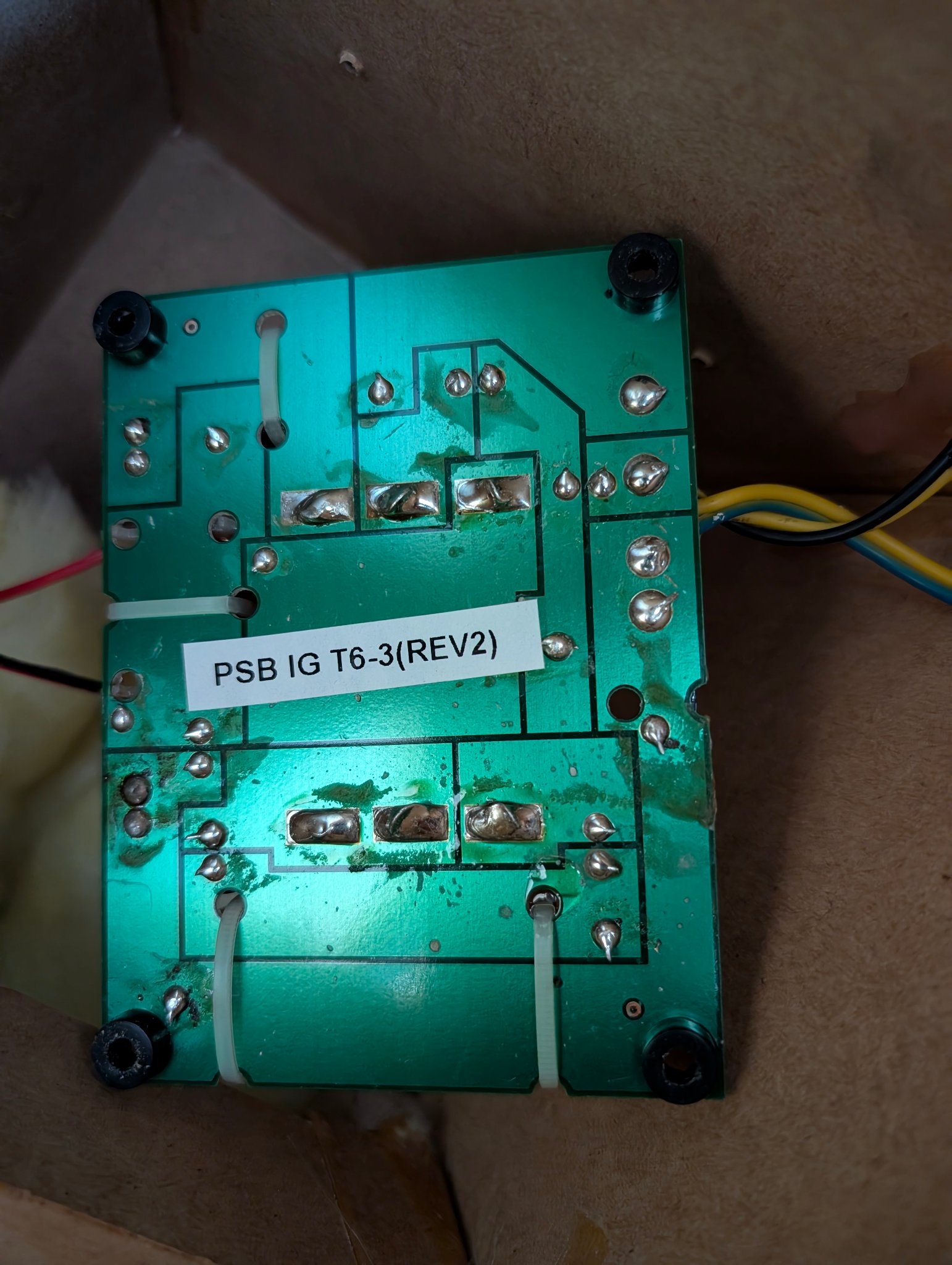

Nothing appears to be bulging from the top and most components look to be in reasonable condition, upon checking the undersides though it appears there is some residue of some sort which brings me to my first question.
Does this suggest that due to the age of the speakers(roughly 20 years) they could be leaking and be causing audio degredation?

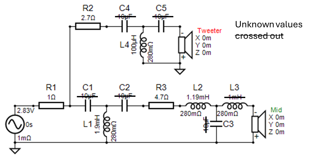

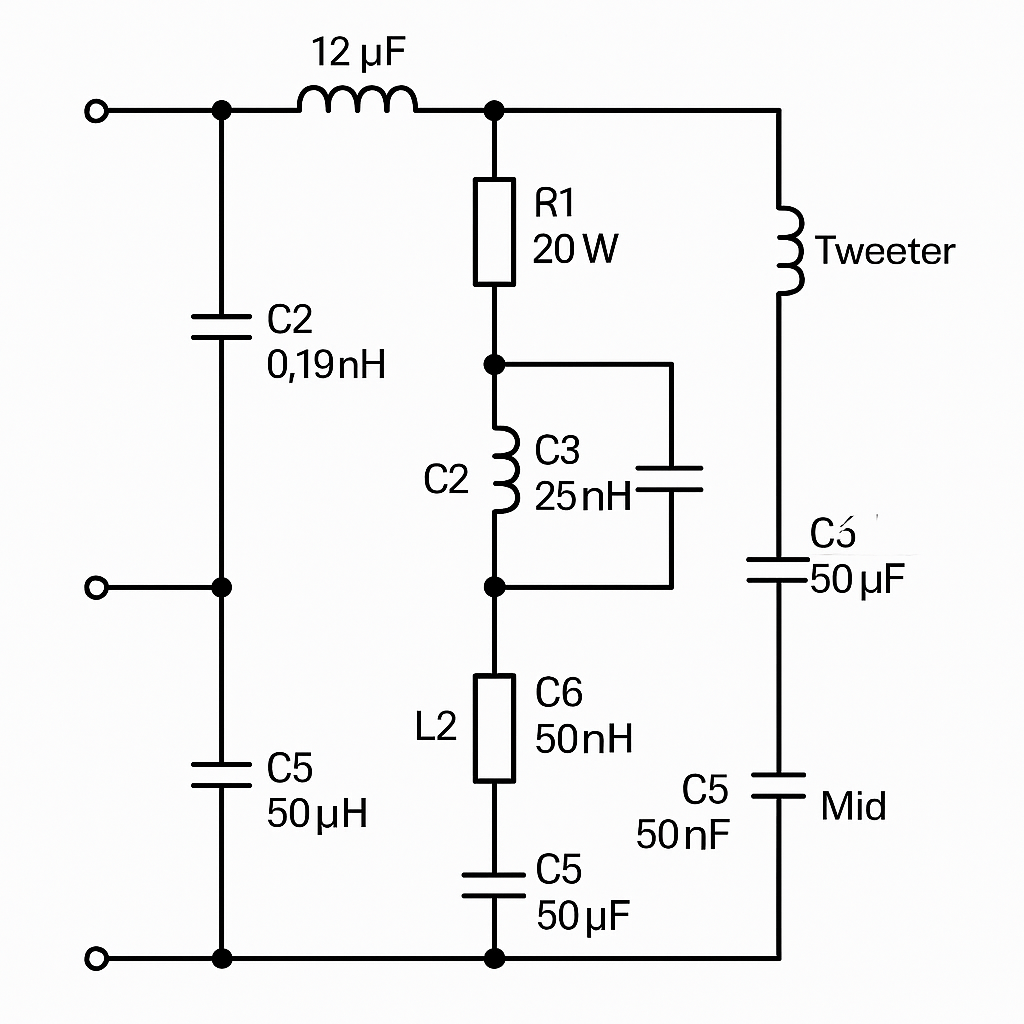

I had Chatgpt draw me up a diagram to help with swapping out components for new which I hope is accurate?

Aside from the possibility of some damage to the drivers, these are hands down the worst speaker crossover parts out there.
Chat GPT has no idea, that diagram is nonsense. 🙄
You need to find someone who knows a little about speakers if you want to have schematics.
You can clean the PCB with isopropyl alcohol.
The only thing you can do is to find new such radial bipolar electrolytic capacitors with identical values of capacity, voltage and physical dimensions and replace them.

Thanks for the reply.
Will clean up the PCB as you suggested,
Finding the right values as radial electro caps is proving to be difficult, all the electros I can find are axial with some needing to be paralleled to get matching values, I was wondering if it might be worth replacing them with poly caps if they can fit and not cause any other issues.

There is a big difference in ESR, so when you replace electrolytes with polycaps, the whole crossover is disturbed (crossing frequencies depend on resistance). I advise people to always replace with the same type of capacitor so that there is no need to redesign the crossover.
Reactions: Sonce
I don't see any room for polycaps there. There is a big difference in the ESR of bip. electrolytes and polycaps. The replacement disrupts the entire crossover because the crossing frequencies depend on the resistance. Capacitance and ESR deviations are particularly problematic with higher order filters.
