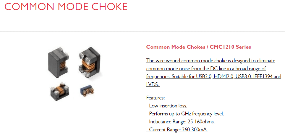

Even if there was some measurable noise on the grid ( which i am not saying there is ), there would be more than enough to use an LC filter ( an EMI filter would do just fine ) before the power transformer, also it is good to remember that 50-60hz transformer has poor performance at high frequencies, meaning any HF noise wouldn't get past it anyway, and what does get's trough, it smoothed by the filter caps and rejected by the amplifier's PSRR.
Our friend Raimond and his wealthy clients wouldnt agree on that because spending wealth is its own truth...Some still need to discover the common mode choke...while not many transformers windings are done the best way cause a transformer by itself can lower the noise if properly designed. https://ieeexplore.ieee.org/document/5433416There are people who innovate, and there are people who waste time and money on audiophile bullsh....

Well...it was just a wrong idea to give these options a chance ...and after you read what a common mode choke is you should understand also why, but if you still cant understand that , then maybe you should just spend all of your money on these things and then tell the same bullsh...to others so that you have a chance to sell the useless stuff you bought! That is actually the main reason why people who buy into expensive cars or luxury watches need or life style are still advertising them after the purchase...cause they need to sell the f...ing things and that cant happen if you tell others that you spent a whole load of money on a stupid useless thing...Jesus Christ it was just an idea...

Well...it was just a wrong idea to give these options a chance ...and after you read what a common mode choke is you should understand also why.
