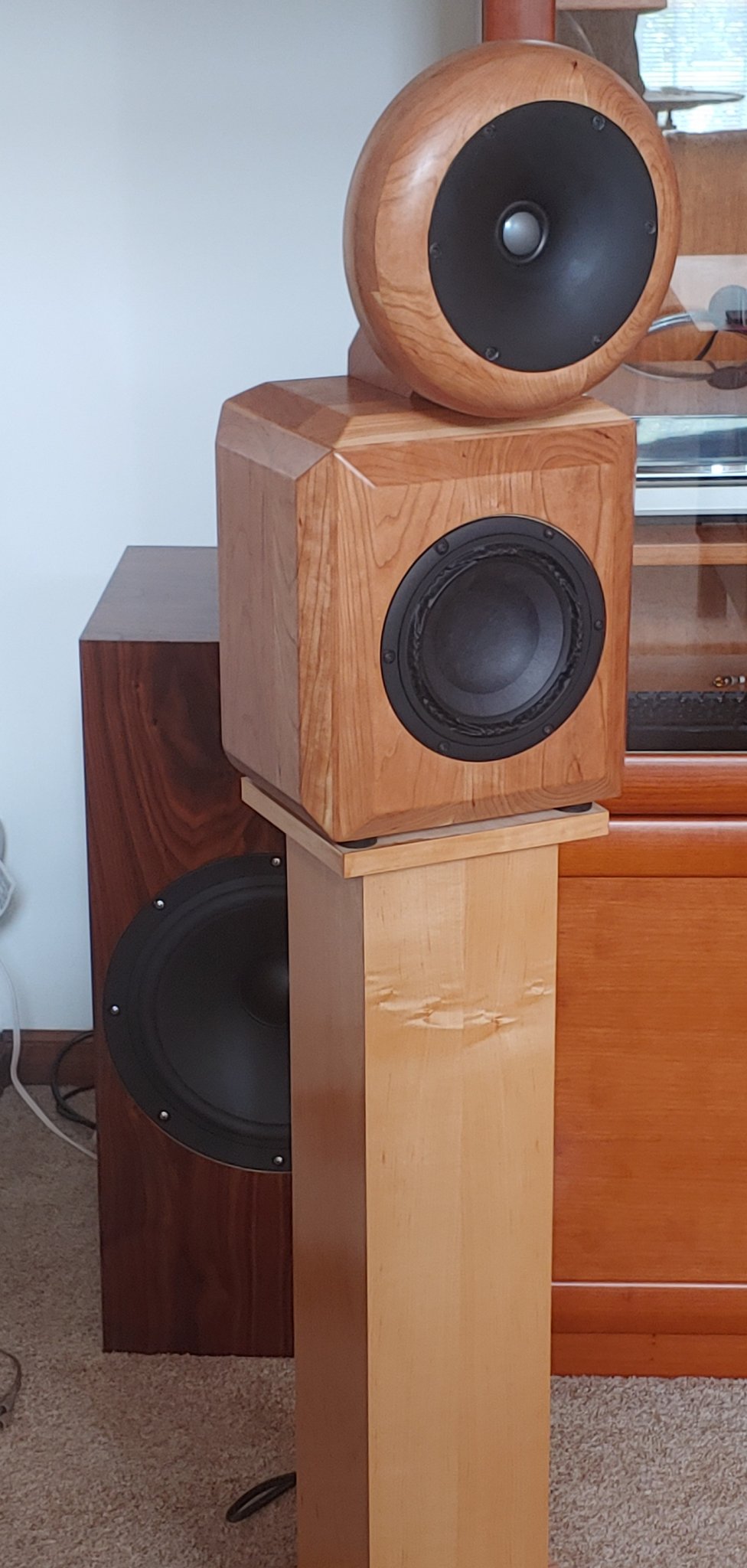

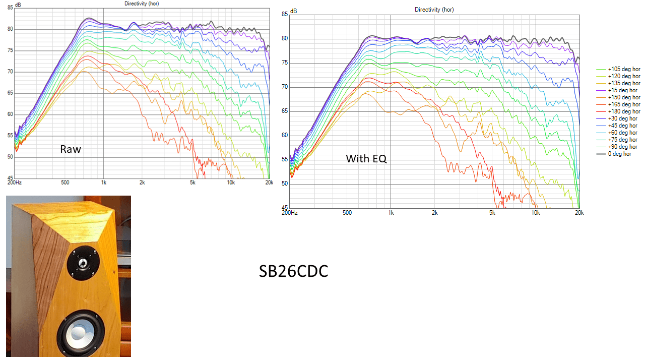

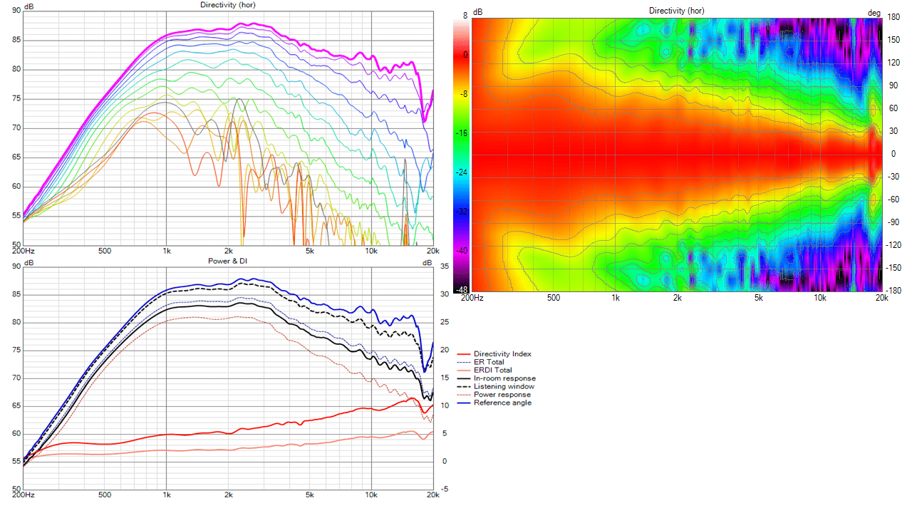

Before any preliminary simulation can begin, I need data to drive the simulation. With ordinary direct radiators, VituixCad provides a tool which uses an ideal piston model, and this is close enough to simulate an ordinary cone or dome driver. However, waveguides are different. I needed the waveguide tweeter to take some measurements to drive the simulation.
I chose the Satori TW29BNWG tweeter for this project. It has the same motor system as the TW29TXN-B (a driver I am so impressed with), and it has a beryllium diaphragm which I like. The waveguide seems intelligently thought out. It may not be the very best waveguide tweeter for a project like this, but it meets my needs and it is very convenient, pre-assembled, and readily available. The waveguide version of this tweeter is about $100 more than the standard flat-face TW29BN-B, and that seems reasonable for an aluminum waveguide.

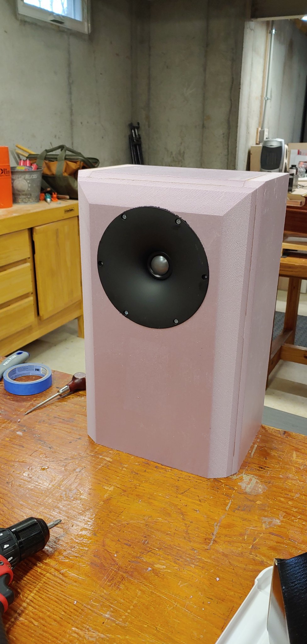

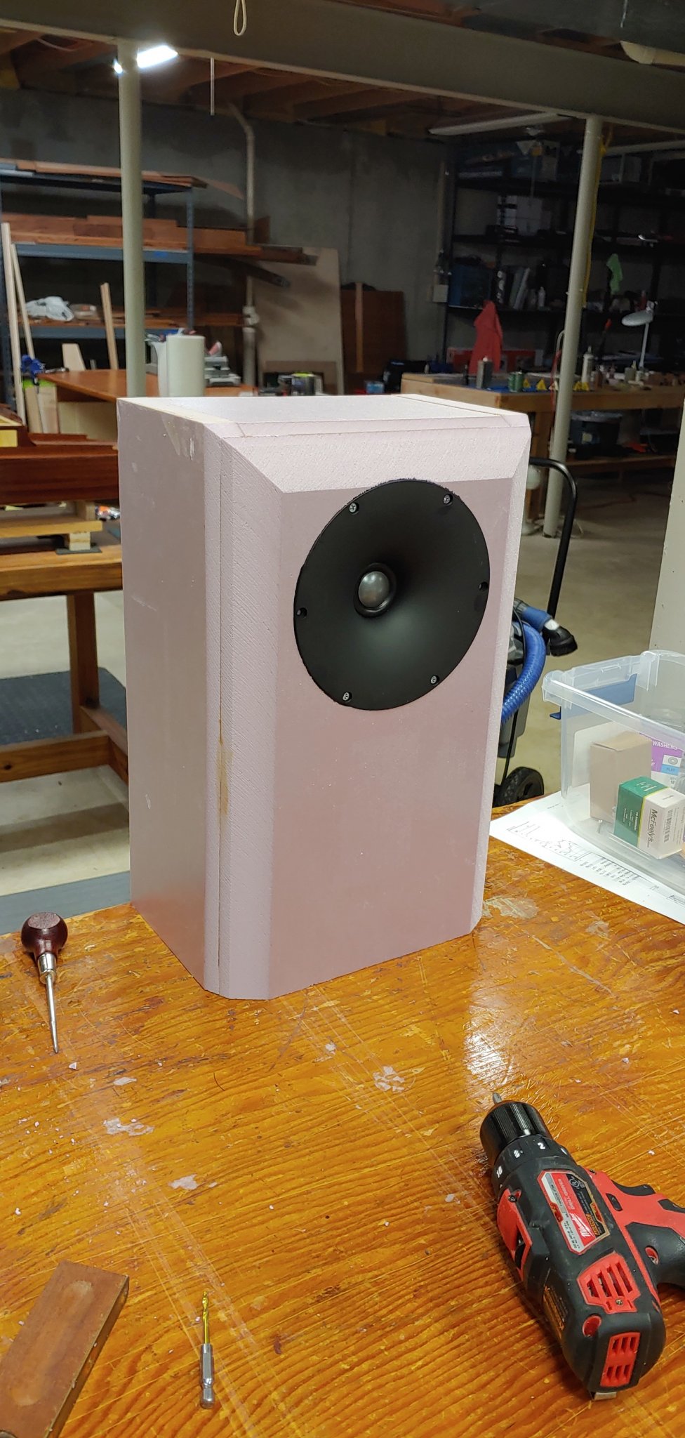

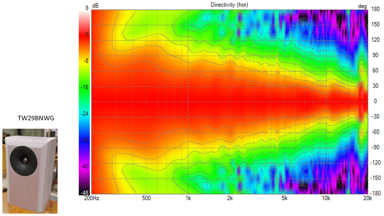

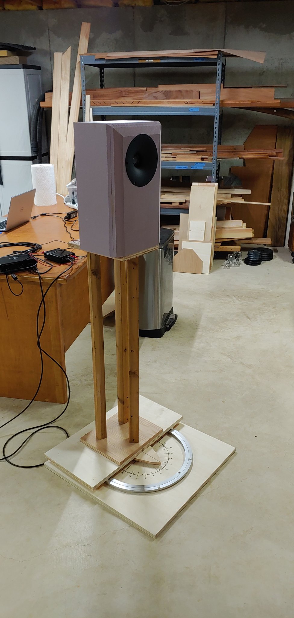

I made a prototype box from XPS foam to take horizontal polar measurements. The box matches my preliminary design dimensions for the new head unit. The bevel on the sides and top is a compound 30-60 degree bevel of 37 mm depth. This approximates a radius of 37 mm.
The response is very different from the flat face plate tweeters I have used in the past.

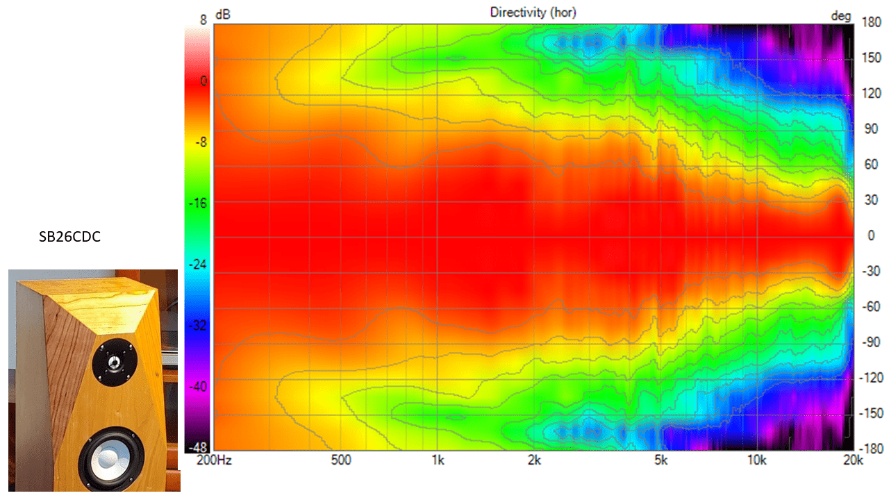

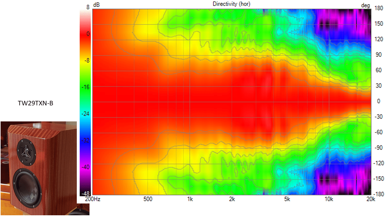

It is interesting to compare the response of this TW29BNWG to the tweeters in my other projects.

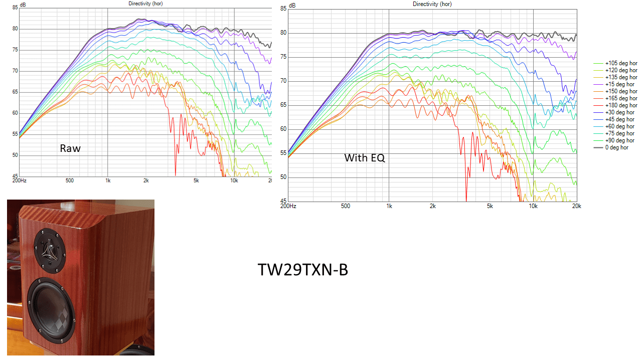

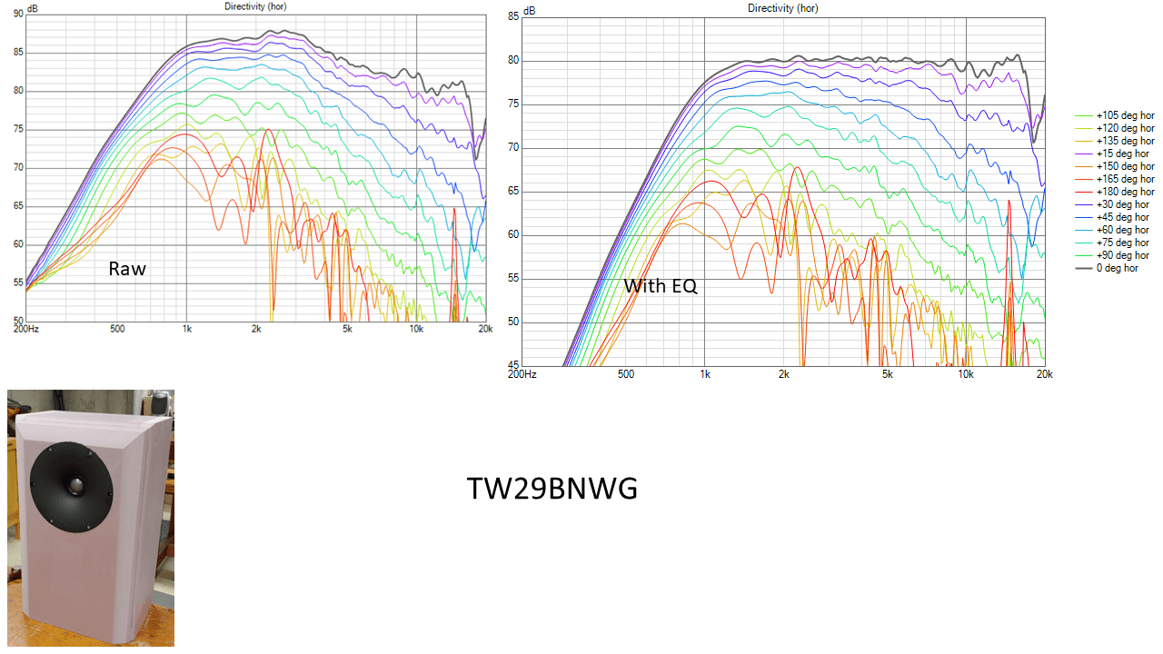

Waveguide dome tweeters need more EQ in the pass band than flat faceplate tweeters (typically), so to make a comparison that made sense to me, I used VituixCad to apply a simulated EQ to each tweeter to make it reasonably flat over the range from 1k to 20k… For me, this made it easier to compare.
It is clear to me that the directivity of the waveguide tweeter is very smooth. It very slowly and linearly increases in directivity from 1k to 10k. This should make the optimization of DI and Predicted In Room response significantly easier.

Nicely written. Some dumb questions - this XPS foam for prototyping, how does one cut the foam to flush mount a driver? Or is the front baffle not foam?
Re: 1.2 C-C wavelength -- what have your previous builds shown vs <1x, 1x, or other distances? It does look a bit weird on slide8.
I wonder if that optimal center to center spacing would change with the Z-offset the waveguide provides the tweeter, in comparison to baffle flat mount.Another thing I learned is that high CtC spacing of 1.2x wavelength works well in practice
I use normal wood working tools... table saw, router, etc... The nice thing about Dow "Foamular" XPS board is that it cuts so fast and with so little effort. Power tools cut through it like a light saber... Very safe, almost no dust,this XPS foam for prototyping, how does one cut the foam to flush mount a driver? Or is the front baffle not foam?

I might tape some cardboard to the foamboard test box to simulate a hard corner. It would be interesting.It should be useful to compare the response you got replacing the box with a similar one without bevels. In my understanding a tweeter in a (well designed) waveguide should be pretty insensitive to baffle dimension/position.
I considered making measurements of the hard-cornered box before I cut the bevels. However, installing/removing drivers from the foamboard is a difficult process since the foamboard is delicate. The baffle can be worn out with as few as 4 or 5 installs. So to play it safe, I made the bevels first and then installed the driver.

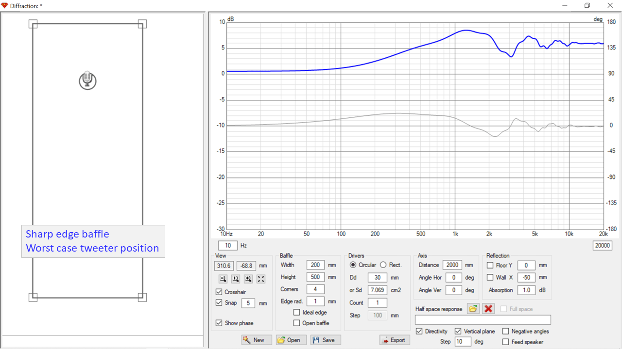

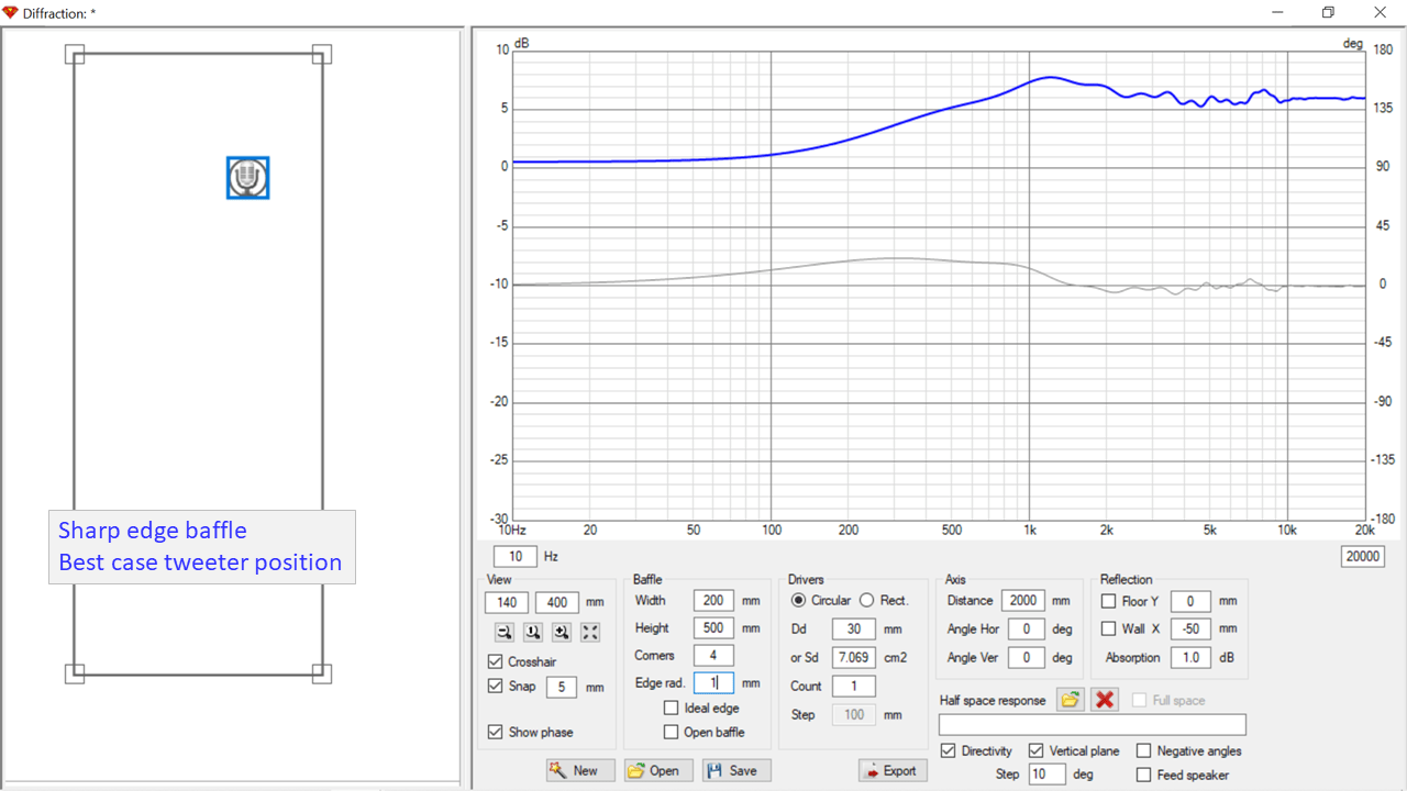

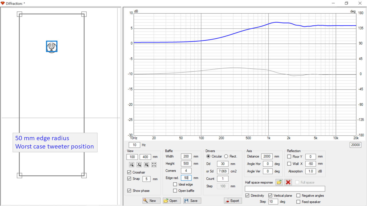

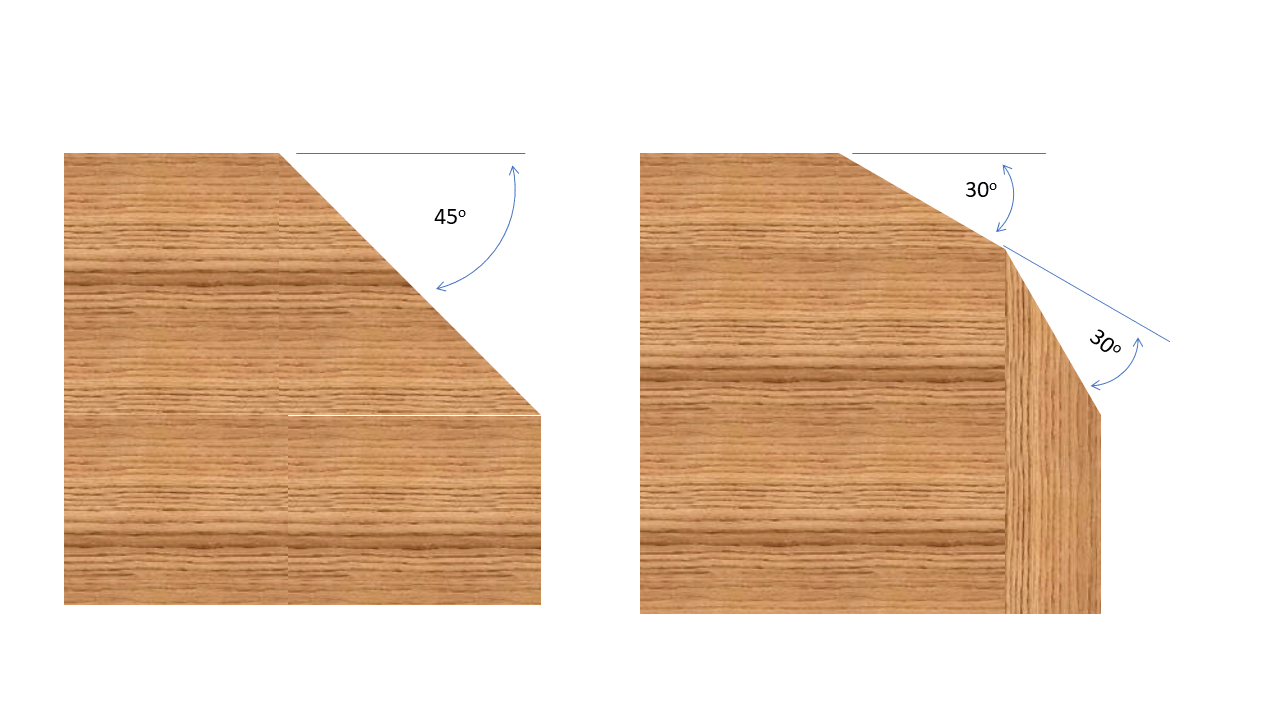

I intend this project to have generously profiled edges all the way around, front, back, sides, and top. I am motivated by the work of @Patrick Bateman and @mabat... they have shown that rounding and profiling the sides and back of a cabinet will have an effect... Mabat by simulation, and PatrickBateman by measurement. There results seem to apply to flat baffles, horns, and waveguides. My own experience has taught me that diffraction can have an impact that goes beyond the frequency response impact. High frequency diffraction (i.e. above the baffle step) in my opinion can be detrimental to the 3D illusion and sense of space, even when there is little measurable frequency response impact.
An example of what I mean: The first graphic shows a sharp edged baffle with tweeter in bad location. It is equidistant from both sides and the top. The second graphic shows what happens when a generous 50 mm radius is applied. Nearly all the high frequency diffraction effects are gone. The third graphic shows what happens if the tweeter is optimally located in a sharp edged baffle. Although it seems like the diffraction effects are greatly reduced, what has actually happened is that the diffraction peaks and nulls of the top, left side, and right side are balancing themselves out. Diffraction is still present, but when measured along this particular axis, the effect is masked. It is my opinion that we can hear a difference between the baffle of graphic 2 and the baffle of graphic 3.
j.
j.
Agreed. In addition, When viewing what happens off axis; it is even more instructive.
The tweeter can be offset (often as little as 15-35mm or so) to give an acceptably flat and smooth response on axis.
But off axis from Hor 10 to Hor 90, it all gets a bit funky.
