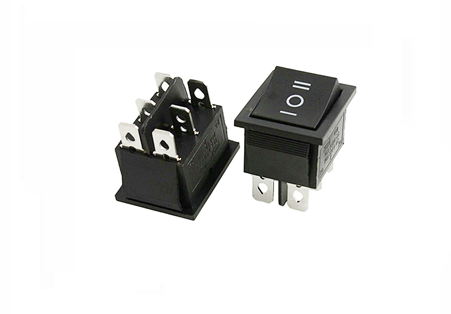

Hi guys,
I received this push button switch for my preamp. The spec says it is 250VAC switch with 12v led light. Stupid question - does this require separate 12V DC input to work?

Yes. Also be sure not to overdrive the LED... it probably has a series resistor as it is specified for 12 volts but I would try it carefully first with an external resistor and supply and see how bright it looks.

...The spec says it is 250VAC switch with 12v led light. Stupid question - does this require separate 12V DC input to work?
The issue is not "stupid question" but "stupid part".
The pins for the 12 V and the 240 look identical, so easy to accidentally connect 240 V to your 12 V circuit, or wire the 240 V across the LED.

Agree and add: given that mains switches nowadays require insulating baffles to meet creep distance requirements (depending on different Country safety rules)
I find that design putting live mains voltage in **close** proximity of "user area" wiring such as a 12V indicator ludicrous and an accident waiting to happen.

Just because the contact rating is 230A AC doesn't mean it it is endorsed to carry mains.The suitability of any component needs to be taken in context.
I'm currently building with a couple of switches like this, they have 12V across the contacts.

The spec says 3A/250VAC on/off switch with 12VDC led light. How else do you recognize that it is endorsed to carry mains?
Good question.
Because it doesn't comply with regulations such as JMFahey alludes to, and approved codes of practise. For example, within equipment it's recommended (maybe law in some countries) to switch both the live and neutral - not just one pole. Another point is that we don't know how good the internal switch construction is. Could it be possible for the insulation between the switch to breakdown to the casing, thus rendering the equipment case live?
Switches and mains parts usually have standards certification markings on them. Pull any mains plug out of the wall and you'll see markings.
That doesn't mean that a component without markings is unsafe. An uncertified component may be safe in a given situation. It's knowing and understanding that. If you're not clear of that, it's best to use a certified component.
Most of us do not have access to the documentation that sets out the rules and recommendations that apply. That's why it's a great idea for DIYers to run ideas past others who may be qualified to spot pitfalls.
