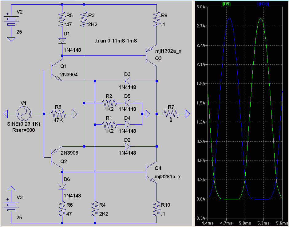

Not necessary. In my Nuclon amp both transistors always operate, either it works in class A, or mimics class AB: just current limiting capability stays above driving requirements, dynamically.

Anatoliy, are you saying ur output stage prevents turn-off, or that you can bias it into Class A and have current limiting?

Hard to see in the posted sim, because the devices seem to be hitting "0".

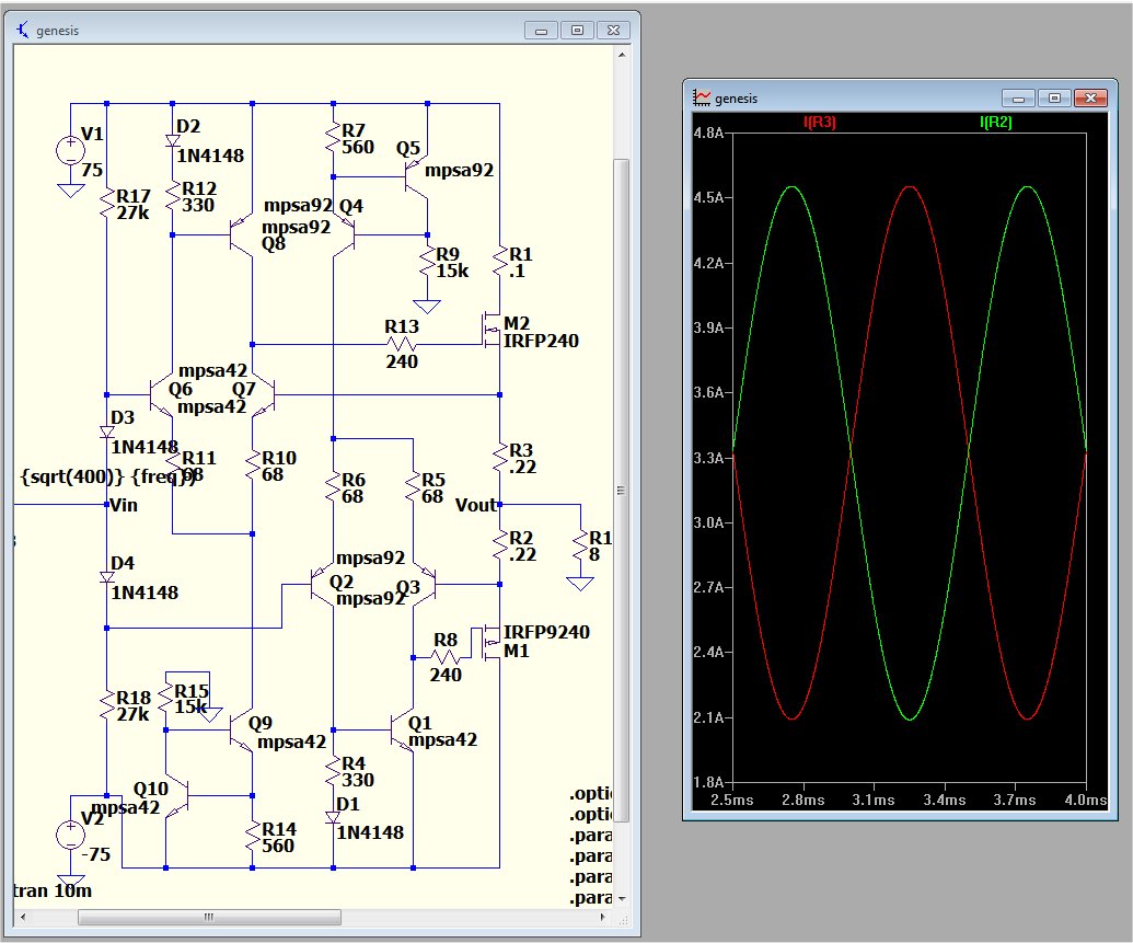

Ostripper wrote: "Might make the room too hot !!
8 of the amp(lets) (below) , let me shut off the heat to the living room !!
HUGE heatsinks + 2.4KVA of trafo !
PS - each was biased to 2.4A (always on -true class A)
OS"
Your oscilloscope trace shows full waveforms, but they are out of phase with each other, indicating this is a balanced design, rather than a push-pull design.
Yes, it does not turn off, just current limiting follows by driving requirements. It is such a sneaky symmetric opamp with unity gain, and "short" tails in diffpairs that are getting even shorter when it simulates "clas AB". You may see on the right, how currents change with signal.
