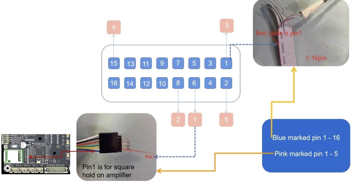

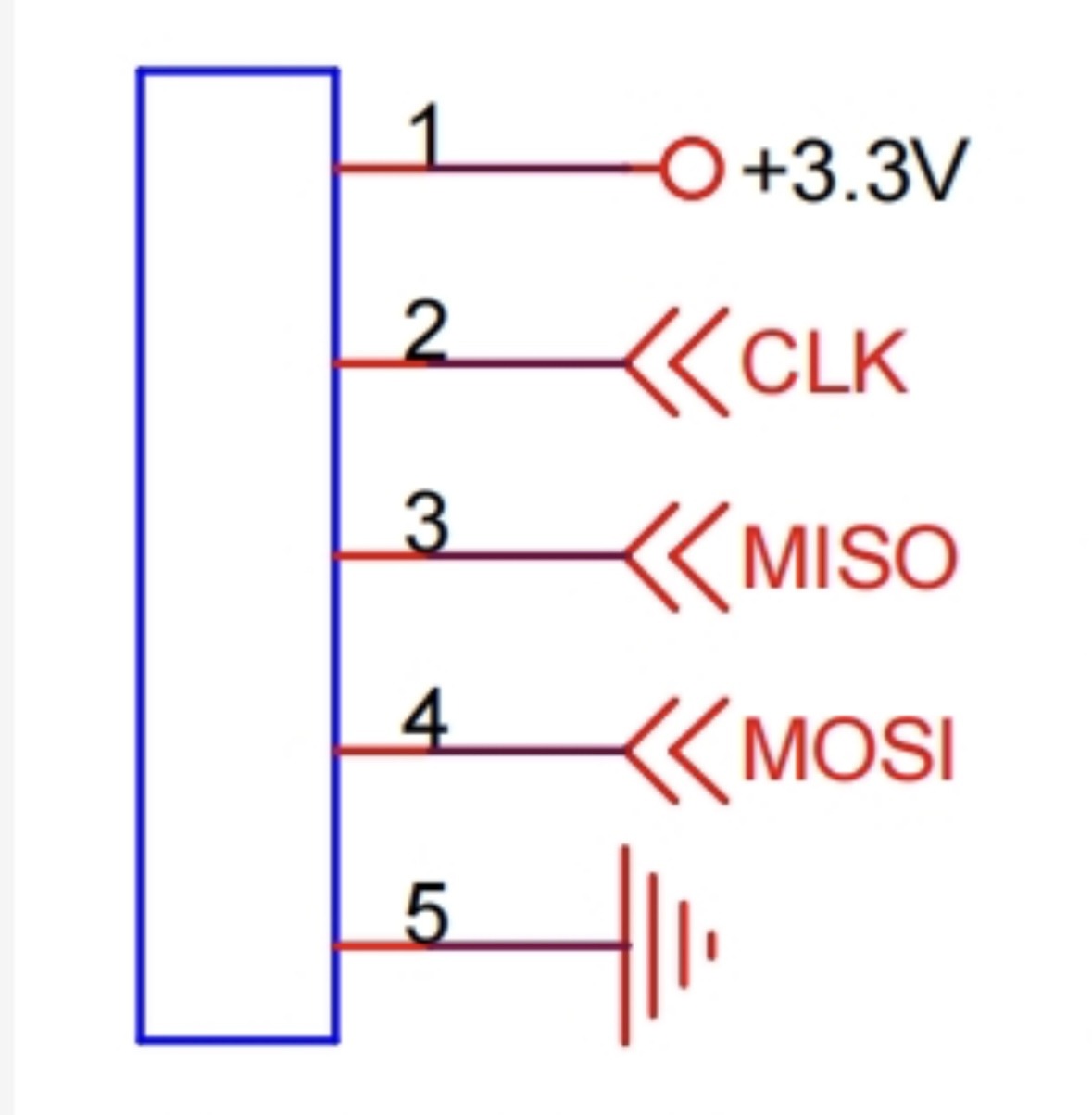

@Katra
I know this is an old thread, but I wanted to let you know that I was able to connect to a Wondom JAB3+ with the TRBI200 and change the Bluetooth name. I’ve also been able to add event tones with ADK Config. Tool and connect to QACT. I believe the TRBI200 drivers are in the USB debug driver package in Bluisuite. I’ll have to double check when I get to my computer.
I have attached the pinout that was emailed to me from Sure Electronics. This seems to be a universal pinout for all of the Wondom/Dayton Audio amplifiers/BT receivers that have QCC3034 chips.
Note: The square pin on the board is pin 1, 3.3V.
Let me know if you have any questions.
Cheers!
