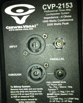

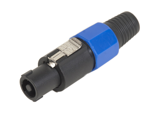

Setup: I have three similar cables that looks like this in both ends: http://www.diyaudio.com/forums/attachment.php?attachmentid=394219&stc=1&d=1389921281
The backside of my speakers looks like this:
http://www.diyaudio.com/forums/attachment.php?attachmentid=394224&stc=1&d=1389921959

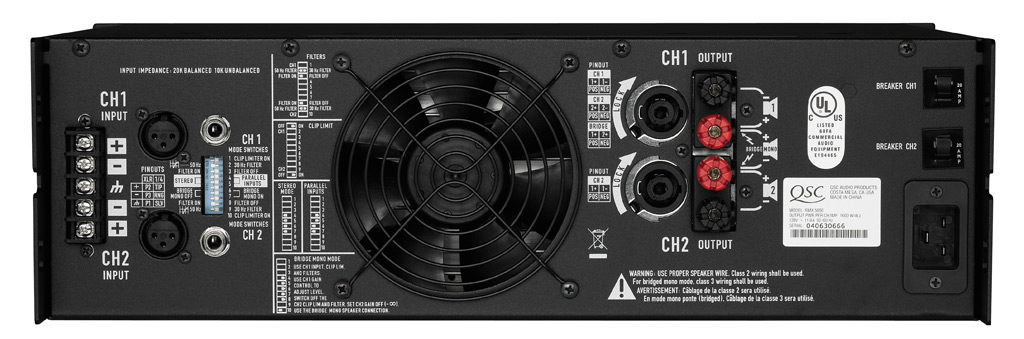

First cable goes from CH1 (amplifier) --> "Input" on speaker 1
Second cable goes from "Trough" on speaker 1 to "Input" on speaker 2.
Third cable goes from CH2 (amplifier) --> "Input" on speaker 3.
yes, "but the voice coils plays" means that the tweeters do work, but they plays really fuzzy, like a bad radio signal.
what i ment with "...three speakers, so one speaker is bridged": one cable goes from "Trough" on speaker 1 --> "Input" on speaker 2.

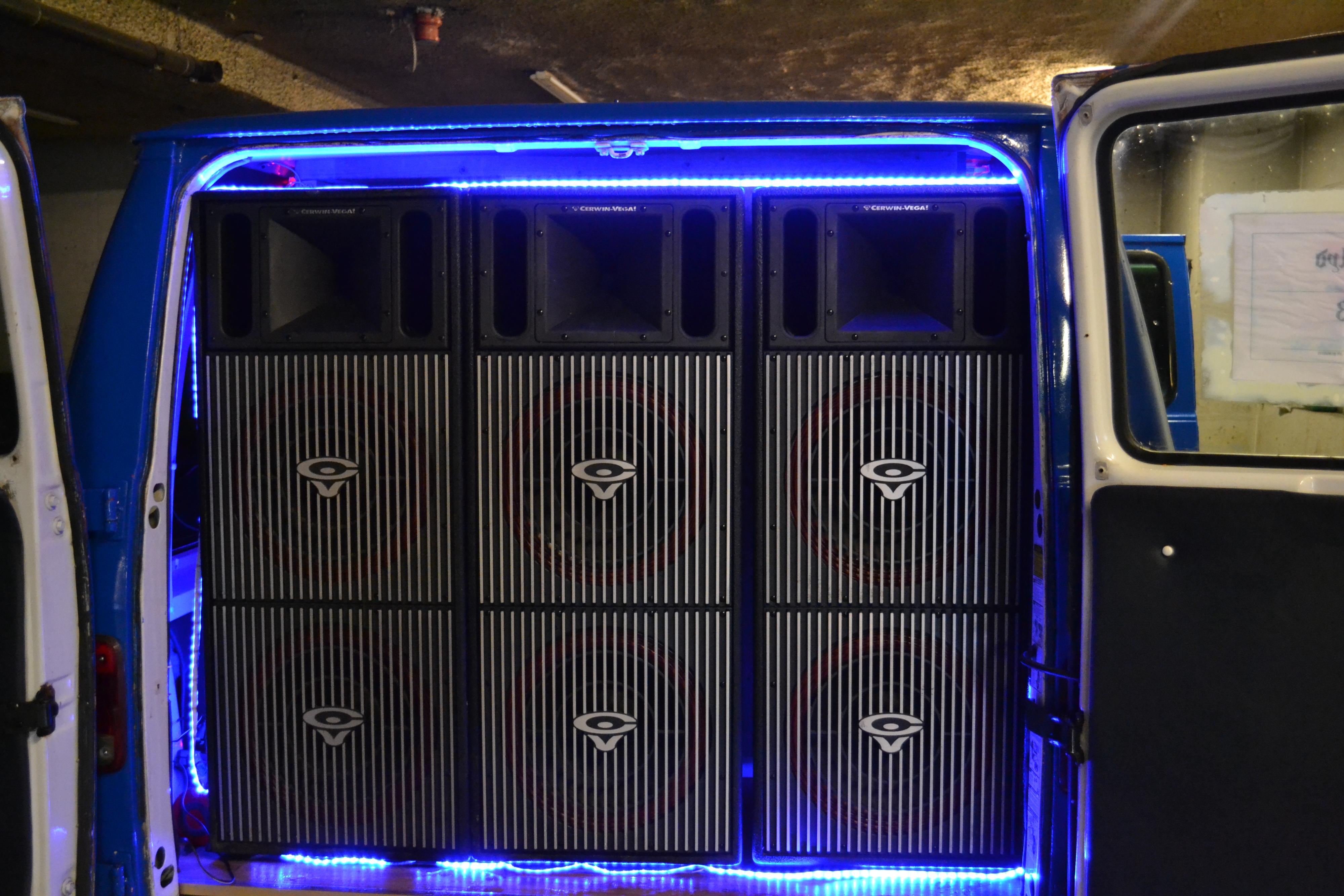

Reason why i got three speakers: http://www.diyaudio.com/forums/attachment.php?attachmentid=394221&stc=1&d=1389921959

Ah, now I can see what the set up is..
has this ever worked?
or is it a new setup you are trying to get to work?
Is the amplifier getting signal?
Unplug the speakers, and push signal into your amplifier as hard as it can go, if all is good here, the clip lights on your amplifier should light (I did say unplug the speakers before this test ;-) )- if not, the fault is either with the amplifier or before it.
Next check your speaker cables - Speakons can have 4 wires and for a single channel from your amplifier we want to use 1+ and 1- so you may want to unscrew the back of the connectors and check that the wires connect to 1+ and 1- at each end. I am also presuming you know that these connectors require a turn after being inserted until they click into place.
now plug in only 1 speaker, and see if that works, try it in both sides of the amplifier and try different speakers one at a time.
tweeters working but very fuzzy could be a dodgy connection somewhere (although I have also heard something similar when two channels of an amplifier where connected to the same speaker).
Let me know what you find....
