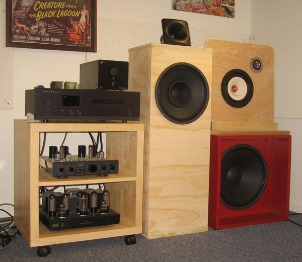

Godzilla, I love those baffles in the second picture. What wood is that and which finish did you use? Sexy!

The whole process dates back to about a year or so ago when I started with a big OB - 2x4 - inspired by NP. I thought the big baffle was sort of in the way of the soundstage. So, using edge I reduced its size.... then reduced its size further and finally its down to this size and shape.
