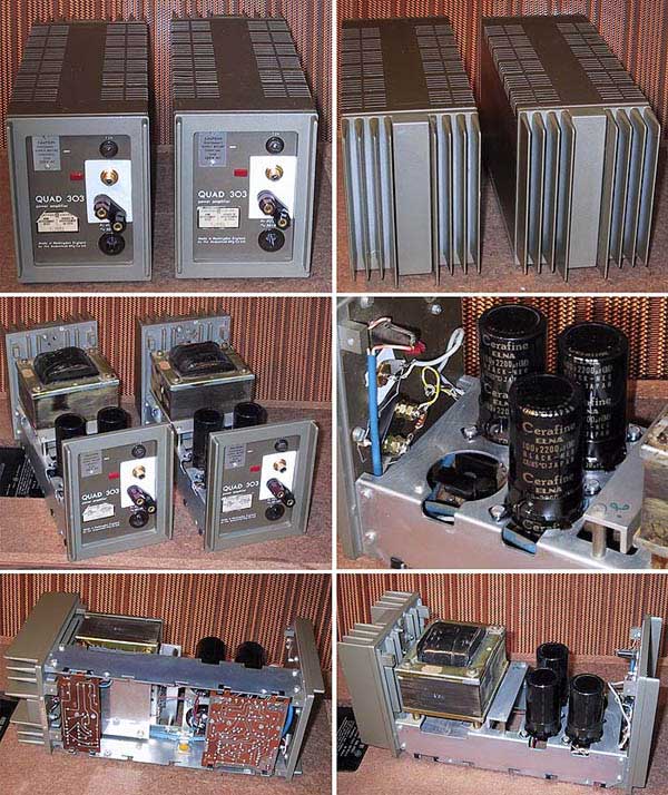

I picked up two Quad 303 amps recently and am considering using them as “monos” into my ESL’57’s. I’m not going to strap them for more power, but thinking of using a single channel per amp. I guess all I would need to do is remove one of the output boards of each amp.
I don’t think anything else would need to be done. Would there?

Why? No need to remove anything. Just don't use one channel. But then why not just use one 303 and sell the other, pocketing the change?
Or else bridge the channels in each, either in series or parallel, so you get more voltage or more current, depending on your needs, out of each one.
That would work, but I'd just short one input and leave the rest of the circuit as-is.
You may want to sell them some day.
Sorry, I missed the ESL-57 part, in which case you must definitely not series-bridge them, as the ESL-57s have an absolute 17V limit that you must not exceed.

I had mentioned that I was not going to strap them, so I’m not sure why you’re warning me not to.
Walker specifically designed that amp to match the ESL requirements, so I'd only use one channel per ESL.

So we’re back to where we started. I may try the one channel thing and see if there’s any perceived difference compared to using just one stereo version.

I would fairly confidently expect not to hear a difference, given the regulator and the very substantial headroom it has to operate in.

ESL-57 wants to use one channel of each 303. Why? These have regulated supplies and only driving one or both channels makes ZERO difference. There is no headroom in these amps due to the regulation.
