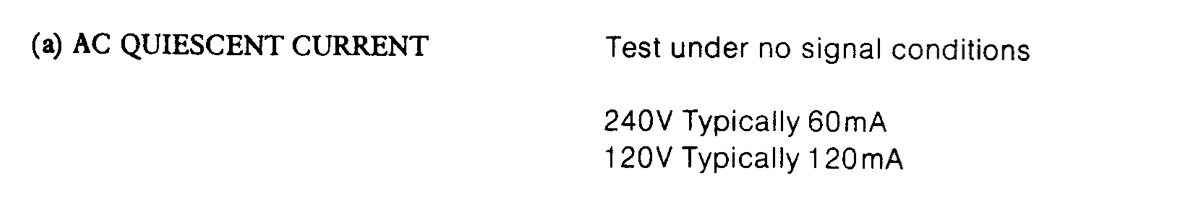

Hi, I own a Quad 606 MK2 and I measured it's power consumption. It seems that when in standby mode, it already uses 55 Watts, and while playing music it uses between 55 and 60 Watts. I didn't expect it to use such a lot of power being idle. Is this normal? I searched the internet but didn't to manage to find information about idle power consumption...
Yes OldDIY is right its a design "feature " of the ( patented ) current dumping design and the ordinary manual also says --"it runs hot " --do not put it near radiators /sunny positions --read up on current dumping.

Hi how did you exactly measure power consumption? If you used one of the cheap(er) kWh Schüko devices of years ago then don't be surprised if results are not reliable....
Some of the older ones are notoriously imprecise. Often just ohmic loads could be measured reliably. Point is that many devices are either slightly capacitive or inductive.
Quad 606 is designed for 120/240V. It also accepts 110/115V and 220/230V. In 1988 Europe was already 230V for a long time. Since it is only going up a 240V capable device is a plus these days 🙂
With care, you can measure the AC voltage and AC current in the primary circuit with a multimeter (do not forget to switch the type of measurement). Multiply voltage (v) by current (a). You get the power VA.

Let's not exaggerate but don't do this when not confident or not having the right stuff to measure safely. Simplest is to have a known good kWh/energy meter....

Hi, thanks for your help and suggestions! I will try, with care, to measure current and voltage.
